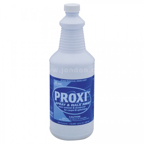

Shawn, I have been told that Proxy from Jondon, and Encap Hydrox, are peroxide with Glacial acidic acid? Maybe I am misinformed about the acidic acid? I always figured the glacial just stabilized the peroxide, I have used both products many times without this occurrence. There is a reason we pre-test, but I'm still stumped why seemingly normal cotton would turn yellow? This also takes several hours to turn yellow.

Well, I don't think the problem is Ph too low. Proxi lists Ph as 7.75 to 8.15 so it's slightly basic, not acidic. Also no mention of glacial acetic acid on the SDS.

Shawn Forsythe
Chet,
Thanks for the product clarification. You should probably contact Rochester Midland (manufacturer of Proxi) to see if they have any guidance.

Larry, we never make our own products. We use off the shelf products. When I spoke to you several weeks ago, you mentioned that Releasit Hydrox was Peroxide with glacial acidic acid. That is what it is, isn't it?
