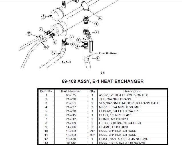

Looks like there is a valve right before E1 exchanger that shuts off flow from the radiator. Assuming its just a loop AND it isn't necessary to provide extra engine cooling while not moving you should be able to just close it.
edit:
page 49
http://www.barker-hammer.com/items/Manuals/BlueLine/VORTEX-7000-Manual-Truckmount.pdf
No dont do this as you will rupture seals in Viking pump. And that line runs oil not glycol.
You would have to run 2 valves inline with a bridge to redirect the water back to return line. Like an h line.

That line doesn't run oil but it does not have a return line that I know of.
More for filling and burping glycol out of system
That valance easily looks like the valve on the e2 and can easily be confused rupturing the Viking pump.
I will have to check to see if I even have that Valve on my 7000hat as I have looked behind the water tank.
Just never a good idea to close the radiator lines as the water tank is such a great heat sink for the truck and ONE OF THE BIGGEST ADVANTAGES AND OVERALL REASONS THE TRUCKS RUN SO LONG ESPECIALLY WHILE NOT DRIVING DOWN THE ROAD.
Tank heat should never rise above 165-175 if it does you have other issues.

=does not have a return line that I know of.
goes through water tank coil and then through e1 or reverse...complete circuit
but like you said I wouldn't give up the additional cooling
