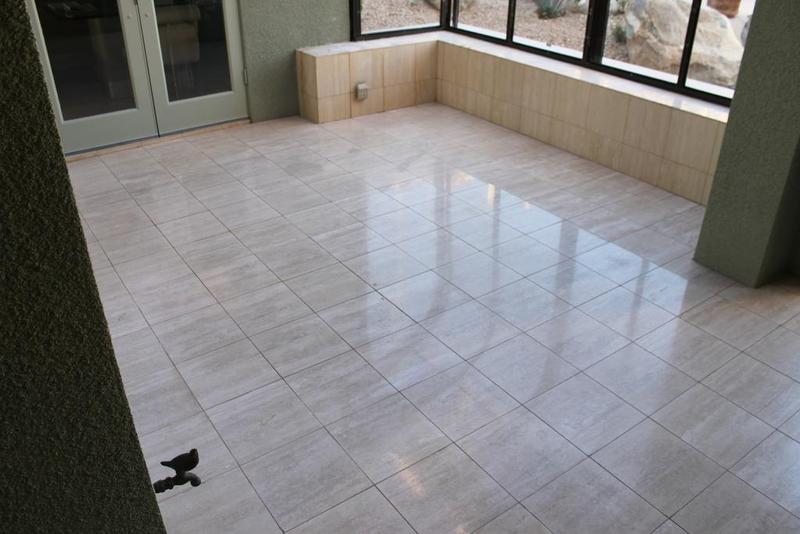

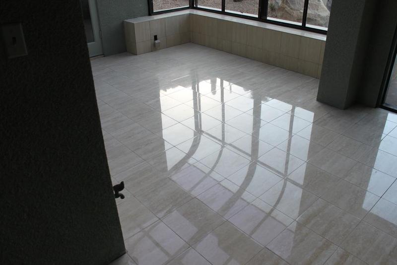

I would use thin resin diamonds with foam risers. The risers will flex and allow you to get in the low areas of the picture framing. When you polish, it should blend in
These are the Ultraflex
http://www.easystonecare.com/Marble-Refinishing-Diamonds-p/uf.htm
These are the risers
http://www.easystonecare.com/Diamond-Riser-Pads-p/riser-3.htm
Here is a before and after of a floor with bad lippage. You can see the reflection jump, but it has a consistent polish.
