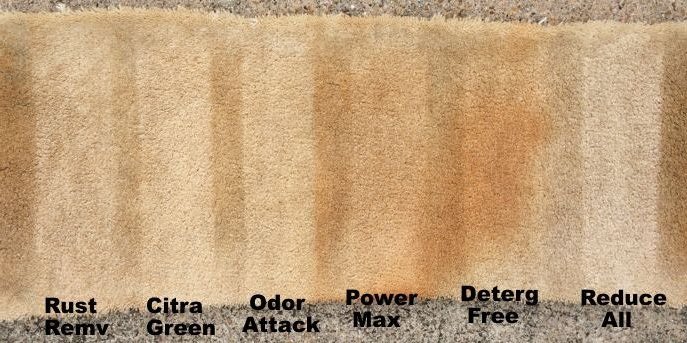

Dynachem initiated some testing on the effectiveness of Red Soil removal from a white nylon carpet. Nylon was chosen since it will be tinted by the red color components. First we obtained the used carpet and Red soil:
The carpet was covered with red soil pictured and ground into the carpet with twisting footsteps.
Then it was left in the sun for a couple of weeks.
Now it was ready for testing. We chose 3 Presprays and 3 Spotters to test with, and applied them to bands in the carpet. They were brushed in for uniformity.
The products were allowed 20 minutes to work, and then rinsed thoroughly
with only hot water.
Of the 3 Presprays, CitraGreen liquid showed the best results. Powders: PowerMax was 2nd, & Detergent Free Powder 3rd.
With the Spotting agents, ReduceAll was the lightest, Rust Remover was 2nd, and Odor Attack was 3rd.
The testing showed that Oxidizers were not effective (Odor Attack; Detergent Free Powder).
Prespray without oxidizer performed the best (CitraGreen w/new tech surfactant).
Reducing Spotters also performed very well (ReduceAll & Rust Remover)

I would say that CitraGreen has better soil suspension ability,
in addition to a hi-tech new surfactant system.
ReduceAll requires a pH above 9,
and the absence of any oxidizer which would reduce it's effectiveness.

Based on the testing, the CitraGreen liquid did better than PowerMax on the Red Soil.
So it is the prespray I would go to, for Red Soiling.
Stainresist Powder should fall in between CitraGreen & PowerMax.
The ReduceAll would be a booster for a prespray without an oxidizer & with pH above 9.
