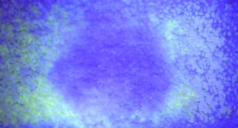

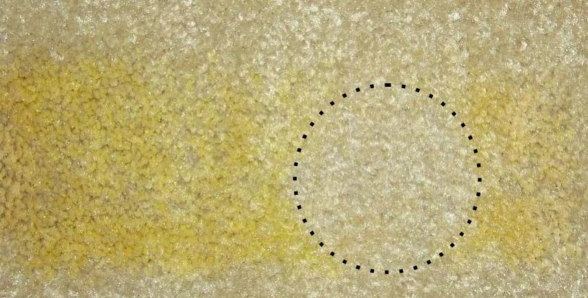

There are some techniques to remove the fluorescence from pet urine & other stains.
These are photos after removal I did with a strong oxidizer combined with our UV light.
In natural light:
In UV illumination:
This stain required DC Brightener + about 5 min of UV light exposure.
I am also testing a new method which uses "hydroxyl ions" generated by an electrolysis process,
which should allow removal with a 12" carpet cleaning wand.
Two new processes will be demoed @ the ARCS annual convention in San Antonio April 19-20.
P.S. I have some clear hard polystyrene storage drawers that were sprayed with cat urine.
I thought a quick scrubbing with a strong oxidizer would eliminate the fluorescence.
I was quite wrong, and the "greenish-yellow" UV glow remained just as strong.

A untreated pet stain will be more yellowish under UV, a treated stain more whitish.
