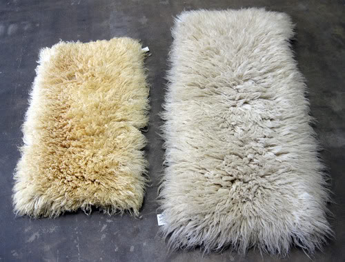

Gotta give pictures on that one! With the Flokatis - here's a shot of an identical pair, with the left one tossed in the washer with detergent, hot water, and in the dryer.
So... be sure to follow Ken's instructions so you don't mess it up like this woman did.

What caused the one on the right to become all stretched out and lose it's color?
Measure the Flokati before you clean it, so you know what size it should be after cleaning. After we wash and fluff you can stretch it out some prior to hanging if you need to.

I didn't mean to scare you - it was just a GREAT example of a homeowner doing the wrong thing in this case... using detergent (not textile shampoo) that was too alkaline (yellowed it), using hot water and hot drier (shrunk it).

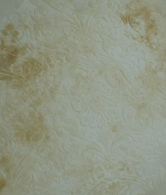

Not to scare anyone, just a warning of what you're getting into:
This is what happens to thin Indian tufted rugs when they get wet. This rug was in a bathroom for several months while it slowly discolored. We cleaned it, got it sparkling and returned it, and four weeks later it looked like this again. since then we've worked on dozens of these that have been used everywhere from hallways to baby's rooms with similar problems and cleaning results, and the bottom line is that there is no fix that will permanently stop this discoloration from reappearing. It's from the adhesive, made worse by the propensity of cotton to wick, plus the short face fiber.
We paid to replace one before we realized the condition was endemic.
The designers that put their names on these have either dropped them or gone out of business, with the notable exception of Martha Stewart.
