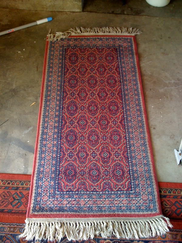

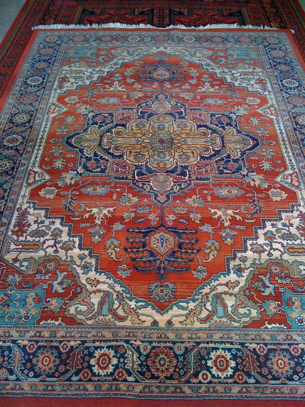

What type of rugs are these and how would you clean them step by step?
Would you vacuum, spray with hose, spray with fine fabric pre-spray, agitate, hose off cleaner, clean fringe, and then squeeze the water out.
Or would you do another process?

They are wool.
Check for color bleeding-if so dye loc
prevac both sides. Wool can hold alot of soil. Rug badger it and you will see.
pretreat
agitate
HWE
Groom
dry
Fringes
prevac
hand clean Fringe with shampoo-bleach if they are bad-only the white ones :wink:
HWE with uph tool
dry-they may brown
Clean both sides, wool absorbs alot of water so dry dry dry.

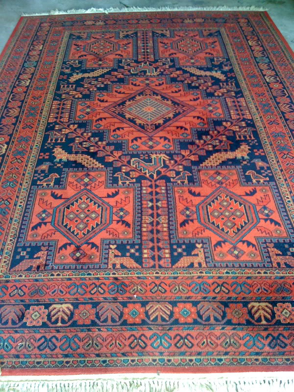

Ben I read on another post you wrote 1 rug is wool and silk. You were asking I believe on the ICS board .Which rug in the pictures contains silk.
May 7, 2008
8,180
PA
I'm Rick James
I am putting my money that the 3rd rug down is the wool/silk. I would say 90% on this BB dont immerse the rugs to clean them. Do the best you can with what you got.
