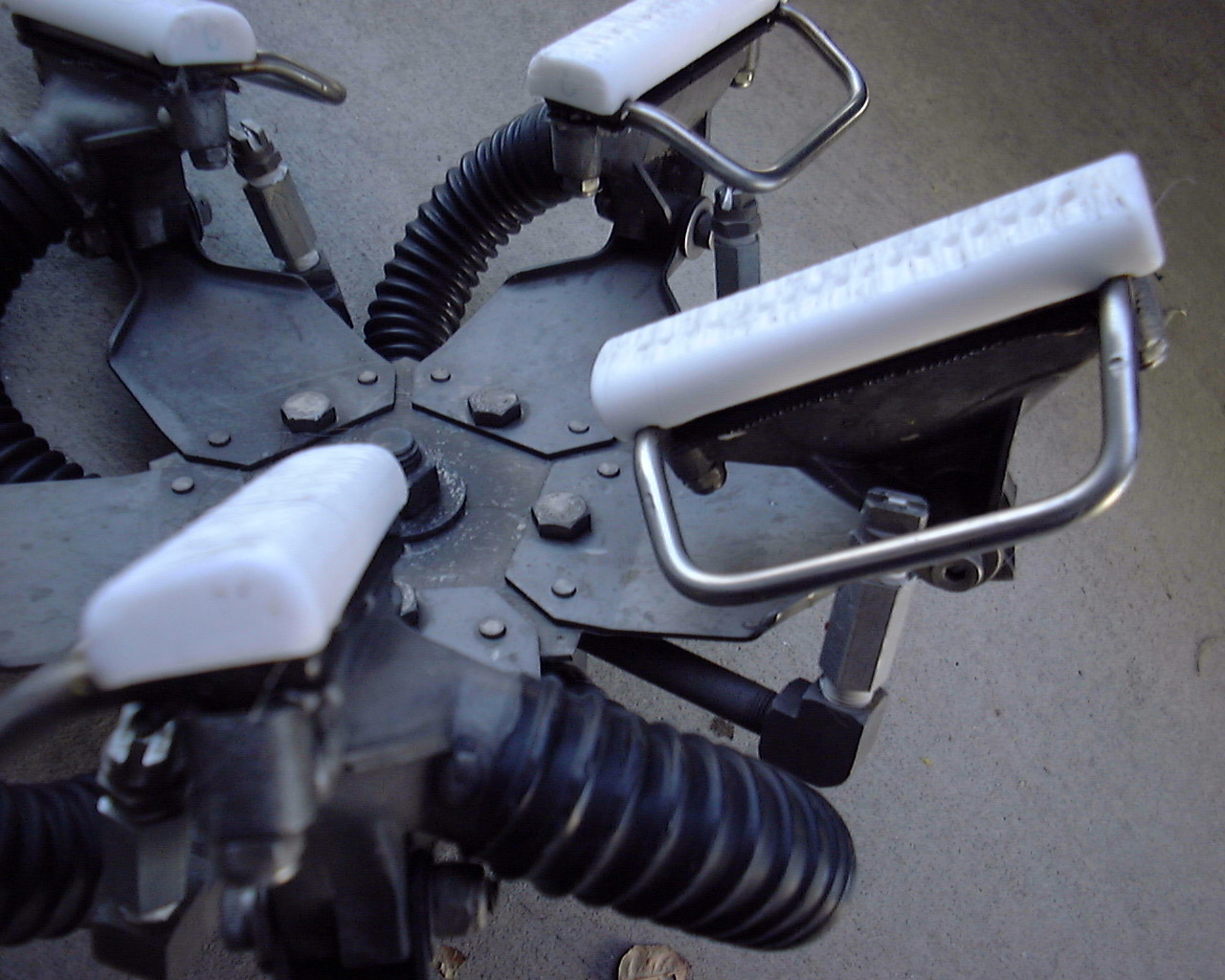

when it comes to the RX-20...the older style head is much better than the newer one...blocking off half the vacuum shoes and taking out 2 of the jets and adding 3 cone jets did not work well.... the cone jets do not give the carpets a good flushing like the regular one will...and blocking the vacuum shoes only choked out the machine ......
best set up I ever found for the RX is 5 ...80015 jets...with the check valve extenders and green glides......
