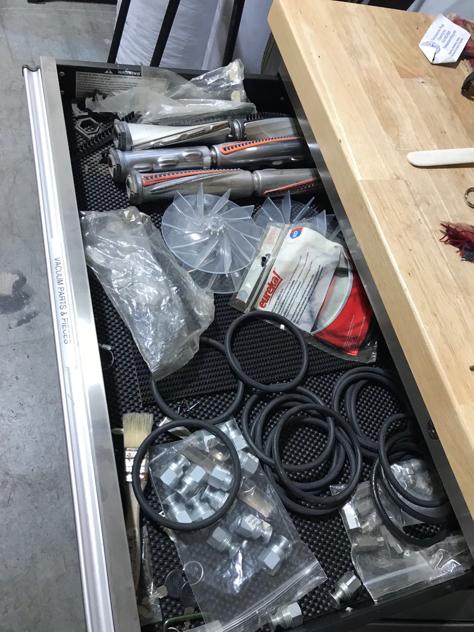

I remember saying on the old ICS board that a strap duster wasn't as good as a vacuum with a beater bar on many types of rugs. I'm sure other uprights work well too.
Oh, The VibraGroomer 1 bar to be all "knuckles" doesn't work well at all
rhyde
Oct 12, 2006
4,253
Portland, Oregon
rhyde
Do your own comparative testing I have all the stuff I'm telling you the standard bar works great
