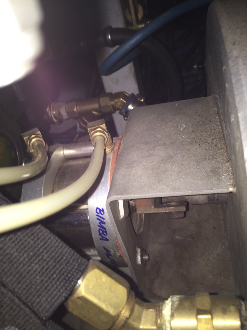

The top picture is a ss570 bimba the 2 hoses on top cause the Piston to go in and out. Mine is currently in the heat position when the U joint is closest to the water box it's off and doesn't heat.
Doug said he's able to move the bimba manually but if keeps going to the off position and not heating.
I think it's possible maybe his hose on the bimba got reversed or he has a bad Mac valve.
He could take the hose off the bimba completely and manually divert put it in the position mines in and you will get heat.
To much heat but heat none the less.
11,129
That valve when things are working correctly with the temp switch will go out to heat and when it hits its temp, it goes back in and is automatic and controlled by the temp control and mac valve, the bimba valve has 2 hose which come from the mac valve that operate by vacuum of at least 7 hg.
If you were getting no heat you could pull both hose off the top of the bimba valve easily and manually pull the piston out and the machine would heat constantly.
if the two hoses on the bimba got reversed by accident then the machine would stay in closed mode and not heat because the vacuum hg's that usually open it would be obviously closing it.
I have accidently reversed mine and I know its an easy fix.

Is bimba assembly frozen?
If you disconnect hoses like Sam mentioned does the diverted arm go in and out freely?
If yes has to be a wiring issue or the Mac valve.
Fort Worth , Texas
I don't think it is sapphire fault entirely, as this is why distributors make the big bucks. I will ask where is the distributor and why are they not fixing this ASAP.
Should be a very easy fix as long as the bimba assembly is moving freely and not frozen.
