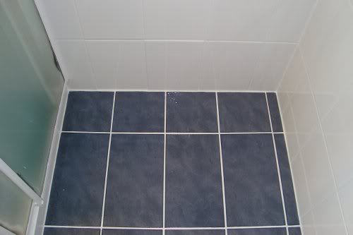

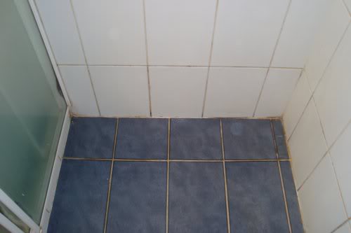

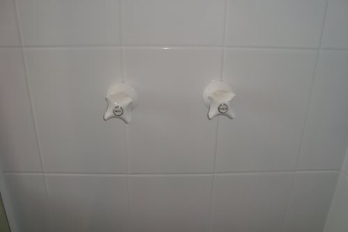

These are great money makers when you are a bit slow.
Before
After
Before
After

Yes I color sealed the floor too not re grouted though I have done over 40 showers so far re grouted than color sealed walls and floors with no call backs but I do not give a warranty in wet areas like I would on a kitchen floor. We also offer shower cleaning and color sealing only if the grout is in good shape.
