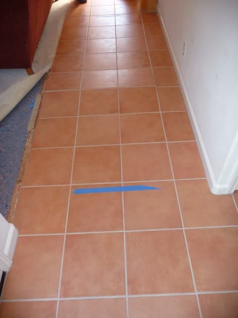

Cleaned this floor with a Turbo 8 days ago.

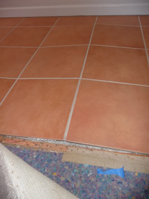

Yesterday afternoon it decided to "tent" five minutes after she walked right over the same area, she claims. 8 feet b the 3.5 walkway area you see all sounded hollow but only the 8 tiles shown lifted.
I went out to inspect it today in the AM and returned in the PM with a tile setter bud of mine. he is going to replace the 8 tiles and use a flexible grout to help it from getting worse. The owner is selling and wants to fix it for le$$.

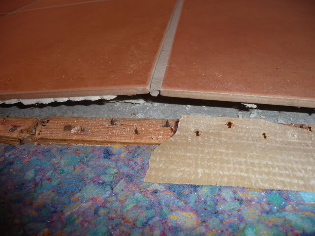

While the humidity and pressure from our cleaning may have lead to this, it was obvious that the problem already existed. When we removed a few tiles not a smidgen of Thinset was stuck to the concrete sub floor.
No clues what so ever that this could have happened.
Let this be a lesson to you guys who charge .30 a foot to clean tile.
You better be able to get your butt out of stuff like this once in a while.

From the lack of thinset it's pretty obvious the installation was faulty. Are you footing the bill for the repair? Timely topic for me, I just finished installing the tile in my hallway a couple days ago.

Mike, what kind of chems are you using??? Thats 2 in as many months that have buckled after you clean them.... try checking your dillution ratio. :roll: :roll: :roll: :roll:
Seriously, that sux. did they sound hollow when doing the inspection?
112,994
the other job that buckled had not been cleaned yet. I was over 50 feet away for the tented area.
I'm innocent so no$$
I did offer to come back and seal the grout though after its been repaired.

A lot of time guys installing tile won't wet the slab, or tile backer.
Also the wrong trowel size. Or the wrong thin set.
Heck I've seen tile installed over plywood., No tile backer.
Looks like a poor install.
I properly installed floor will require a lot of force to remove it.

When my in-laws first started installing tile they had some come up like that, the cause was bad/cheap thinset. It's a good idea to always use latex modified thinset for all jobs.
But there can be many issues causing tile not to attach to the sub floor. 1 could be some type of sealer on the subfloor. Another could be movement of subfloor. Even with crack suppressant a verticle shift will cause problems. Crack suppressant is for horizontal shifts. Moisture could be a problem. However I'd lean towards cheap thinset and improper trowel notches and coverage of thinset on the tile. There could be intentionally less thinset under the tiles in an attempt to float out a rise in the sub floor. Anyways hollow tiles are a good sign of trouble and it's not a bad idea to test for them by tapping on the tiles. As long as 80% of the tile is not hollow you should be fine. Luckily if that happened to me I'd be able to fix it myself since I've installed tile for a short period before finding out that my knees couldn't take crawling around for a living.
