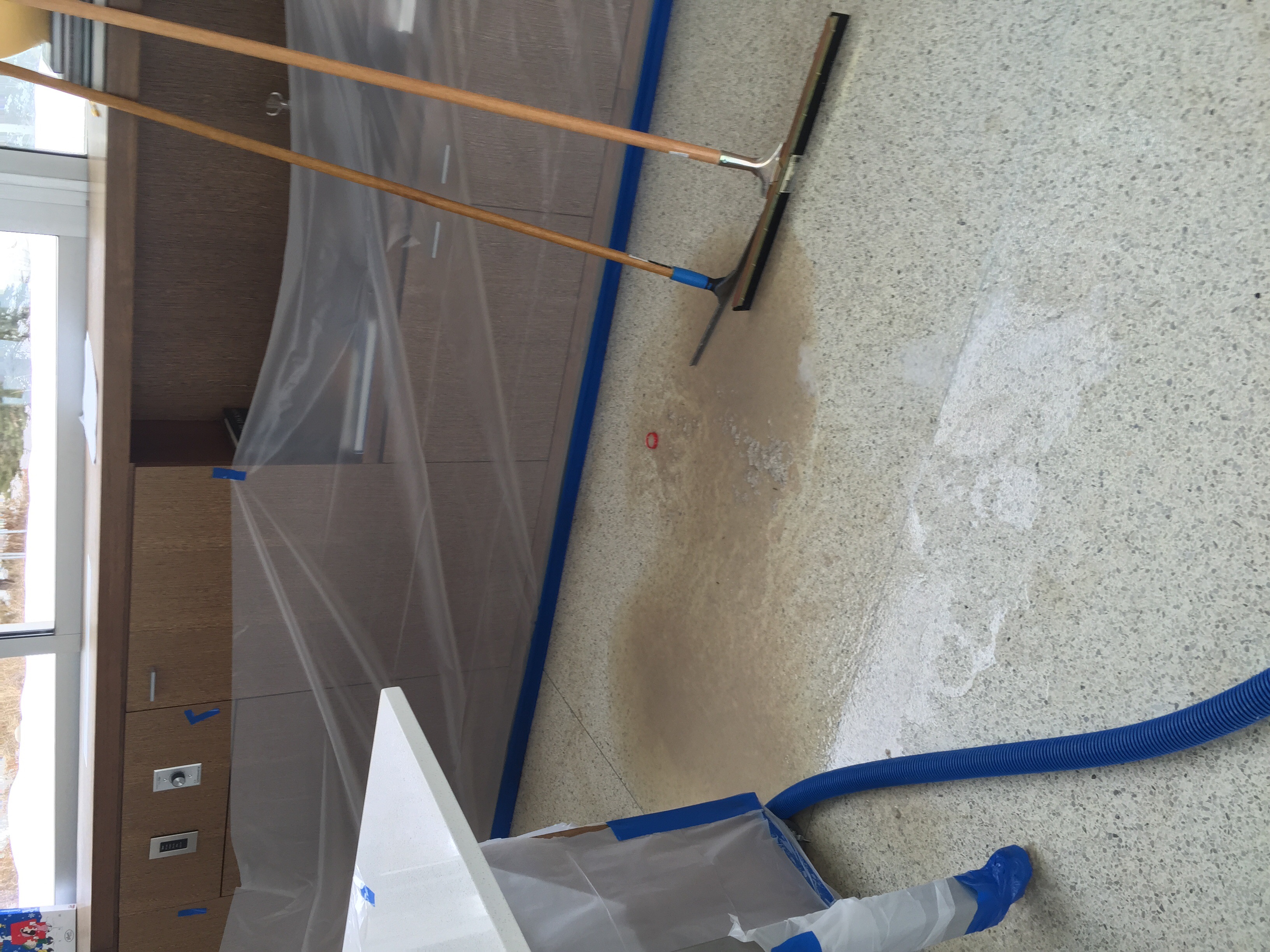

called on to remove soil mixed with several cleaning chemicals; Pine-Sol, mop and glow and certainly several others.
The Terrazzo has some sort of sealer on it. Thinking a polyurethane coating. Floor has yellowed and has layers of wax/soil/sealer combo.
1.emulsifier dwelling on soiled surface.

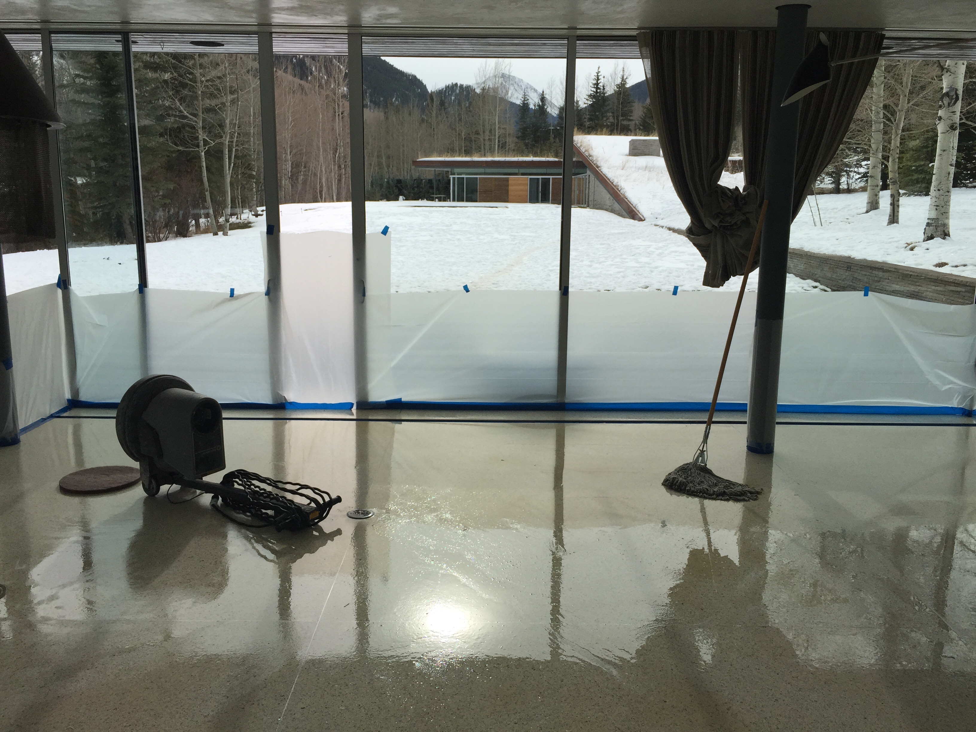

2. Sticky stuff

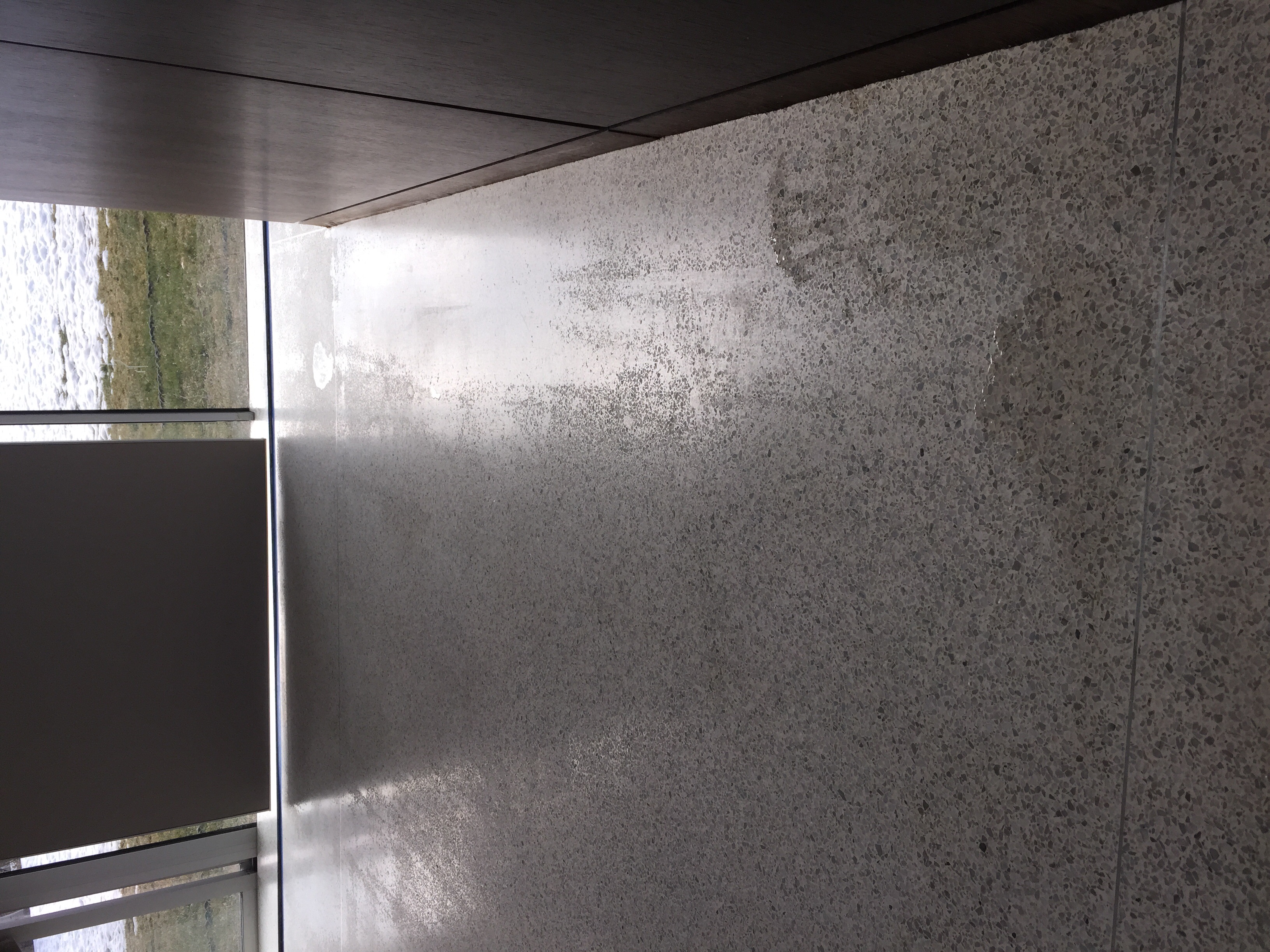

3. 10 of those puddles

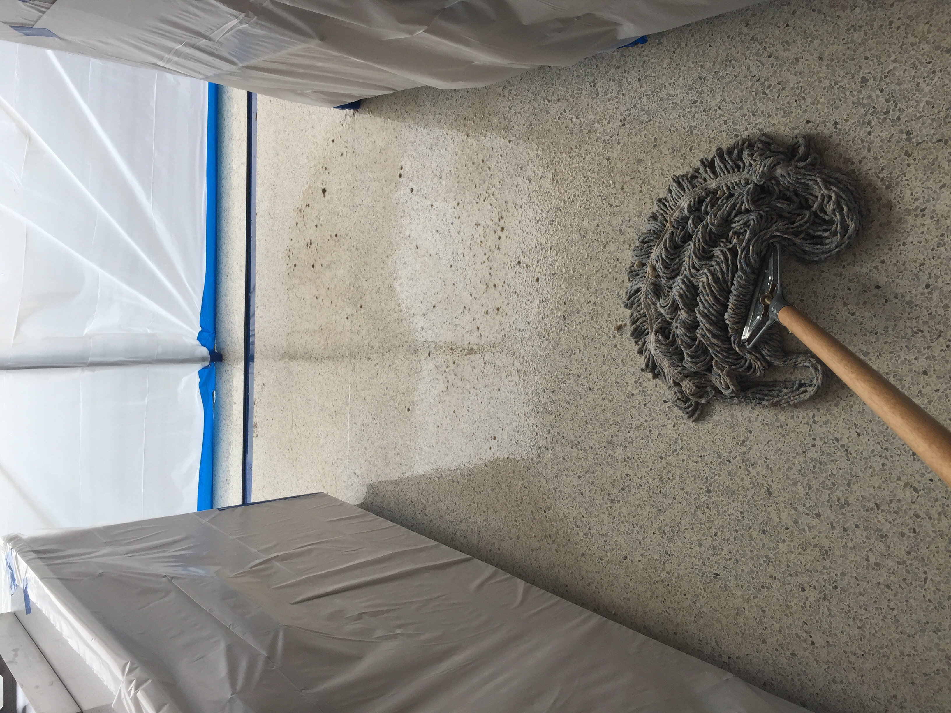

4. Area with counter removed. This area never gets cleaned. It was unaffected by the emulsifier.
