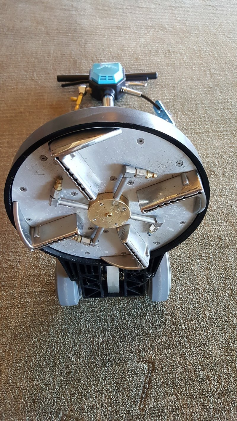

Zipper
While the three of us nerded out, my son plowed through 50% of the job with the 15" Zipper with no fanfair. We had the pre scrub the whole job with a Cimex. If we had the ZSS, I highly doubt that would have been needed.
Cimex.
The King of dirt grinders. Interestingly, I found a full gallon of Hot Knife encap "prespray" that I thought we would try. A multi purpose product. Horrible. No foam or lube involved so the Mex stalled, bucked and kicked non stop. DS2 to the rescue. Foam is king.
Screamer...
