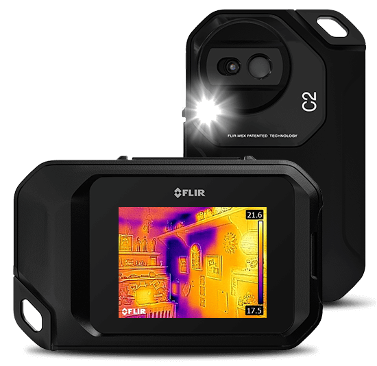

Rich, what do you think of the C2 for casual use? It's pretty lo res though.
http://www.flir.com/instruments/content/?id=66732
I saw that in the Interlink flyer. I don't know much about it but I think its hard to beat the price.
If it will help the technician in the field with his inspection then its a good idea. Great price too.
As far as documenting, the low resolution might be an issue but chances are you'll just need to get closer for shots.
Finding it and drying it are my biggest concerns, documentation secondary.
Reactions: dgardner

Dan that Flir camera will put you light years ahead of what most guys have and use daily.
A thermal camera will just cut down on "hunting" for moisture. It jusy points you in the right direction for invasive or noninvasive meter inspection by cutting your time and have you looking in a specific area instead of have to inspect the entire structure.
You still have to use a meter, or you will eventually get tricked into believing a wall that the a/c vent is hitting actually wet, when in reality it is just cold and not wet.

Richard what do you think about the Flir I Phone camera for basic work?
I also noticed Home Depot Rental has a Flir
Camera for about 45.00 for 4 hour rental.
Fort Worth , Texas
Exactly, any thermal is better than no thermal.
The iPhone thermal for quick hunting or scanning is good "enough"
You can start with a hand held and quickly you will appreciate the larger more capable cameras along with their amenities and strengths.
With our cameras, we don't even have to get more than a foot or so inside a room to get the whole picture.
With a handheld like the iPhone attachment or the new handheld it will just take a few seconds longer and won't be as strong pixel wise/definition.
Like stated above for hunting it would be awsome especially if you don't have one right now to compare it to.
