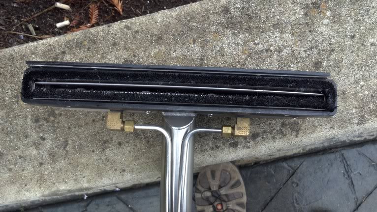

Unfortunately there isn't a tool available for what you want Marty. The Gecko would be ideal but the spray pattern leaves too much on the sides. Either a modified gecko with a few jets to cover the whole width or possibly chop about an inch off each side of the head.
I made my own from pvc fittings. The brush for it is the biggest pita as I have to bend a straight piece. I've yet to find a source for round brush attachments.

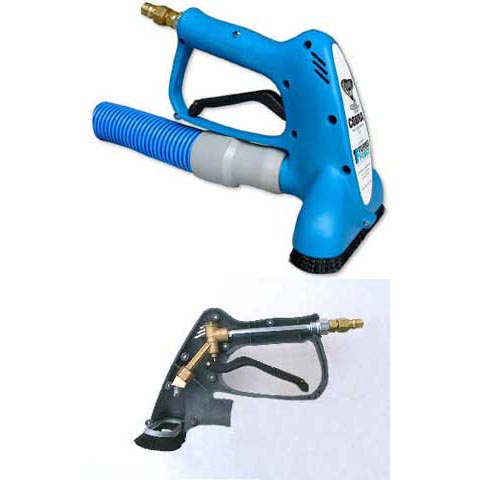

I own the Turbo, hand turbo, cobra, and Gecko with both narrow and wide attachments.....and after 10 years of cleaning tile I use the turbo and literally lift side of it up to get baseboard and edge. If need be in tight areas like the shitter I'll use the cobra. Other than that everything else stays in the truck....for past 6 years or so.

Yes and really all you have to do is scrub with a brush that will get in corners and under the baseboards, and then just tilt the tool and then let the vacuum pull the water back up. For toilets just scrub the area good with grout brush, flood the area with water, and then suck the water up with vac hose. If you want to go all out, wipe the area dry with a towel.

I like the gecko tool with one jet and 5" head.
It works great for running really nasty grout lines too.

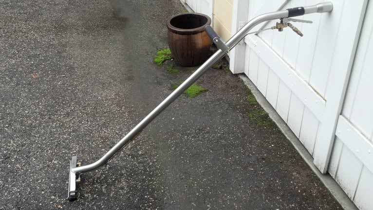

I got the PMF W159OSB. It is perfect for what I want. It is my magic grinder hand tool, except it is made into a full length wand.
Bought it from Joe.
48,070
Prattville, Alabama
They'd have to come down $100 off that price to match the one I got. Seriously! Plus, I was sorta joking about the shipping. UPS is slow this time of year though, but EVERY supplier suffers equally.

That looks like the same wand I use for edging except for the brush attachment, jet and valve. I called pmf sometime ago to see if they sell the brush so that I can adopt it but they said they couldn't.
Let us know how it works.
