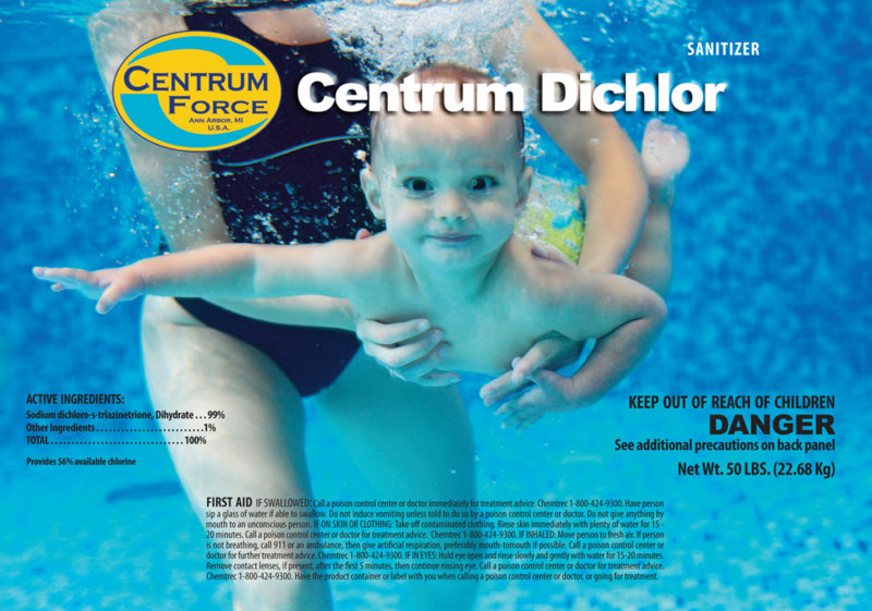

There has been some controversy about this topic in the rug wash forums, private Facebook groups, private conversations among those that belong to various rug groups and associations. There has even been some outright public adversarial marketing against companies that use it in their process by competitors in the same market area.
Many professional rug cleaners in North America, who use large capacity wash tubs, like a Centrum Force paddle wheel device, feel the need to sanitize the wash liquid to prevent cross contamination and to protect their employees.
So what is the consensus now?
Are they reckless with processing rugs?
Let's hear your views. Let me have it! I have thick skin.

Thats really not what was said. From what I saw WoolSafe doesn't necessarily have a position on whether it's safe or not (publicly anyway), however their testing shows that at the dilutions used and the time they are used for in these wash tub scenarios creates negligible damage to the wool.
IMO it makes sense for use in the wash tub, otherwise I have never had a need to use it otherwise, but I'm only a few years into this craft. There will be others @rmann @rhyde that will have much better things to say on the subject I'm sure.

Tom's di-chlor product minimizes any cross-contamination in the wash tub between rugs.
That is a substantial positive for washing rugs together.
At the high dilutions Tom is using, the wool is not damaged,
even thou the di-chlor is an oxidizer.
Dynachem is advocating a "color-brightening" rug wash with reducing agent, dye transfer inhibitor, enzyme, and neutral detergent, where the di-chlor would not be utilized.
The Enzyme would help eliminate microbial odors .

This is what was concluded after the scientific testing done and revealed at Rug Summit 10:
"In our extensive investigations we did not find evidence that the recommended amount of Di-Chlor in the wash tub solution would cause appreciable damage to wool carpet" - Dr. Ágnes Zsednai (Managing Director The WoolSafe Organisation)
This is the device that was analyzed with using a cup or two of Di-Chlor:
