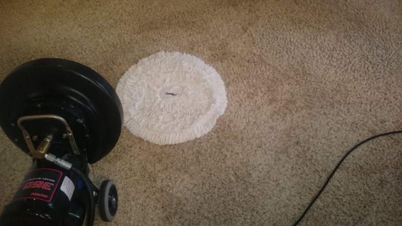

Get a Rotovac 360 to match with that porty and you'll have some power behind it. You may want a pump out so if you go through a lot of water you won't have to worry about dumping so much.
I'd skip the auto fill. Too much jiggling around for a float mechanism it has too much potential for failure.

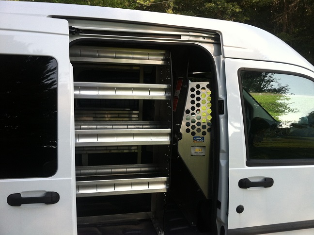

You need a good shelving setup, I took one side of shelving out. I carry an op, dual speed rotary, vacuum, 5 gal elect. sprayer, steamin demon and some small stuff.
I'll get a pic of it loaded later.
