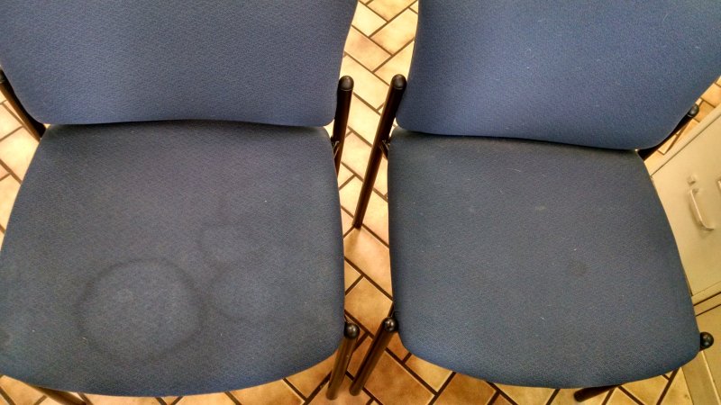

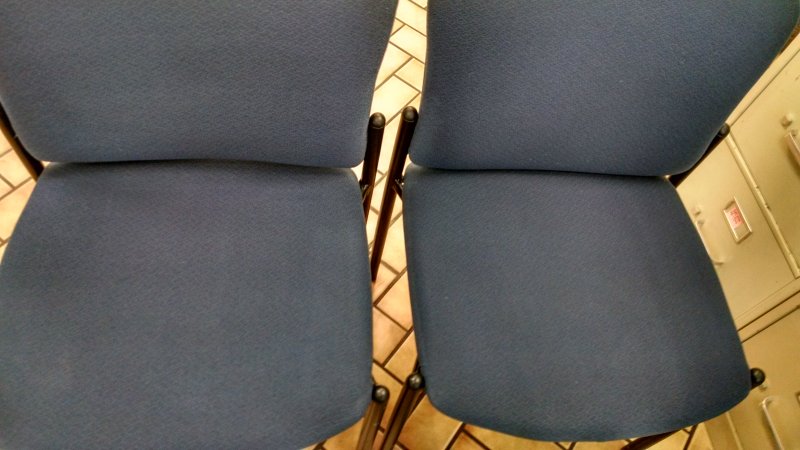

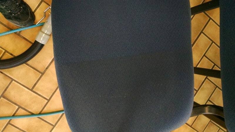

GeeeAus
Sep 23, 2013
1,120
Whyalla
Grant Baverstock
I used my pre-spray on these and then misted over the top with my ammonia and butyl protein spotter. Scrub with horse hair and rinse and they came up well.
