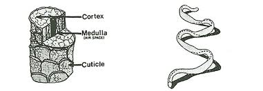

First, what is Wool?
Can we agree as one dictionary put it simply, "The dense, soft, often curly hair forming the coat of sheep and certain other mammals, such as the goat and alpaca, consisting of cylindrical fibers of keratin covered by minute overlapping scales and much valued as a textile fabric."
The medulla is the inner core of the wool fiber. Encasing that is the cortex. This keeps all the fiber together.
The outer layer is the cuticle. It looks like a fish scale.
The only job the cuticle does is protect the fiber. Alkaline pH will cause the scales to open. With the scales open, detergents can enter and flush out the fiber. But if the rug is left in a pH base state, the wool will feel rough and dry because the scales are still open. Once the alkaline has been neutralized, the acid will close the scales, leaving the fibers feeling soft and clean.
