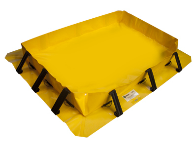

Interesting concept for a break down wash pit for rugs:
http://www.enpac.com/portable-containment/stinger-yellow-jacket-berms/
27,033
Those would work but are a little difficult to get all the water to the sump pump. You will have to manually extract the water before you put it away. You could build a plywood bed underneath with a metal flange under which you could put a bottle jack. Flood the rug, let soak, then jack up slightly so the water runs off to sump pump and even Rinse with hose. For my shop, I need a 16 x 12.

They actually have some different sizes available. There is a 12 x12 that would work for the majority of rugs I get. I wonder if they could custom make me one. I'll have to give them a call.
