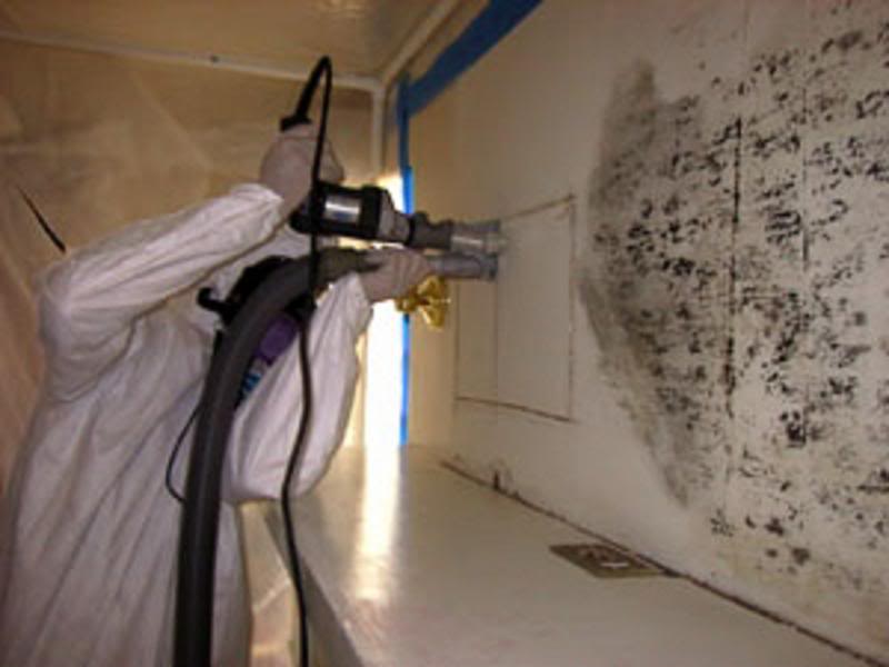

You guys need to get hooked up with Kett Tools and hepa vacs. One of the best tools for us. Very clean for big drywall removal days.
Nov 9, 2008
1,496
George Valliant
I just got back from that storm that hit Boulder Colorado. In addition to a bunch of tools, i had camping gear and 5 days of food and water on the truck.
Like this! We have vacuum assisted Kett saws and 15-HEPA vacuums but all that gear is with our Mold Remediation equipment. We don't use that much on water losses but yes it works great on mold jobs to control dust, and spores.
Back when Mold was Gold we were doing over 1-million just in Mold Remediation.

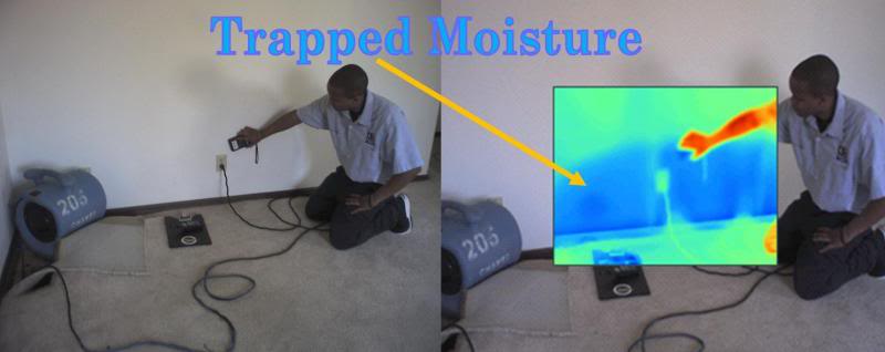

Richard I just did some wet basements in this townhouse complex that I work for and they could never figure out where the water is coming from so they can do repairs so I introduced them to a guy I know that runs a business using a thermo imaging (IR) camera. He charged them $300.00 per unit to scope it. I think this is a great service but I also think he over priced the service and will loose out on 20 such complexes with over 60 units each that are all connected and could all use this service on a regular basis.
That's much more than we would have charged BUT what did he do for it?
If he mapped it all out in his computer showing what was wet in each townhouse, that's added desk time that has to be compensated for. If he just walked through each condo and just showed them what was wet and they took notes he made good money but as you said is very short sighted on a continued relationship.
We would probably charge $75.00 an hour with no report, $150.00 an hour with a report that included images.
For facility managers we have a relationship with we offer the IR Camera service at no charge. 9-10 times it's work for us, dry it or remove it so we'd be fools not to give it away it's our foot in the door. They realize the value and we are frequently called when they have a leak or an odor for investigative work.

He did give them a print out of where the water was coming from.
Then it definitely has more value and he should charge accordingly. Everyone has their own pricing and I'm sure he feels the service is worth the charge but I do believe he is being short sighted. If that were my rate I'd let them know this is the standard rate but because I want your continued business I will give you a 20% discount off my services when paid in 10-days.
