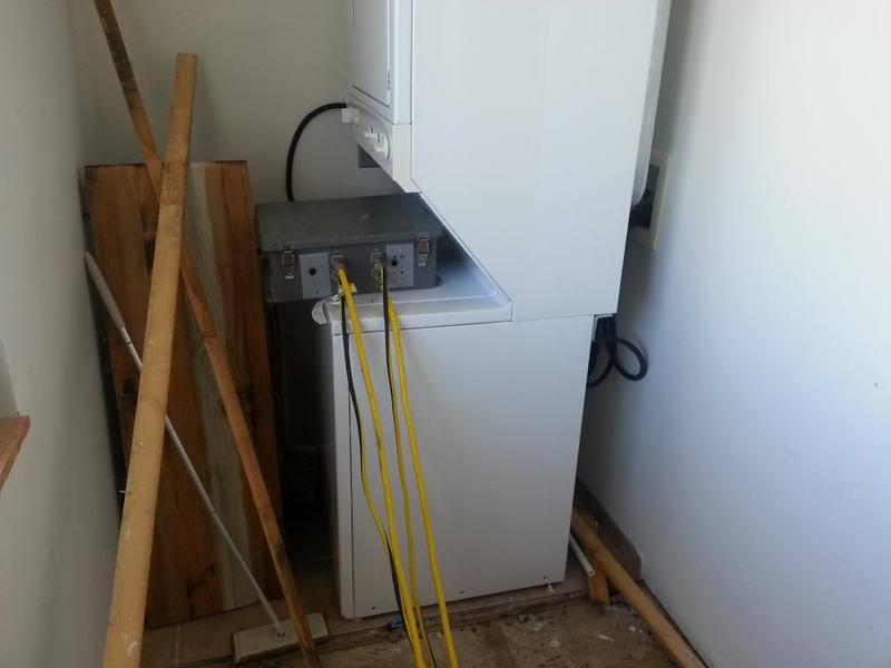

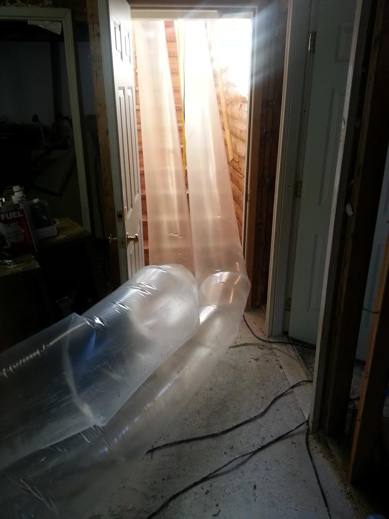

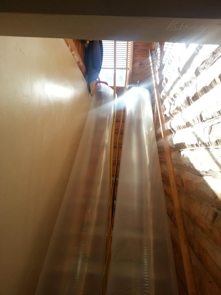

the area where the water is shown coming down is actually the basement garage that frozen door opens to the outside under the main level of the house. The kitchen is right above that area where the water pipe froze. there was insulation, visqueen and drywall in that area. The water they think had been running for 4-5 days. this job was what I call a soaker. the area the 4 wheelers where in was surrounded my unfinished garage/basement area. We stripped the drywall out of all areas down there, removed the work benches and cabinets you see in the background. The biggest problem I had was heat in this area. even all the content items where soaked. if there was a cup, tray, whatever down there it was full of water. The rest of the area down there is about 4 times the area you see in the video so there was more area down there. This place was somewhat limited with heat as it was all electric baseboard heat and our equipment was already maxing out the available juice in the house. after about the 3rd day I had the upstairs mostly dry and decent heat on the main level. so I ended up attaching 2 air movers with about 50 feet each of 14" lay flat duct to pump air into the basement from above.
cobb power box supplying some serious juice!!!!
