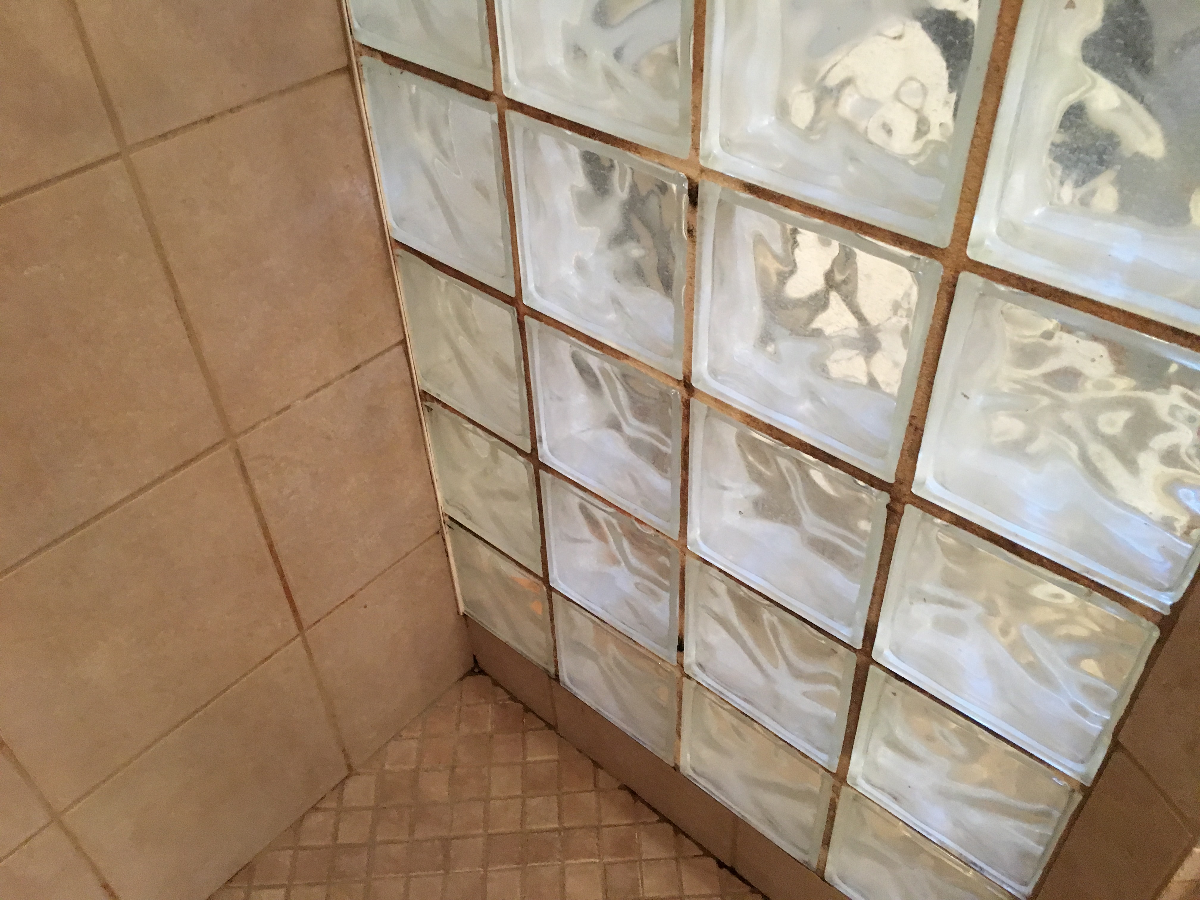

A PTC. Get the one that clings for better dwell time. For glass, may need strong scrubbing with op or rotary. If it a lot hard water, i have been using oneRestore, but you have to check if it is hard water otherwise it wont work. I recently used stone pro scrub..worked great
Bob Pruitt
May 22, 2016
2,677
earth
Robert Pruitt
Sometimes the glass blocks aren't glass. There are plastic glass blocks...for some reason. Quick check before you throw acid on it.

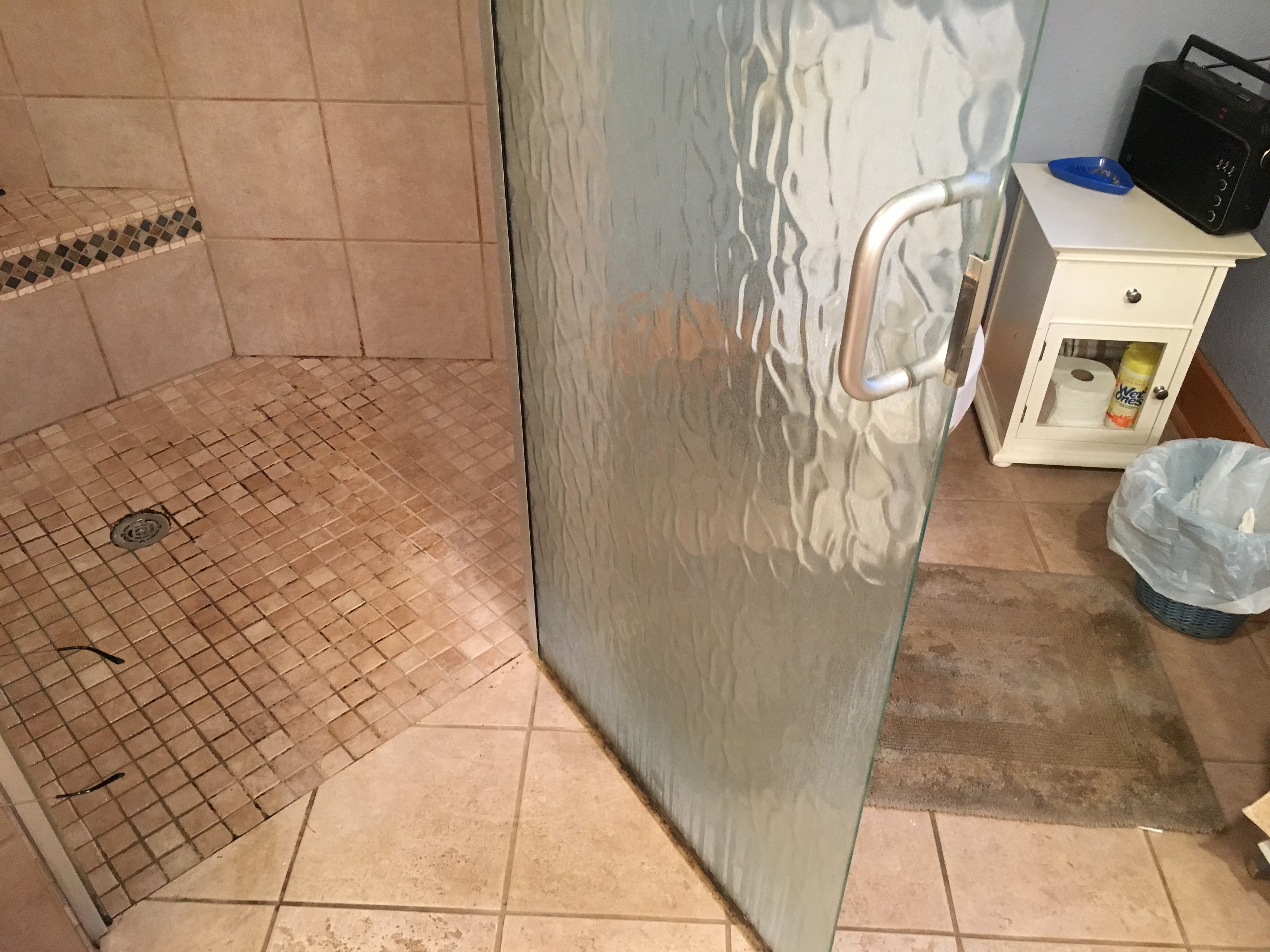

I've just placed the order of the water stain remover and the steel wool. I scheduled this job for the 10th of January, so I'll let you know how it goes. I don't know if you saw that tile also... This tile is 7years old and has never been sealed. So I"m gonna have some major mildew stain problems also
