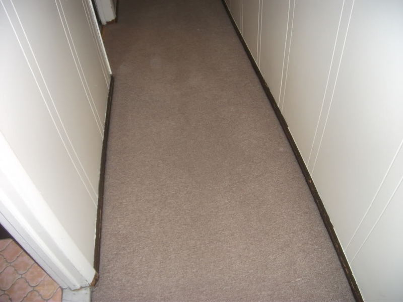

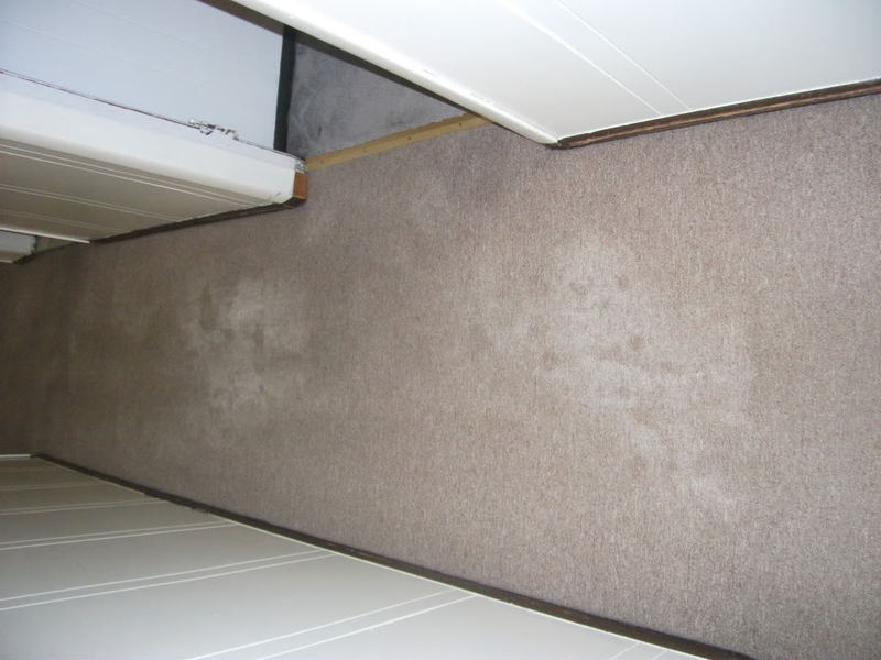

lust1kiddo
Nov 25, 2009
425
Brooklyn, NY
thanks for all the help guys...seriously. here are the pics..
