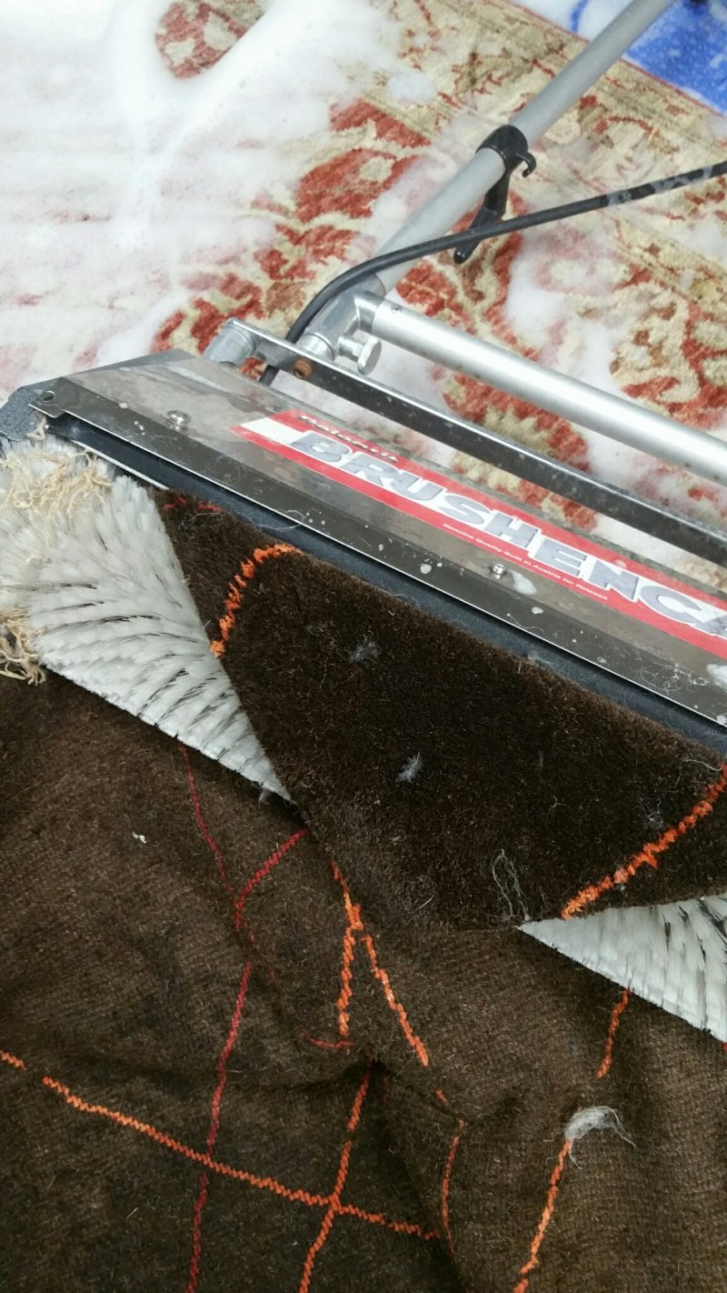

Has anyone Knocked-Off- Ur I mean-- improved the design to includensure a reverse button on this thing?
The rug got stuck in my brushPro and had to take it apart to free the rug.

So what exactly does "take it apart" mean?
Knock the pins out to release the brushes?
No big deal....I do that multiple times a day. (to clean, not to free eaten up rugs)

6,642
San Francisco, CA.
After I took off the top and side cover which may not have been necessary; I cut the strings that were wrapped around the brush and was then able to push the side pins in far enough to "Unlock" the brushes, which enabled me to spin the brushes freely

Is that rug really thin or did you get to close to the edge and go over and it sucked up? Thin thing rugs are almost impossible to clean with CRBs unless you have 2 people.

Use a brush on a pole to hand wash rugs or if you really have to, use a 175 with the proper brush. Any mechanized device with certain rugs can have damaging effects. Get the dry out first, thats the hard part, washing is easy.
Also, if you use a pile lifter, the same situation can happen so use care.
True that!-- I knew that before this rug got stuck-- but had no problem with 2 similar rugs minutes b4 this rug got stuck--I just let my guard down and forgot to be careful.
