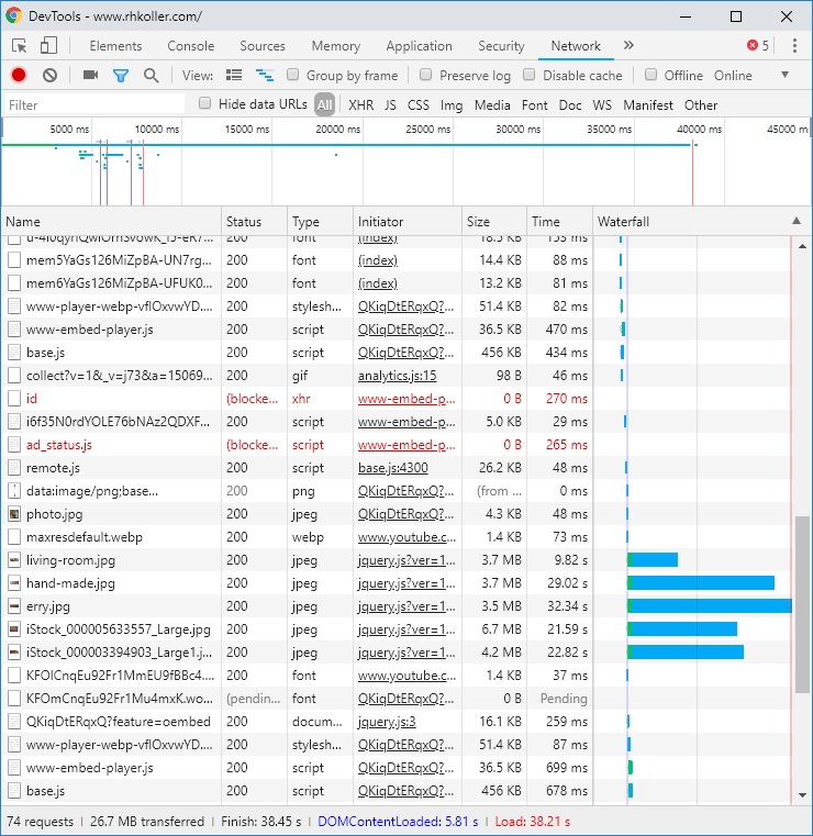

the site in your sig?
Hard to say what it might be without knowing what plugins you are running.
Are you still having the editing issue? Are you using the classic editor plugin? Are all plugins updated?
My suggestion would be to start with disabling all plugins and see if I had the issue without them, Then add them back one by one.
as for the slow loading the slider pics take the longest....they are huge but I don't know why this would just now be an issue unless a now nonworking plugin was compressing/resizing

Looks like he is running divi 3.18 which should be ok with wordpress 5.0+but it is something to check
the new editor sucks but it may not be an "issue" just not understood
classic editor plugin has some issues with other plugins reported (yoast versions for example)so sometimes it is actually the cause of issues.
the page load problems seem to be from the large slider pics
