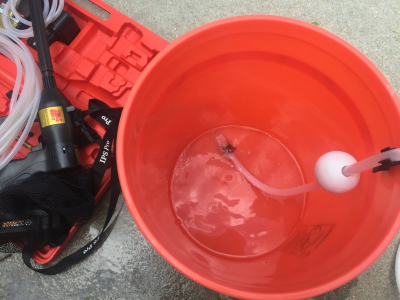

As I wrote before, the Worx was designed for washing and so it has two pressure settings. It also has a pickup filter that needs an inch of fluid to be submerged. So I used the lower setting, to best compare the two. I then prefilled a five gallon bucket to just over the filter, then added one full gallon of water from a jug.
I filled the gallon jug again and put the hoses in each, respectively. I put the larger (blue) tip on the IPS and set the Worx to its widest spray, 40 degrees. I wanted to simulate prespraying carpet.
Squeezing the triggers simultaneously, my helper and I learned that the IPS primes itself (longer tube, smaller diameter) first. When the Worx was primed, We then squeezed both triggers and held them until one had emptied its gallon and hose, to see which was putting out more liquid.
To my surprise, the IPS won. I measured the remaining water and found the Worx had two cups in the bucket (above the filter) and whatever was in the hose.

For grab n go, rugged and foolproof, the Worx is clearly more convenient, but MUST be given a better pickup filter that sucks fluid to the bottom of a bucket. Longer hose would be nice. A short pickup tube can be made if you copy the factory one. Easy fixes.
