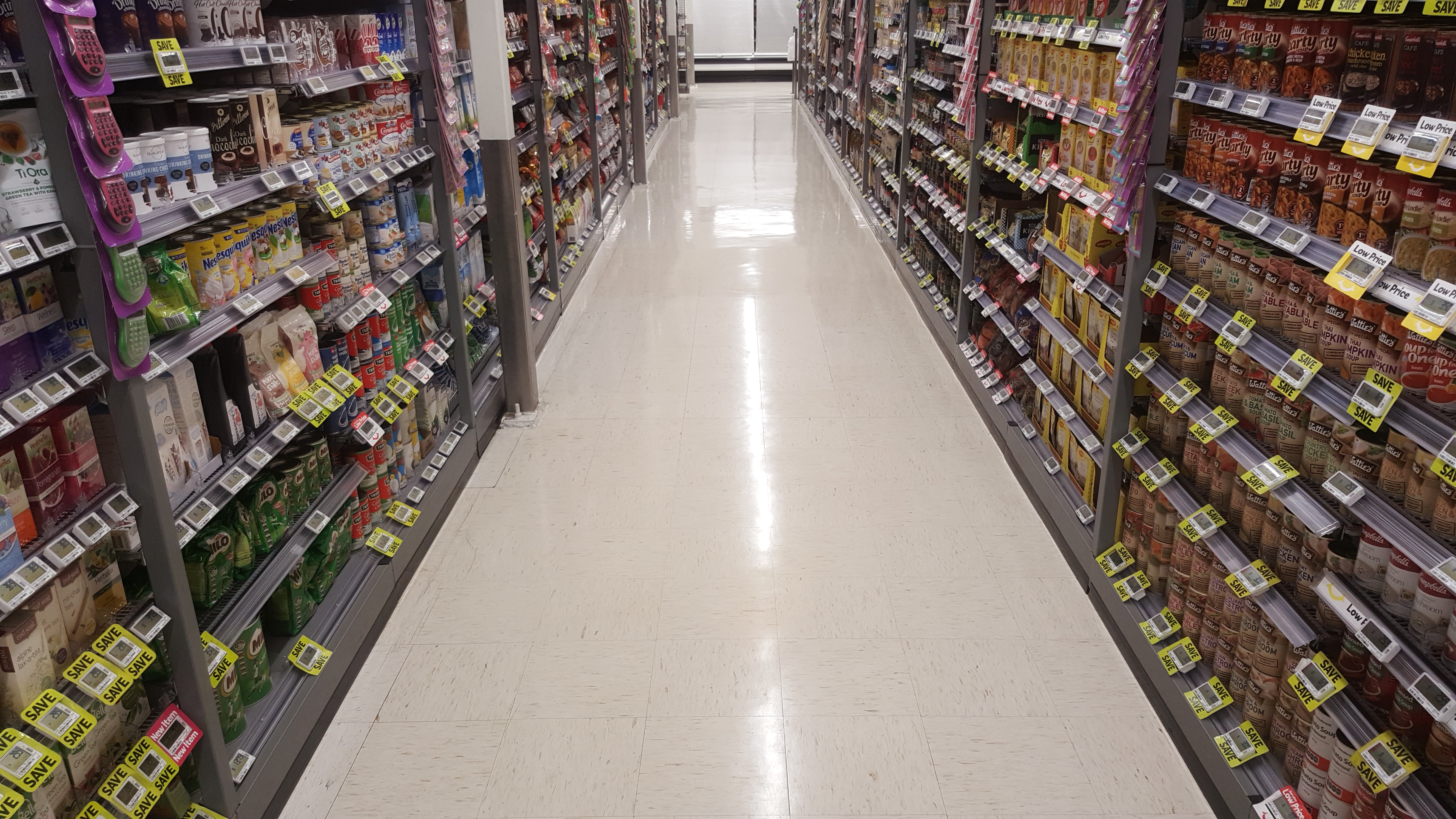

I know the first thing that you guys are thinking is a bad wax. This is a newer kind of VCT that isn't made for wax. It's a satin type of design and it's only made to be cleaned. They told me that they think it's something in the cleaner.
On the chemistry side of this...what would be in the cleaner to cause it to yellow and is it removable?

The dummies are using bleach.
Cheap bleach.
or they are using detergent constantly in the scrubber.
I run a cycle of detergent 1 night then 2 nights just water 20180519_204318.jpg

I dont see yellowing in the picture. If it's in specific places I'd say plasticized migration from rubber mats and such, but if its everywhere then I have no idea.
