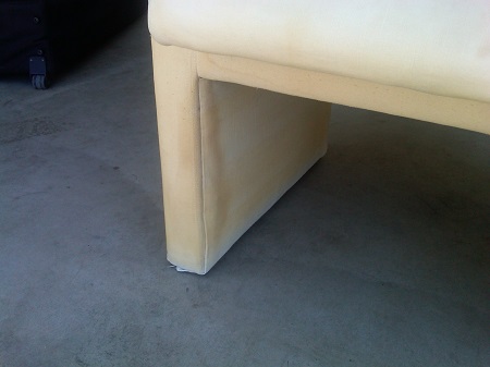

    [​IMG]
    "THIS IS AN EXAMPLE OF CELLULOSE BROWNING"
    3. If the fibers are natural, you should suspect cellulose browning.
    Be certain to discuss previous cleaning and maintenance of the fabric. If another cleaner, or the owner of the fabric caused the browning, you must inform your customer that this yellow condition is evidence of DAMAGE to the fabric, and that you cannot be held responsible for this damage. Even if you can correct the appearance, the physical processes that cause browning also weakens natural fibers.
    4. Establish this understanding (in writing is always best) with your customer.
    You may then attempt to remove the browning using the safest methods possible to prevent further damage to the fabric.

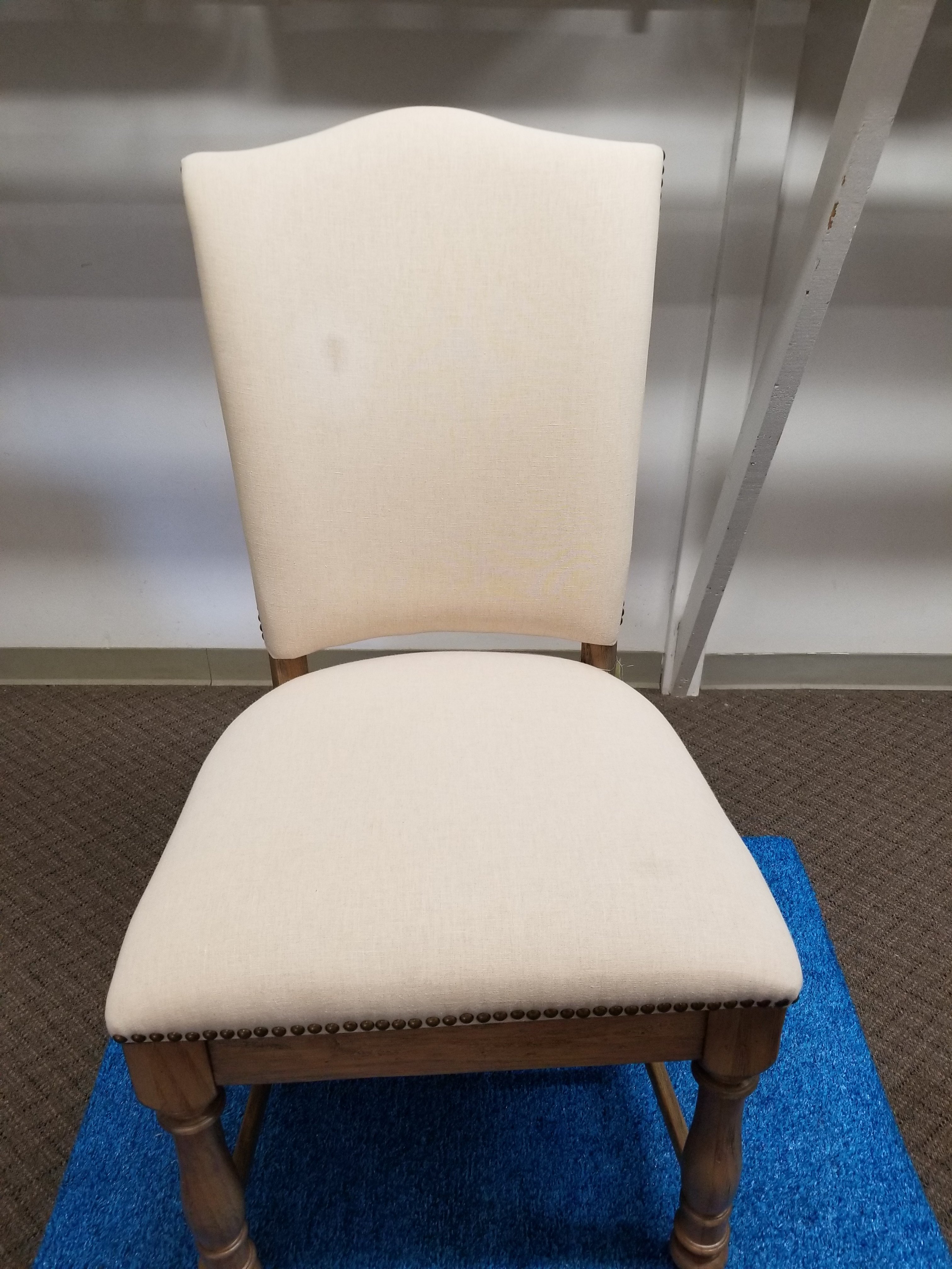

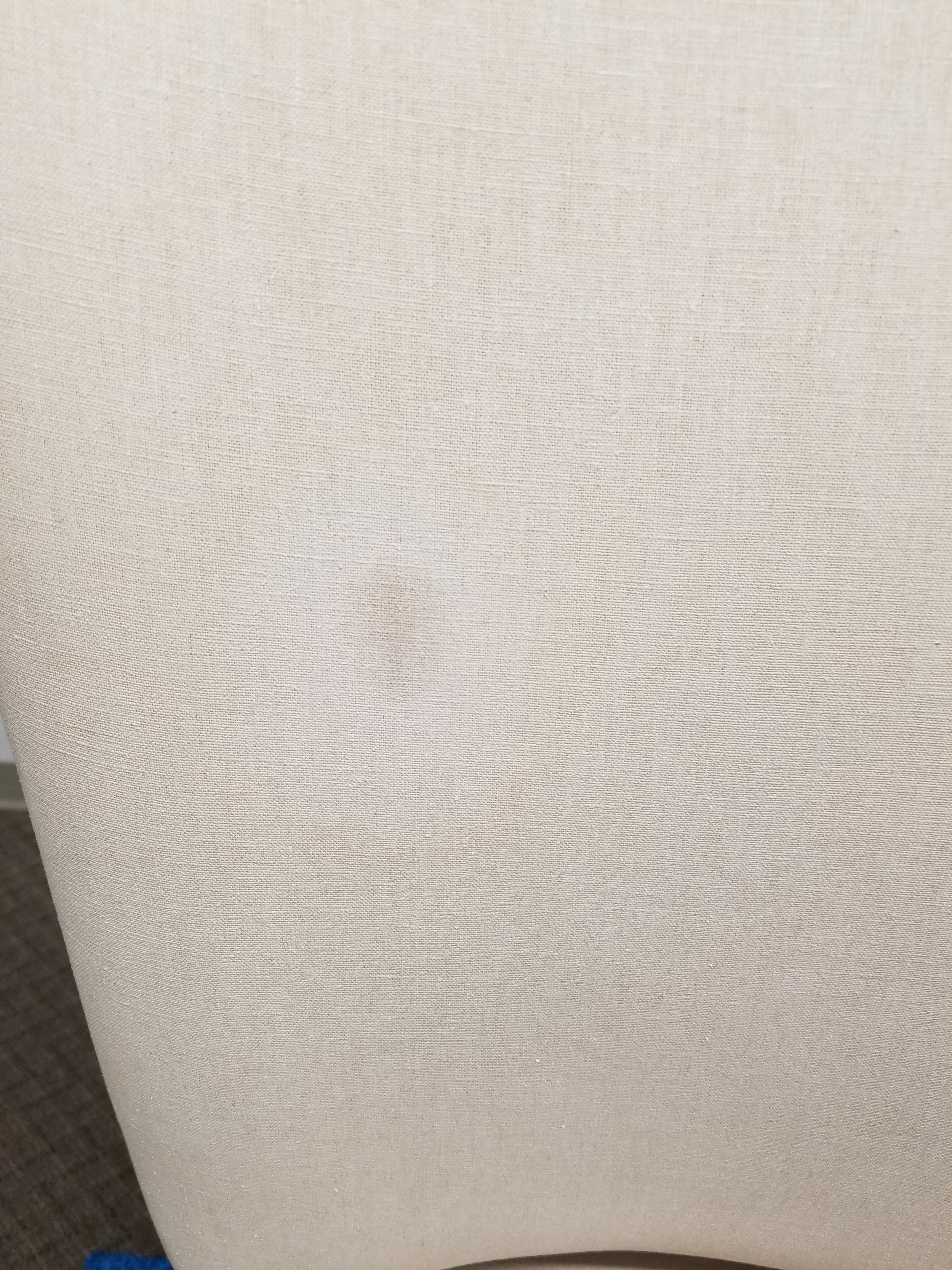

      This chair was brought in last week. A casualty of Thanksgiving???
      It had a large nasty water ring where the homeowner had worked on it and made it far worse. (Wish I would have take a pic) We misted distilled water as you suggest for a first step. It did fantastic! We did it a second time and now there is only a very slight ring left.
      Now for the spot. The homeowner got too aggressive and distorted the texture some and left a halo. We will attempt a neutral cleaner and see how it responds. Unfortunately there was no fabric protection applied and with such fine fabric I'm not very hopeful for removal of the spot.
      It did correct the nasty water stain if nothing else. We shall see where it goes next week.
