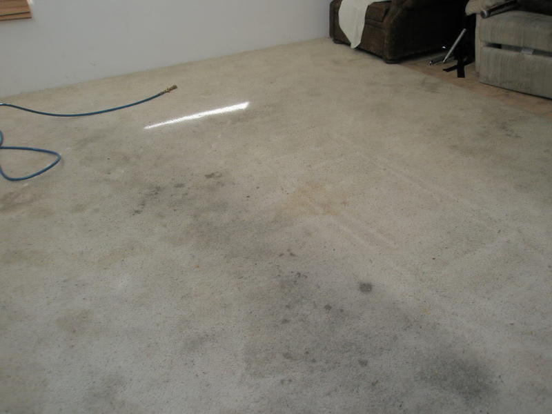

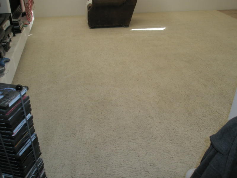

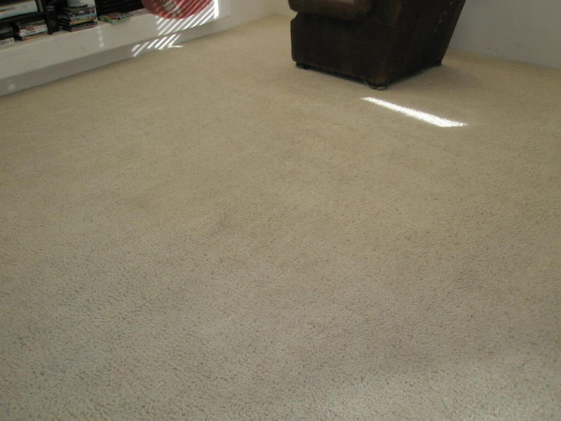

this is a judson job no pre scrub and one pass
before
after
