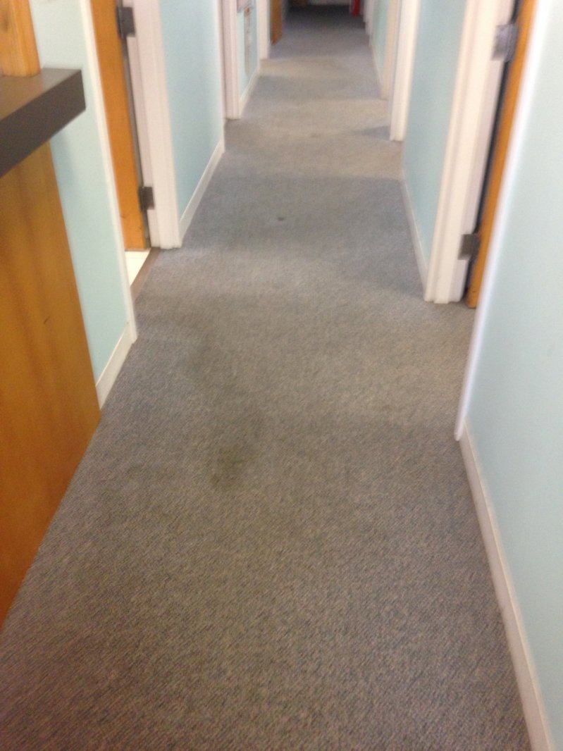

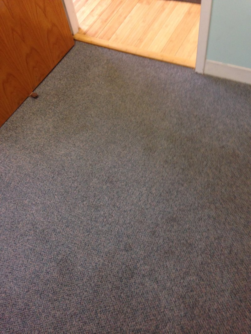

I cleaned an office carpet, and it needed it bad, week and a half later I get the call, we really like the job but we got some spots.
I took photos and it looked great when I left.

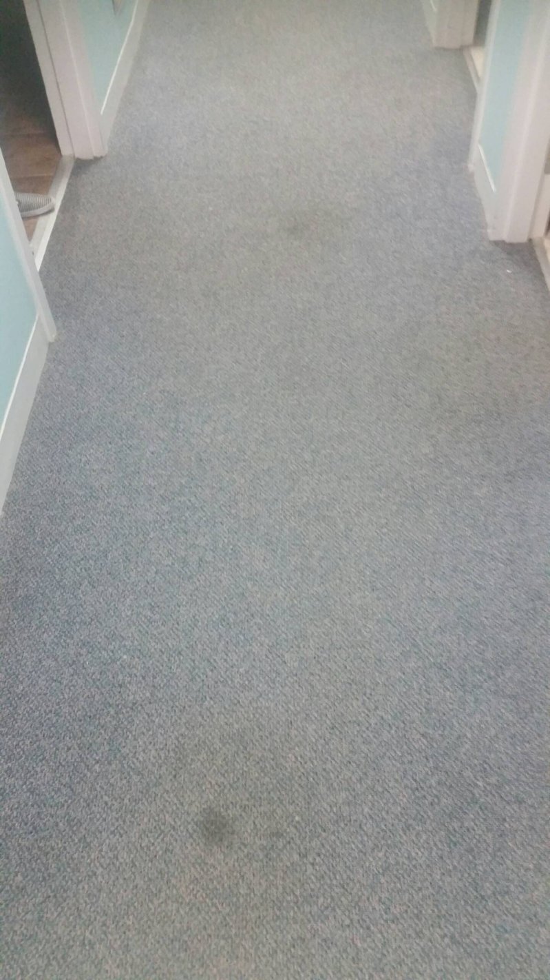

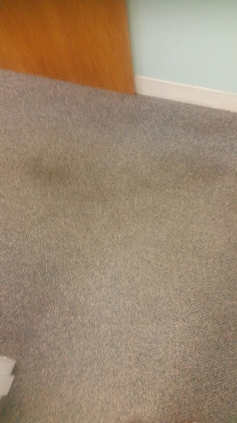

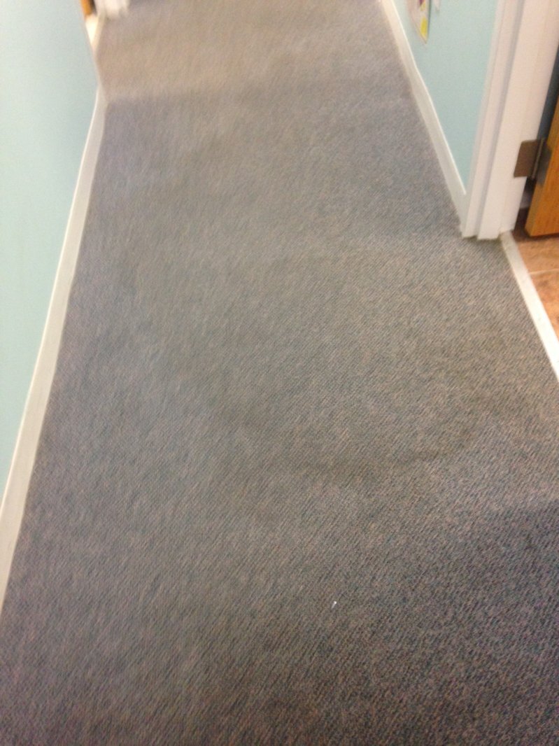

Then I get these photos
Can you come back and do over

Possible wick back from them trying to clean something maybe before you cleaned.....
Or...someone did a new coffee spill...(walk in with some peroxide)
or...you just never know what has been done before you cleaned.....or after....
11,200
There does look to be some soiling there, but the spots look like residue from a spotter that didn't get rinsed out possibly well...now again, could have been from previous, but I would go take a look and do something to fix up I you can....

How do you guys deal with wicking, just have to go back and do over, was it my fault? Did I miss something?
11,200
So what is this with peroxide, pour it on the spot ??
a product such as Bridgepoints StainZone or CTI pro's choice Stain Magic....just mist it on a browning spot such as coffee spill and leave it to do it's work...
11,200
With a walk behind portable, there is a chance the machine hit uneven areas of the floor and was not able to extract properly....
Even a redo could cause a wick back again with same machine, so need to do something to make sure getting good extraction, maybe an acid rinse in the rinse solution, or if had some means of doing a low moisture encap clean there could give good appearance, but there will and can still be soils present to have to contend with the next time you clean again too...
Some stains are easily treatable with just the mist of a high strength peroxide such as listed above....

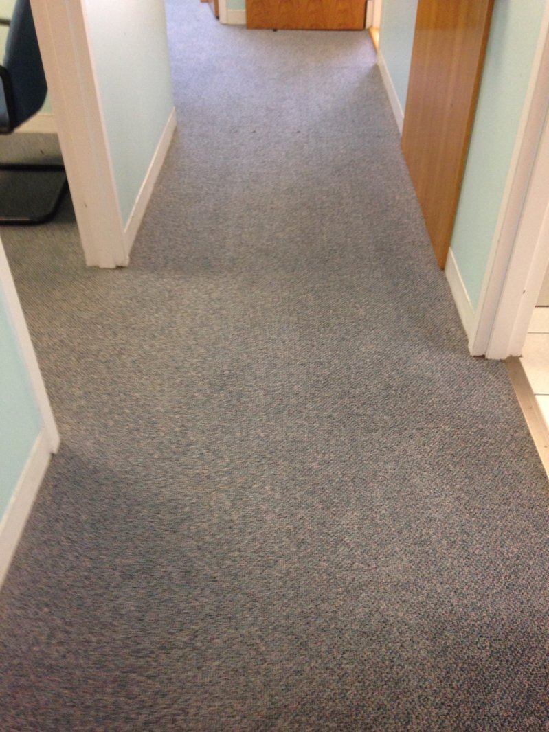

This is pre cleaning

Looks like some water staining in that carpet especially around a few of those doors.
Could be from some type of water overflow...or could be from previous cleaner not able to get suction and extraction....
Just a guess, but in cases of water stains, peroxide can be your friend....
(EDIT: but have to be super careful if this was on natural fiber such as wool)

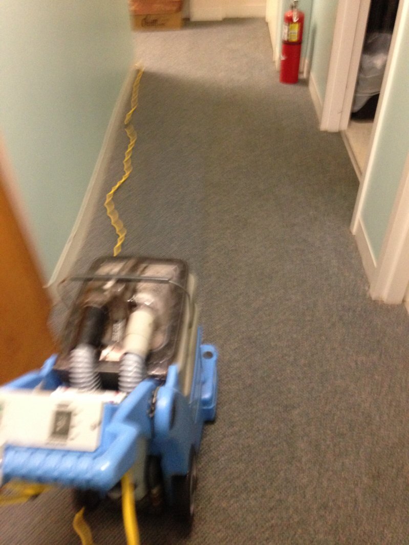

I have the oreck 550
I pre scrubed, but what is post pad?
After I extracted it looked great

Post pad is a Green and White colored Bonnet. You should go over the carpet after you've cleaned it with your machine to extract any more moisture that is left behind.
Some of the bonnet guys on here will give you the best way to use it
116,963

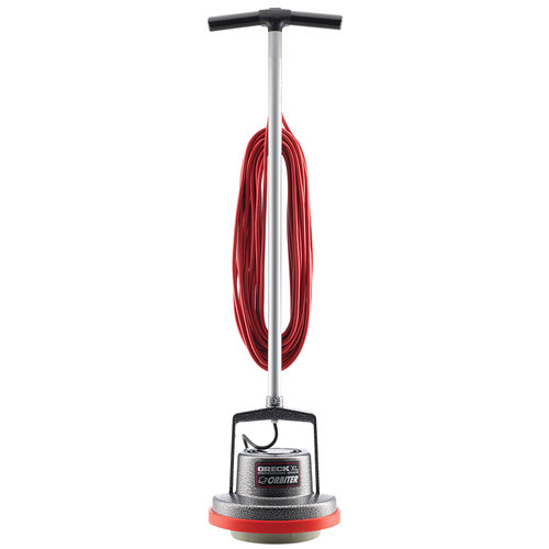

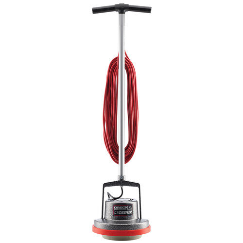

The Oreck is waaaay lacking in ooompf.
Too slow, too small and too lightweight
Ken I hate to say it, but you'll need to get some professional equipment to provide the results your intentions are worthy of
Reactions: Mark Saiger
encapman
2,376
Rick Gelinas
He could actually treat the spill stains with that little Oreck Orbiter using the technique I mentioned above. But I agree with you Mike - that machine is way too small for anything more than very small "detail" type work.
