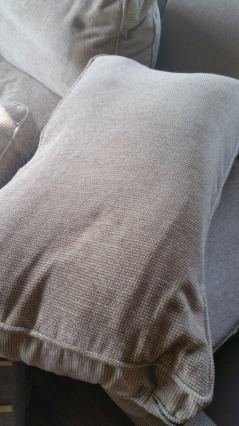

Potential Client sent me a Facebook message and pic of this sectional couch....
Am I missing something here as to it's cleanability with good old HWE style with low moisture tools?
Hopefully you can all see when I post these screen shot pics....
Of course the client is thinking "S" clean only as told by someone....somewhere....
Advice if I am missing something here I am not seeing in the pics, etc....or my brain is out to lunch on Butyl.....

Charge more. Clean normally.
DiHydrogen monoxide is an effective solvent used carefully to clean these "special" fabrics.
Of course they should stay out of the immediate area while you use it.
Please.
Use the same old tool you've been posting about, pretty much non stop, for at least the last six (and who's counting) months :winky:.
Zipety will do just fine on it, with incredible drying time.
Do charge more for the "S" label. It should pay to live dangerously.

Of course the client is all concerned, and I told her, polyester has been a pretty easy material to clean....but I have a few people in this industry I am networked with I will pass it by them in case I am not seeing something :)

Polyester should be as strait forward as can be. Just check the backing and make sure there are no markers that can bleed through.
I know from some manufactures will place a "S" or "D" instead of a "W" clean because they are unsure of the fabric themselves. This way they are safe in the cleaning recommendation.
If you are totally unsure, do a test patch.

here is my concern-- Polyester is handwritten... but just out of view from the photo it looks like it mentions 2 types of leather.?
I think the Tag mentions many different types of cleanings for different types of fabrics -- the tag may be a "shopping list" and then you just have to match the proper cleaning method to the proper fabric..
so investigate more.

The handwritten comment that it's polyester is mostly likely a reference to another tag that identifies the material used UNDER the fabric.
You won't know anything useful about this material until you inspect and test it yourself.

The photo doesn't look polyester, it looks like more of a blend. If its is what I think it is its still wet cleanable. Kind of a herringbone pattern?
I'd probably treat it as a blend just to be safe.

From here it looks like a candidate for dry foam cleaning. It also looks like a pic of new furniture so you have no info about soil, etc found in its current condition.
