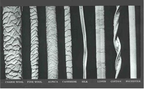

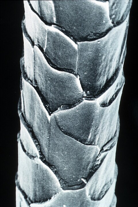

Look it up. The scaly nature of the wool cuticle prevents soil from attaching too deeply. Makes it easier to vacuum.
Think this through with the picture in mind.
How and why would it be easier to get soil off a strand of material that has scales as opposed to a plastic (synthetic) strand that is completely smooth.
I have dusted and pit washed thousands of rugs over 27 years....and I know it is not easier to get soil off protein fibers than synthetic fibers.
View attachment 133630 View attachment 133631
Through all the courses I have taken, I have always been told that wool released it's soil easier than synthetic. That's from certified iicrc instructors.
