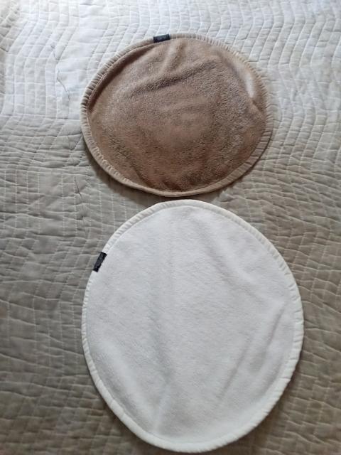

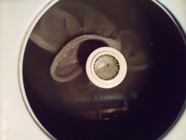

There is my Dirty Water Tank
That dirty water in my washing machine looks just like the dirty water that comes out of a TM dirty water tank
It looks exactly the same as the dirty water that used to come out of my TM
When you put your used bonnets into clean water in your washing machine and the water turns BLACK you know VLM works
I love VLM !!!

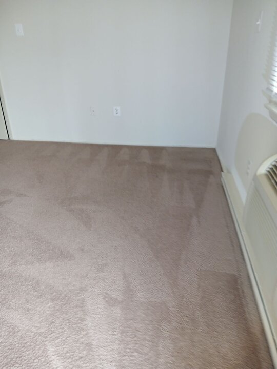

Frank we both use VLM but do everything different
I use a OP CRB and WORX Sprayer and you use a 175 and I think Electric Sprayer but we both get the same results
Cleaner Drier Carpet and Very HAPPY Customers
And HUGE Profits
The KEY to our success is LESS water
You don't need a lot of water to clean carpet
You just need enough water to loosen dirt that's attached to the carpet fiber and keep in suspension until it's absorbed extracted removed
The more water you use the more problems you can have and will have
The Number One question I get is how long will it take for my carpets to dry
MOST customers don't care how you clean their carpet but they DO CARE how long will it take for the carpets to dry
WATER is your FRIEND and your ENEMY
Oxy-Dry uses that quote a lot and it's so TRUE
LESS water MORE agitation !!!

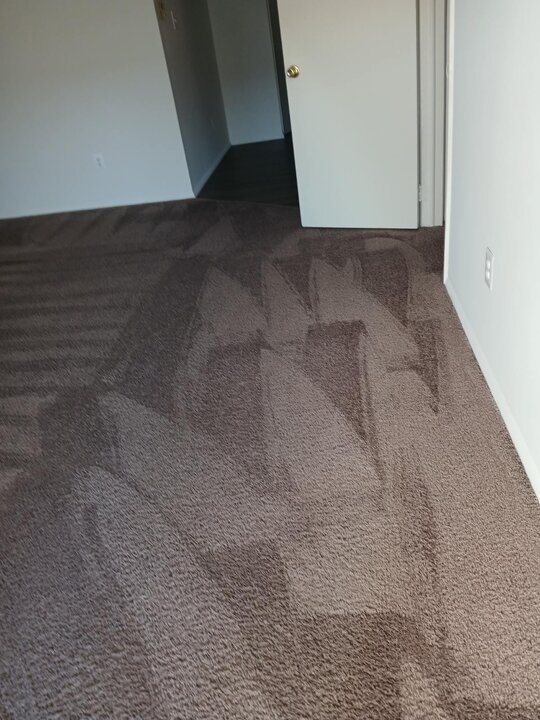

We figured it out. EXACTLY !!!
It takes a while to figure it out
And when you do figure it out WOW
You can't just do one VLM job a month or one every 6 months and figure it out
I didn't figure it out until I switched to 100% VLM
You gotta work at it and learn how to clean carpet all over again
You can't BLAST AWAY using WATER PRESSURE to clean with
I started experimenting with VLM in 2012 because VLM just made sense to me
TOO many problems using a TM and the HWE Method
But for many years I only did 5-10 VLM jobs a year using VLM so I never really figured it out until the 100% switch to VLM
I didn't know you could get the results on Residential I get now and never even dreamed of getting the results and PROFITS I get now
I love VLM !!!

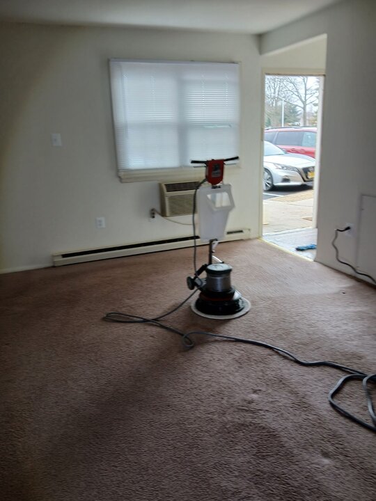

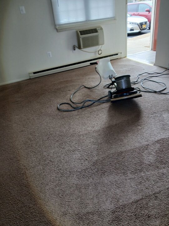

More fun at my Apt Complex today using my 13'' 175-300 Hawk using the tank and Carpet Details
Bonnet Pro's Multi Brush to scrub with fiber pad insert
17'' Driver with 19'' Ironman Bonnet to extract
10'' CRB to groom
The carpet was spotless but it still must be cleaned to pass Township inspection before new tenant moves in
EASY MONEY !!!
Hey Frank have you ever used a 300 ?
Life is BETTER when you're using the VLM Method !!!

Only once on VCT job long time ago never on carpet.
I believe carpet muscle uses it? I could be mistaken?

man, I had a 175/300 power flite , but it was stolen
