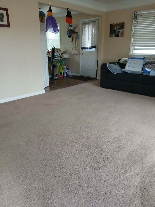

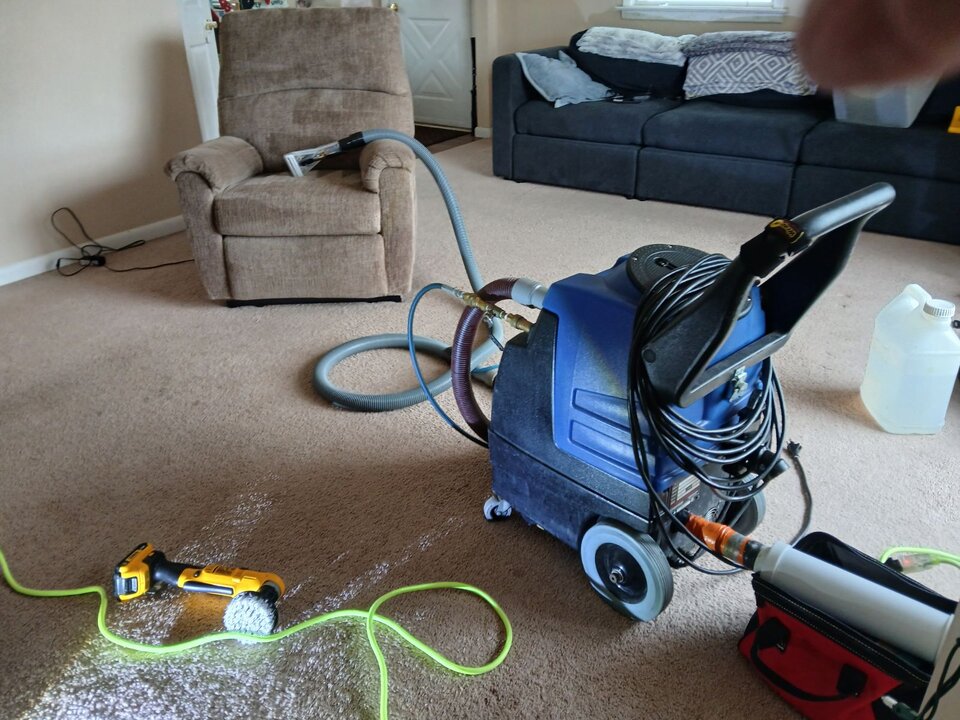

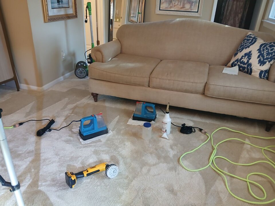

Not gonna start this debate all over again, but if you hwe, you know you didn't have to #flood most carpet to get it clean. Chems and agitation are doing the same thing you're doing following up with an additional step. Some don't do that🤷🏼‍♂️
You should know by now I take a jab at HWE every chance I get :biggrin:
I did this job today. One chair, 2 Bedrooms, Hall, Living Room. I used 3 gallons for all of that. I rinsed the chair with water and that is not included. I haven't been HWE for 6 years now so I don't really remember how many gallons it would take to do that using the HWE Method but I do know it would take many more gallons than 3
How many more gallons 10 ??? 15 ??? I don't know but compared to VLM, HWE uses and WASTES many many more gallons of water
That carpet is a cheap Polyester. I used 2 oz VacAway Double Trouble and 4 oz Detonator (Peroxide) per gallon on chair and carpet
I'm starting to like that Sapphire Portable Upholstery tool. It uses too much water but adding a shut off solves that problem
LESS water MORE agitation !!!

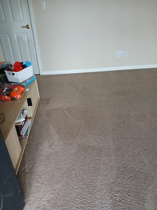

Yes I leave the MESSY Look and I like it
If I thought there was something wrong with the MESSY Look I wouldn't post pictures
I don't worry about perfect groom lines. When the customer starts walking on the carpet those lines will disappear fast. They're not deep lines
I use a 10'' CRB with soft brushes. That carpet is thick nylon and the lines are mostly just on the surface because the CRB is light and has soft brushes. A carpet brush/rake leaves deeper lines than a 10'' CRB with soft brushes. A 10'' CRB grooms the carpet better than a Brush or Rake. My opinion
I never get any negative comments from customers but do get criticism from other cleaners. If I start getting negative comments from customers that's when I will change my opinion on the MESSY Look
I'm more concerned with getting the carpet clean and dry than groom lines
I like the MESSY Look !!!

What’s that tube on the back of that portable? Some exhaust muffler thingy to help catch all the crap air exhaust that comes out of that machine into the customer’s air???
It's a muffler that catches noise
Without the muffler it's loud and very annoying
With the muffler it's probably 50% quieter
When I'm prespraying and scrubbing furniture I have machine off
I only have the machine running when I'm extracting

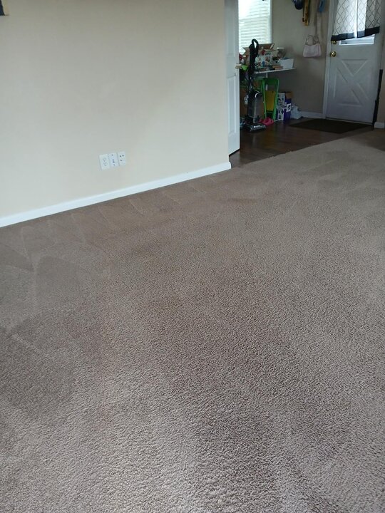

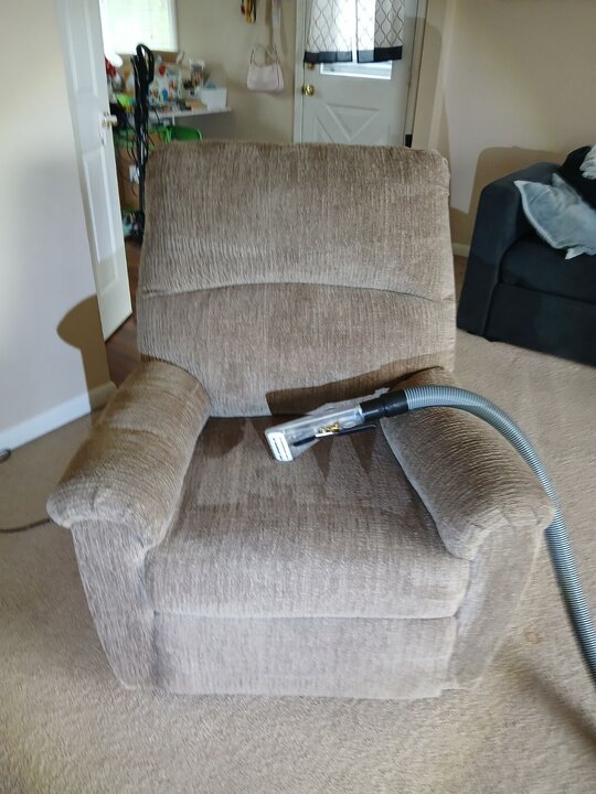

I like that Sapphire Portable Upholstery Tool

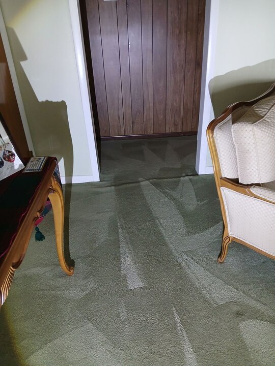

What happens to the dirt left behind ???
No Method removes 100% of the dirt and dirty water
So what happens to what's left behind
VLM uses agitation to clean with and usually dries in 1-2 hours. Dirt gets encapsulated in a detergent and crystallizes after drying and leaves no sticky residue
HWE uses WATER PRESSURE to clean with and uses at least 5 times more water than VLM. HWE usually takes 2-5 hours to dry (if customer is lucky that day) and uses a prespray and detergent
The longer it takes to dry the more dirty water left behind. VERY TRUE !!!
So what happens to all that prespray detergent and dirt left behind after it eventually dries
WATER PRESSURE pushes dirt down deeper to the bottom of the carpet making it much harder to remove, (thicker carpet much more of a problem) does the dirt detergent prespray left behind dry and remain at the bottom of the carpet, does the prespray detergent remaining at the bottom of the carpet cause resoiling, does the dirt after drying just sit at the bottom of the carpet forever, in the worst case does the dirt wick up and cause dull dingy looking carpet, or does it all just magically disappear
So what happens to all the dirt, prespray and detergent left behind by HWE

Water flushes the dirt away. You admit to leaving it behind.

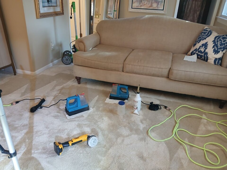

Yes I admit VLM leaves behind but what's left behind crystallizes
What happens to the 2-5 hour dry time (on a good day) dirty water left behind using HWE
Water flushes away most ( 50% - 75% ? ) of the dirt but not 100% of the dirt
If the carpet is wet after you wand that's all dirty water with prespray detergent dirt in it
What happens to what's left behind after you wand
VLM crystallizes what happens with HWE
If it takes 3 hours to dry that's 3 hours of dirty water left behind
If it takes 5 hours to dry that's 5 hours of dirty water left behind
You see the dirty water coming out of your TM when you dump. That's also what your leaving behind
What happens to all that dirt prespray detergent left behind in the carpet after HWE
VLM crystallizes what happens with HWE ???

Where do you get your numbers from?
HWE when done properly flushes away the dirt and detergents. Thats the whole point. We flush away what you leave behind. A little longer dry time doesnt make a difference other than it takes a little longer to dry.
Padding makes the carpet look clean. HWE gets it clean.

YUP neither Method is perfect and both Methods have plusses and minuses
After 25 Years of HWE and now 6 Years of VLM
I prefer VLM with NO residue HUGE Profits and 1-2 Hour Residential Dry Times
Why do people let their grandchildren spill Red Drinks on beautiful carpet
Because they know the steam cleaner can get it out.
10,118
Are you sure about that? Depending on how long it's been there, neither method probably won't budge it. 😬 Especially that much😉
