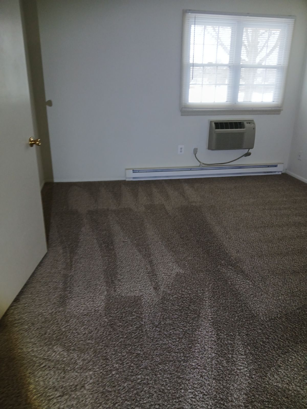

Frank I added VacAway Baby Powder Deodorizer to Carpet Details today and it left the house smelling great
Danielle likes her house to smell clean after carpet cleaning
VacAway Deodorizers are Fantastic
Just took one pic of a Second Floor Bedroom
Life is BETTER when you use the VLM Method
Samlam is always PISSED OFF
Maybe if he used VLM his life would be BETTER
LESS problems LESS stress using VLM
And look at the results you get using VLM

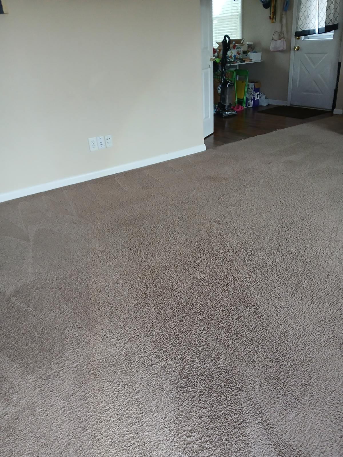

Do you still prefer Vacaway double trouble to encap green? Right now i'm using up some Bonnet Pro Nanomaxx and it's also pretty impressive,,
Yes Double Trouble is much better
I use Encap Green at 4 or 5 oz on nice easy to clean light soiled carpet and wool
Double Trouble I use at 2 oz 99% of the time. It's a outstanding cleaner for polyester. Nothing better IMO. If the carpet is TRASHED I use it at 3 oz
Rat Nasties I use Commercial Magic at 4 oz
I usually add Detonator ( peroxide ) at 4-6 oz always on light colored carpet
Adding VacAway Smart Scents Lemon Deodorizer at 1 1/2 oz to Double Trouble for customers that like a nice scent after cleaning will make your customers even more happy with the results. I don't add anything to Encap Green
Of course they all need a thorough scrubbing with a CRB or 175 for outstanding results
I scrub with a 14'' CRB and extract with a OP ( TOPS Odyssey or Tankless Orbot Vibe )
10'' CRB's suck too light to scrub and too slow. 14'' or 15'' CRB's with some weight are needed for best results on medium to heavy soil
And using the right brushes for the carpet is very important
10'' CRB's are good for Area Rugs and to groom after cleaning
LESS water MORE agitation !!!
