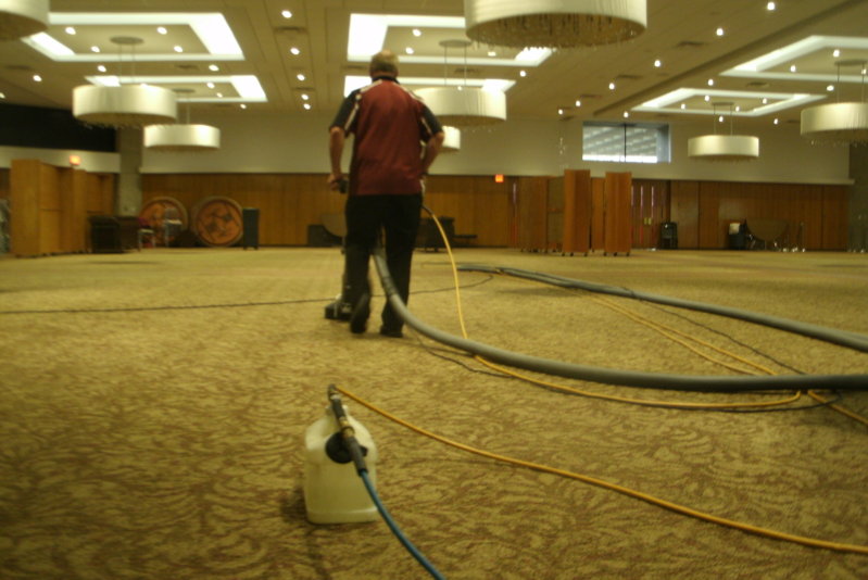

2nd job called and postponed this morning because it was raining out.:frown: WTF. It's not raining in. Whatever. It was a large job so I was able to do a commercial job that was going to be in 2 weeks. Large banquet room. Ran emulsifier (Esteem CBS, love that stuff) through a HF then to 100' of Parflex at 600 psi to the 360i.
No prevac,no prespray, except some Flex at the 2 kitchen entrances. Pretty much effortless, certainly compared to the times I used the 175 and Ti wanded the place. Results were superb.

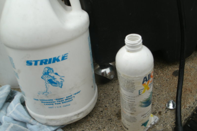

Lot of gum and wax which I was able to remove with the 360i after a quick squirt of Strike solvent (great smelly stuff) which I had transferred into an AllSolve squirt bottle and had in my pocket.

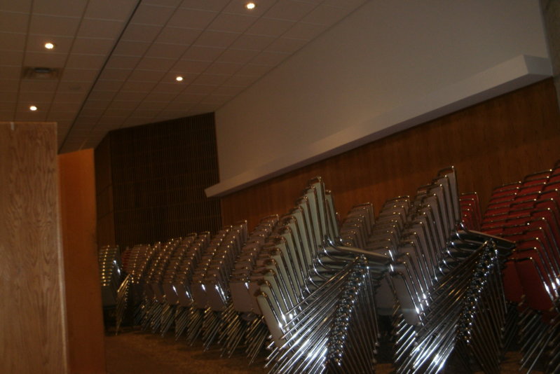

The chairs in the corner await my ministrations (a 2 day hump job)

This room is 100 X 100 and I've cleaned it every year. Wanding it, even with the glided Ti wand, is quite a workout. I used the RX-20 on it when I got it in 92 but it was slow and I still needed to 175 it so I went back to wanding. Using the 360i these last few years was a revelation. It's fast on relatively clean areas, as fast as you can walk, and on some areas I could go over 3000 sq'/hr. In the rough areas I was probably at 1K/hr. One of the maintenance men asked me if they made these machines larger. LOL. The XL model would probably be more appropriate but this 12" model is what I have and it works well and goes plenty fast.

I didn't expect to do this job yesterday so all I had on the truck was a 5 qt jug. I had to refill it maybe 5 times. It has a longer draw tube so I could have used a 5 gal bucket, but I wanted to see the jug drawing down as I worked because this method of applying rinse product doesn't always work. I normally use FWR while cleaning after applying PS but I wanted to one step this job.
