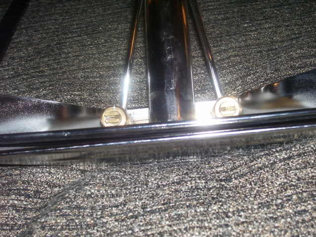

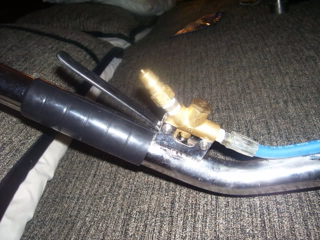

It arrived today I just took pics of the trigger and jets...

That will work well for you, but don't be afraid to upgrade later and have that as a back up wand.
Sucks when something breaks on the job and you don't have a quick back up.

yeah I plan on getting a better one in the near future but I just wanted to make sure everything is running before I invest to much money into my wand... Are the jets pointing in the right direction or they dont adjust thats just how it sprays/sits...

Pretty sure that's it. Greenie may have some weird ass part that might change it but I don't know.
He has some jet extenders with check valves that bring the jets closer to the carpet to retain heat and keep it from drippin.
