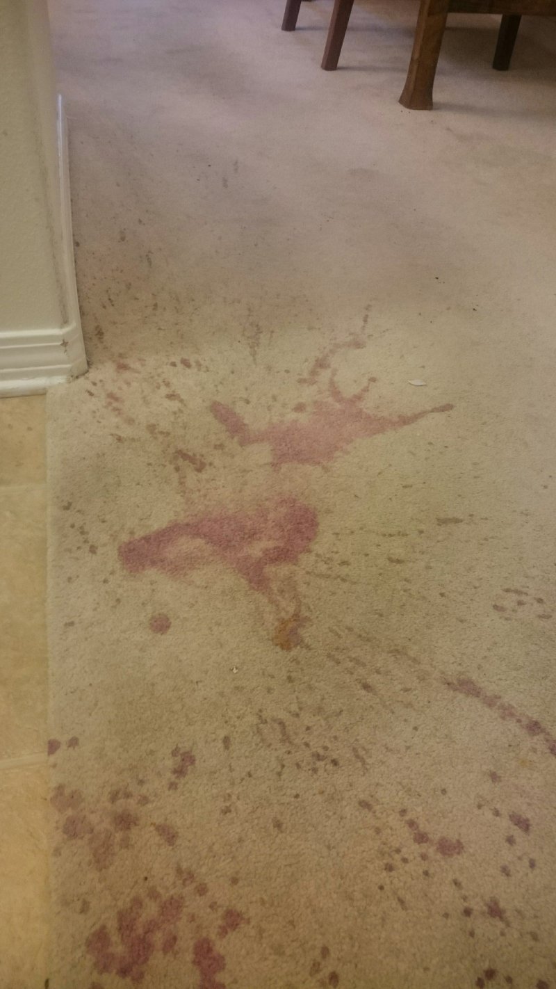

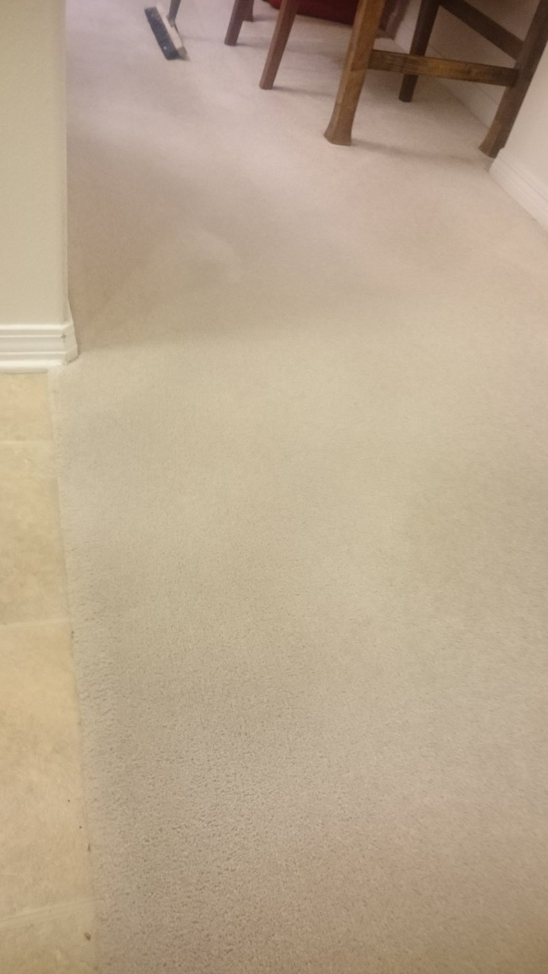

I just hit this red wine mess with Cobbs powder brightener (a few days ago).
Went back (today) and scrubbed it with the 10" crb and padded it up with a couple of pads.
Other than padding....I didn't extract anything SHOCKFACE!!!
And it already brought 4 referrals....
I am -inadvertently- becoming good at this padding business (inadvertently because a lot of my customers want dry as soon -or even sooner- as possible)
Went back and scrubbed it with the 10" crb and padded it up with a couple of pads.

I am inadvertently becoming good at this padding business (inadvertently because a lot of my customers want dry as soon or -even sooner- as possible)
With a 20flow and a #45 blower, I don't blame them.........:stir:
Looks great Zalan!
Believe me, that if I could access some of these units with the truckmount.. I'd do it. But since it's impossible and I don't want to deal with taking a porty (longer drying)- my best is to pad.
I don't have drying issues with the fire breather and 20flow.
