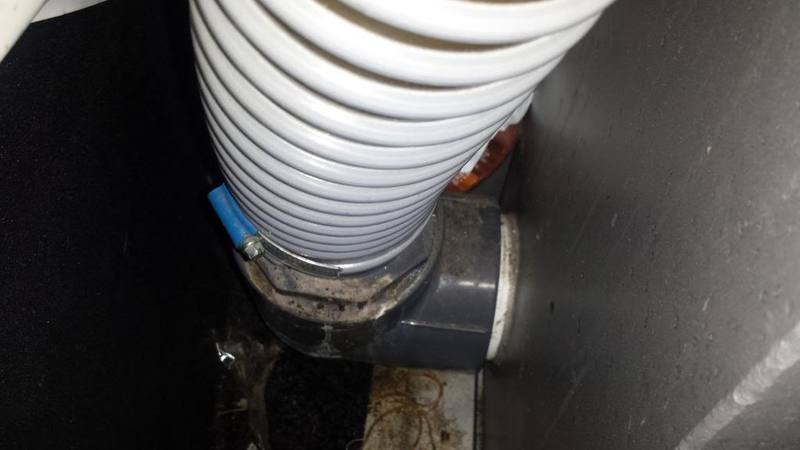

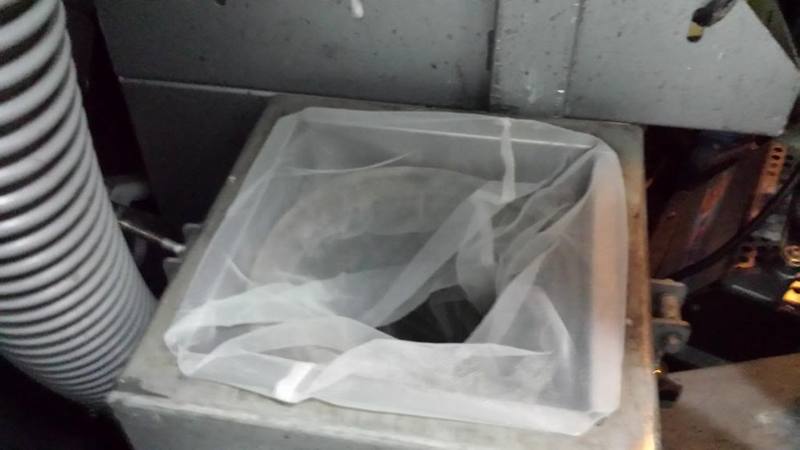

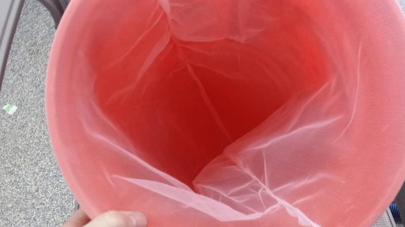

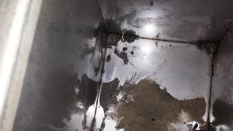

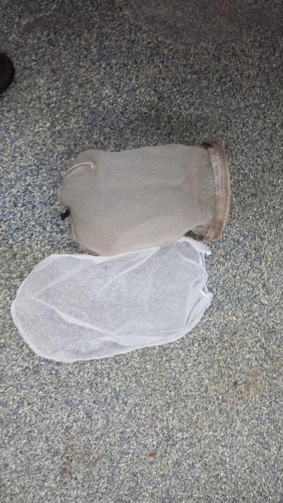

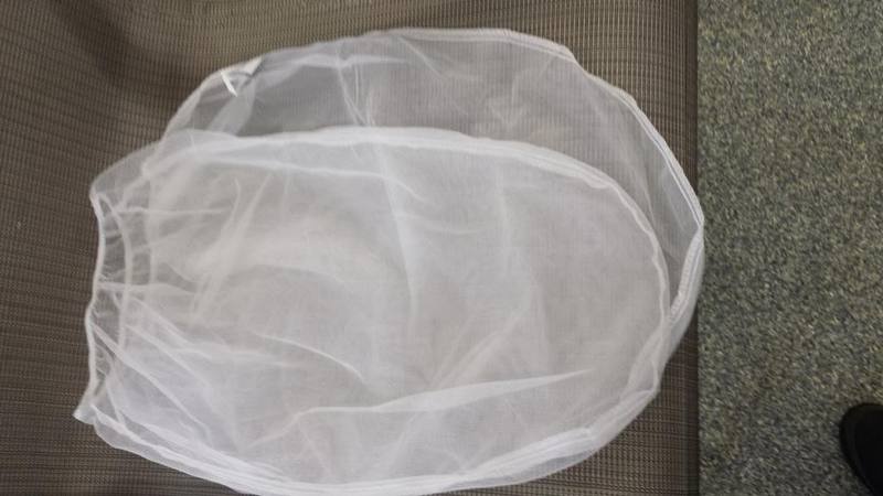

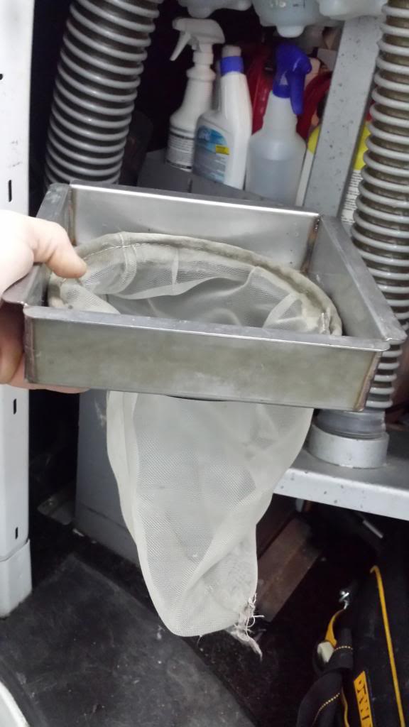

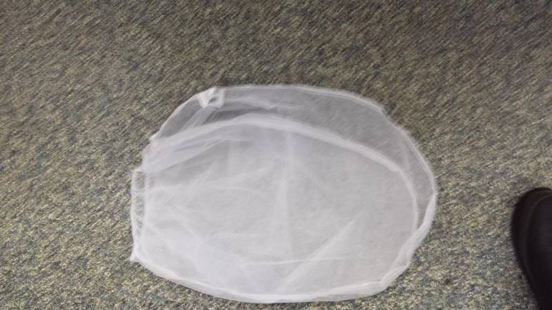

Here are pics of the rear waste filter clean out for Butlers. I have a Greenglide deflector inside it, but Bulters now very close to this with the extra holes.

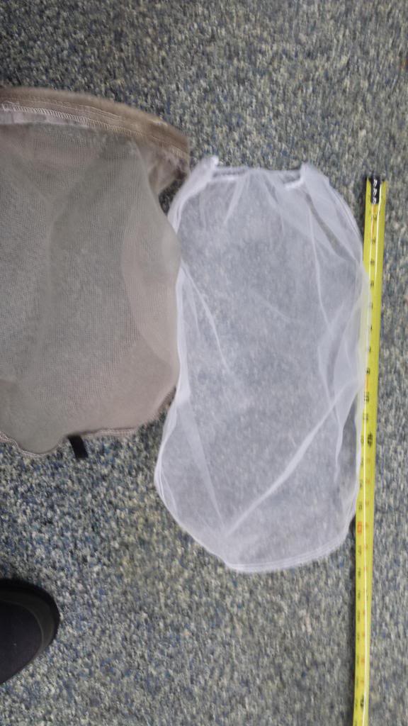

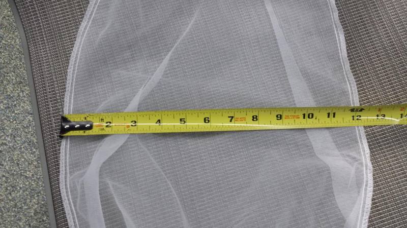

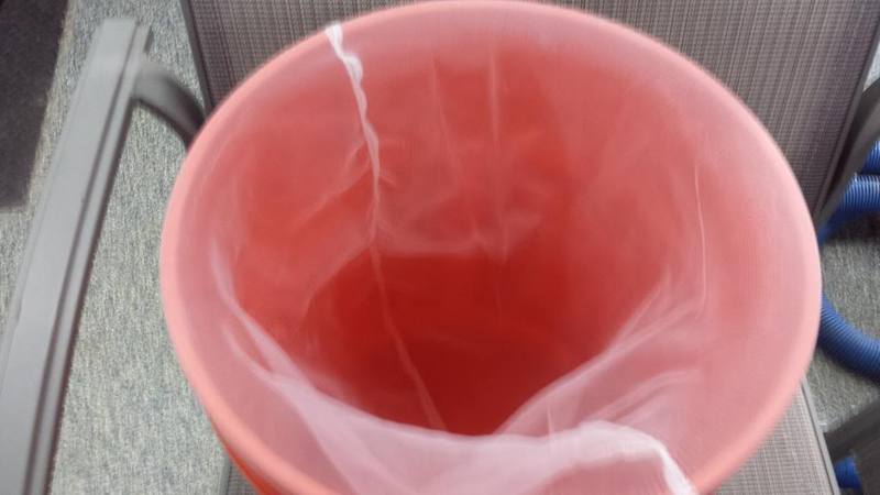

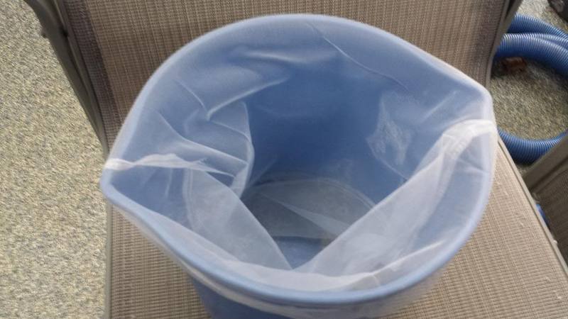

I did find out that we are using the 2 gallon paint filter bags also. Went to Homedepot and bought a bag of 5 gallon units to compare. We really just get rid of the paint liners everyday rather than keep rinsing them off. Just too cheap in bulk to waste the time to clean them for us.
Really like the Butler clean out the way it is set up now. Ever thought of just getting one of those Dave for you new set up?
Thanks also Jim for your help too. All pics with the tape measure are measuring the 2 gallon bag.
Also, the butler lid of the rear waste clean out filter box is just a rubber replaceable gasket like camper foam for you pick up....maybe a but more durable.
Comparison of the 2 gallon and 5 gallon bag

my thermalwave is plumbed 3 inch from blower to waste tank and from waste tank to filter box.......
then it has a 2.5 inch hose hook up...
inside is the mesh basket....
the 570 is pretty much plumbed the same way...3 inch down to a 2.5 inch hose hook up....
only difference is that there is no filter box....I drop the devastator in line and that machine breaths way better then the Thermalwave.....

Yes mark I called butler and they are getting like 1500$ for that bad boy..I can have one built out of stainless for 1/2 that price identical to theirs..
I still have a butler and will simply have my guy duplicate it..
The way the sapphire is plumbed I won't need a elbow at the bottom..just a straight nipple so that will help,with flow even more
