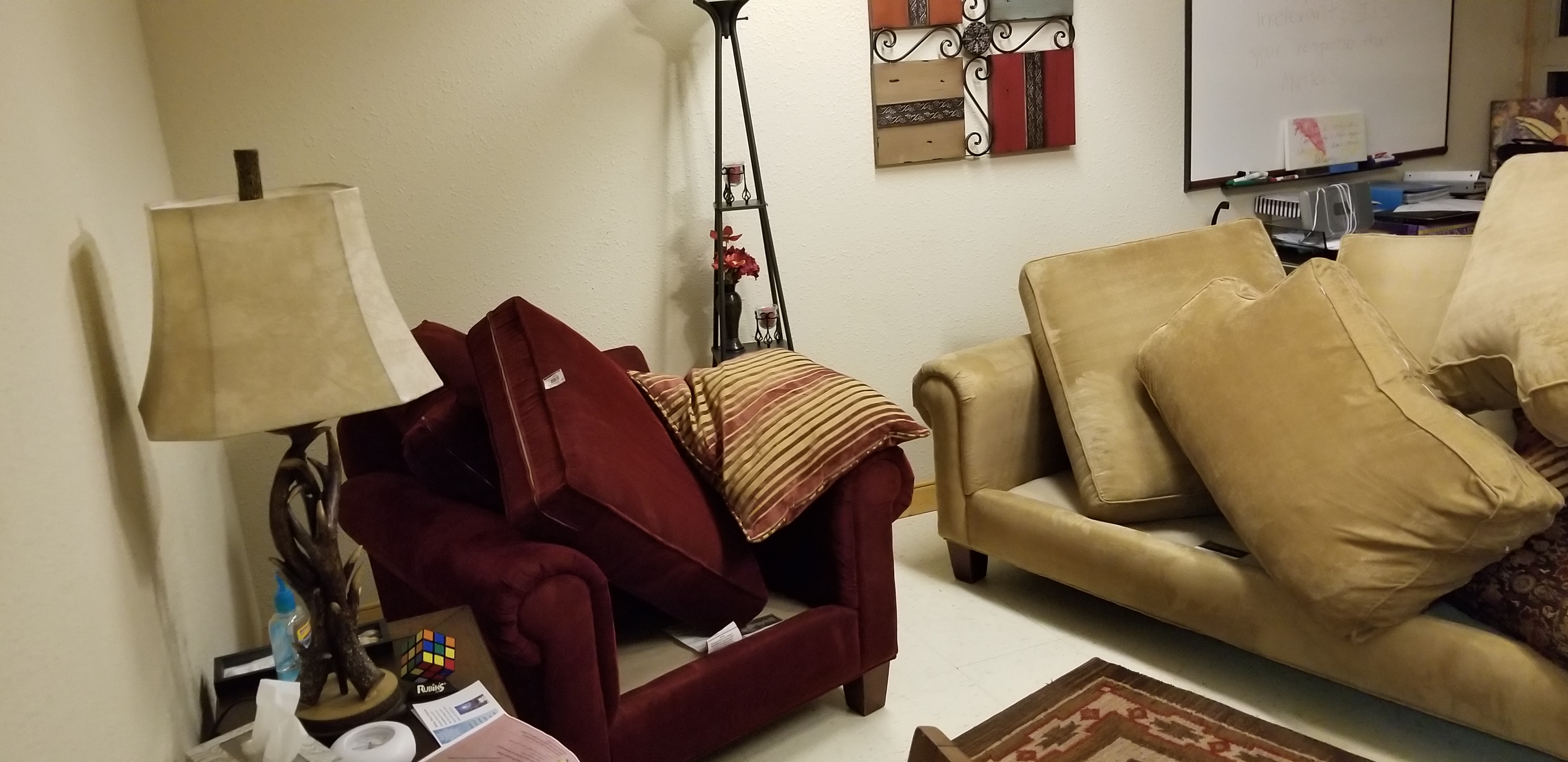

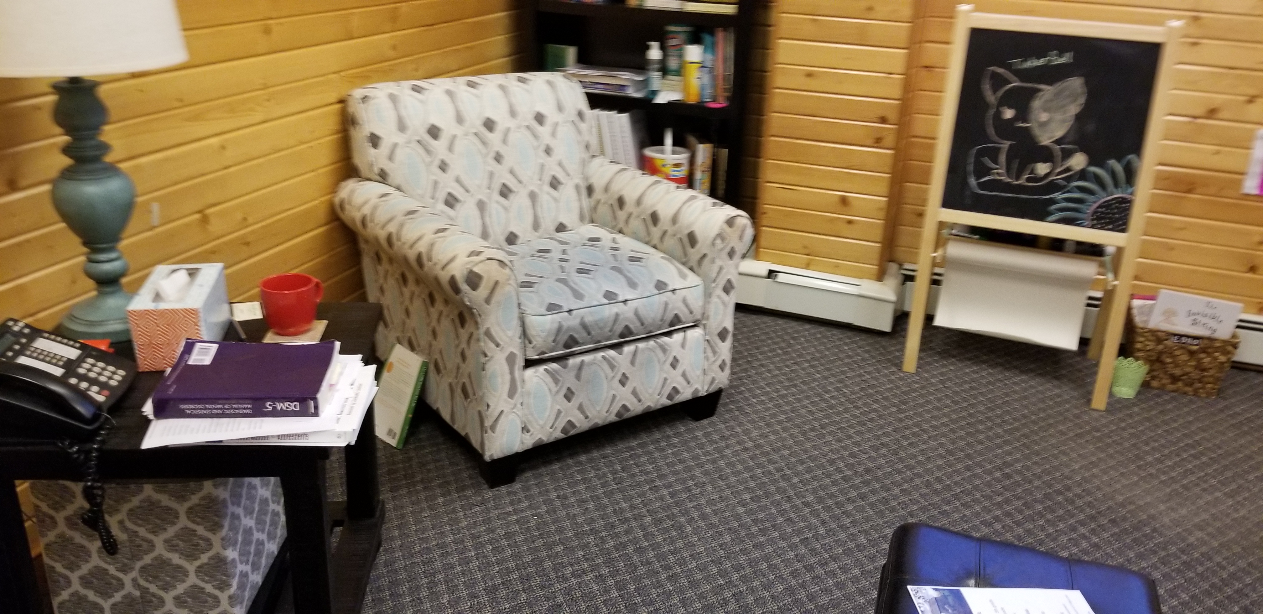

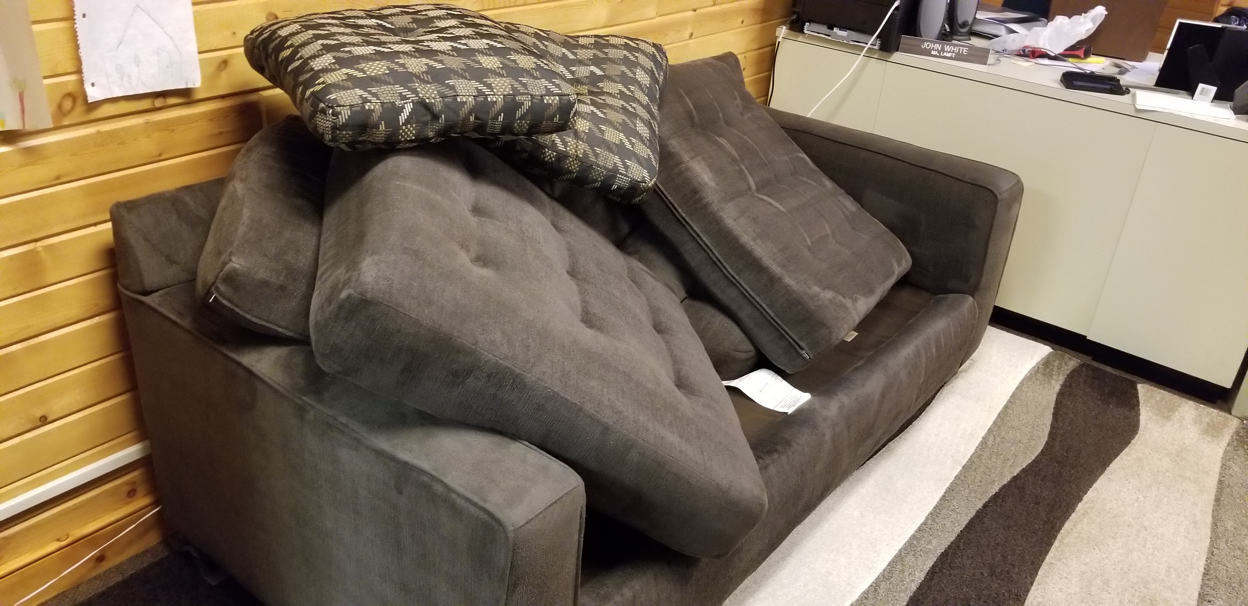

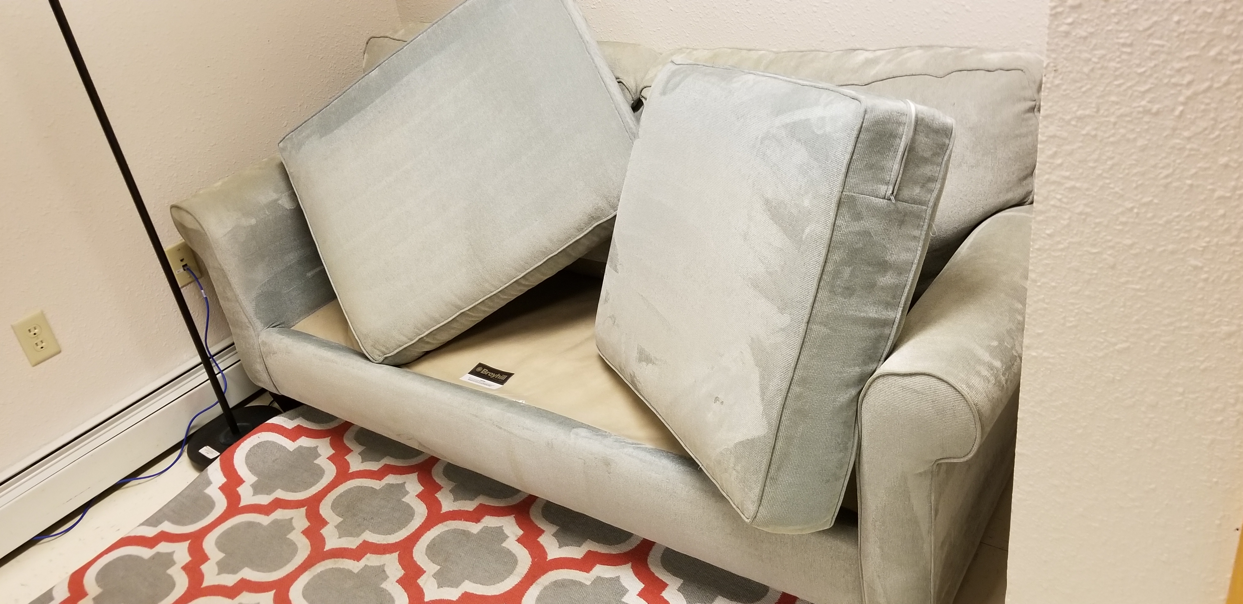

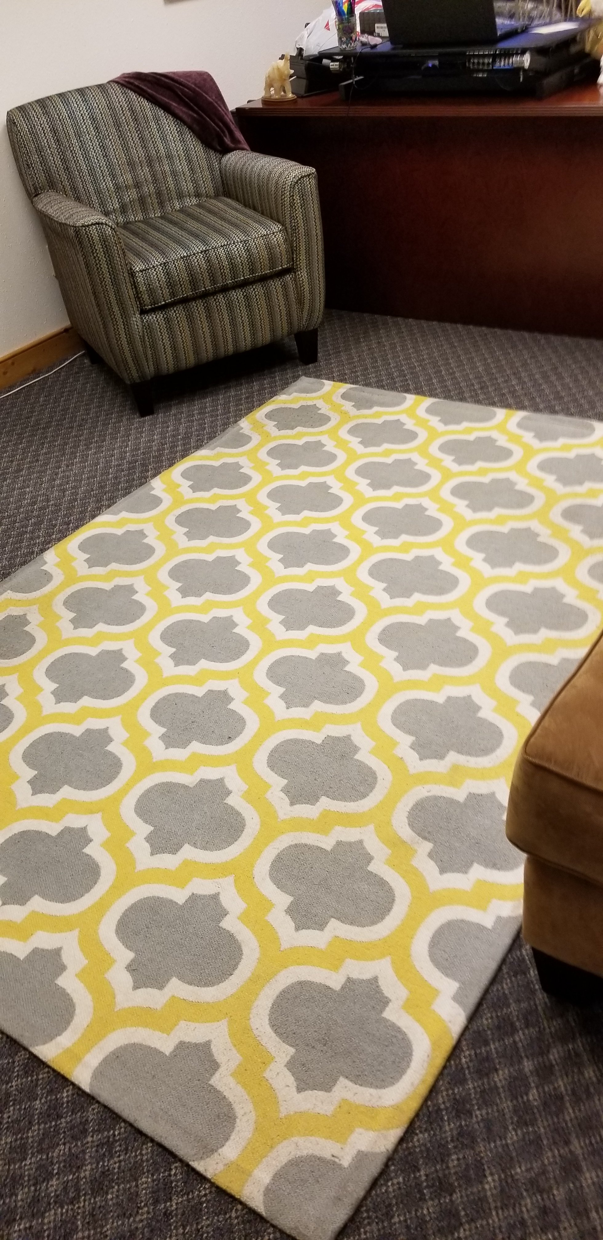

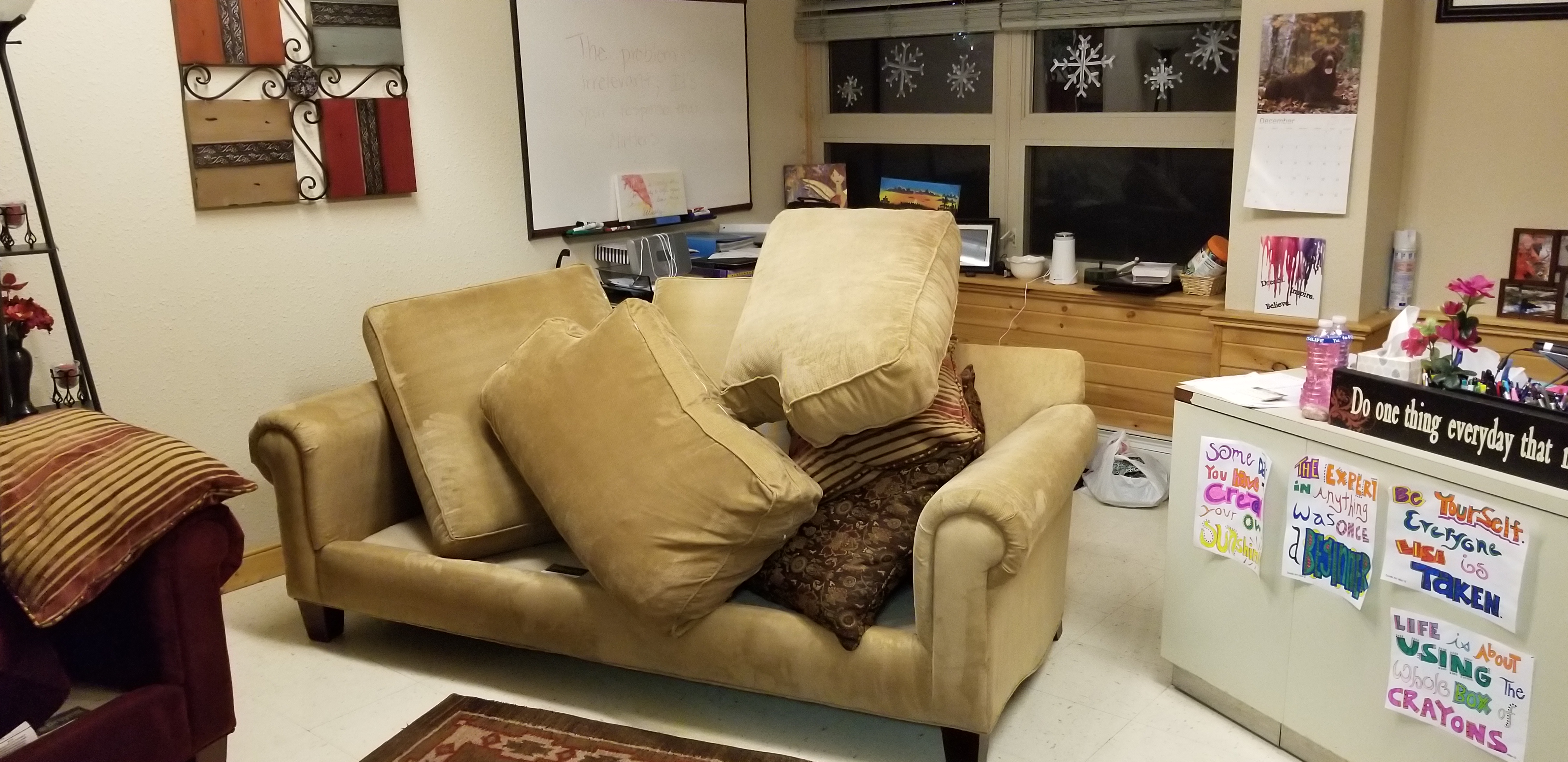

16 recliner chairs, 8 couches, area rugs, offices in -14 degrees Below Zero...ALONE!
11,199
Grand Rapids, MN
Well after doing ALL BY MYSELF yesterday
8 couches,
16 recliner type big chairs,
6 large area rugs clean and move around to other sites in the building,
1000 Sq ft of wall to carpet with move, tab and block everything in those offices,
and 12 office chairs...
With a 300 foot hose run on each floor level (2 levels) in - 14 degrees below zero...
And being pissed off because new young hire did not show up and finally sent me a text at 3:48 in the afternoon that he just woke up as I am hustling my ass off to make sure don't freeze up and keep running....
This is my frickin morning...
Hands, back and legs in pain! PS...
New guy told he be done.... Frickin pansies these days!
Son in law Aron Jewett was busy moving into their new home otherwise would have been a tag team getting done!
Boy sending a text back at 7:48 pm telling new guy I just finished while sitting in the van....and tell him to come get his last paycheck Friday...and bring back his uniforms....
Priceless...
in 3 weeks he as been late 7 times...and couple times way into the afternoon before getting ahold of us....

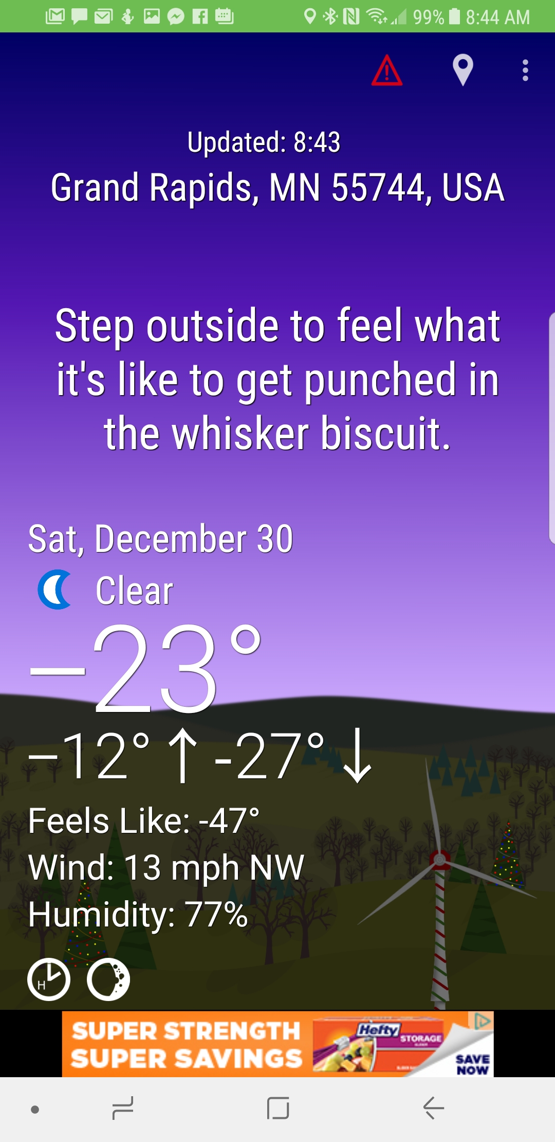

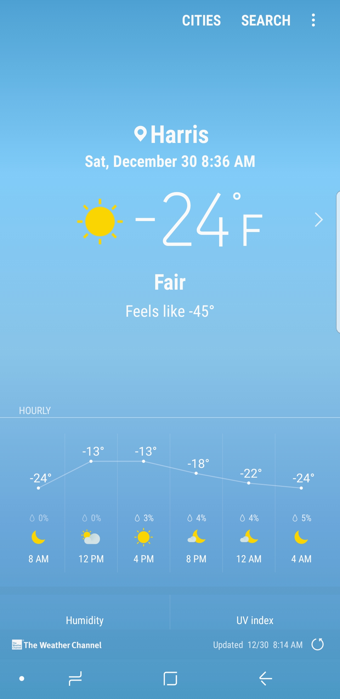

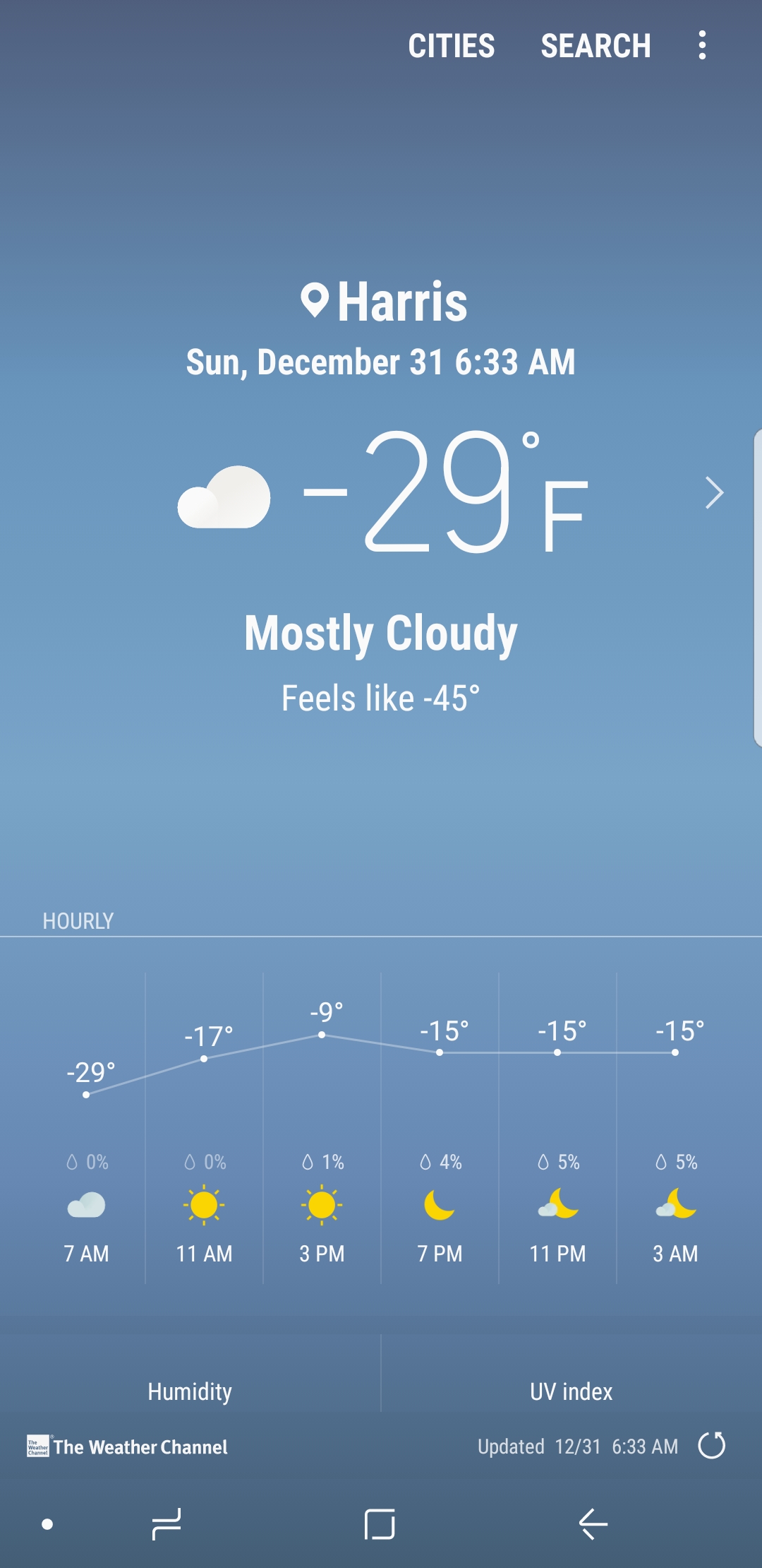

Sorry to hear that. I can only imagine what working in -27 degrees is like... Told Brandi, if she wants to move, id probably have a job secure on MN..showed her that screen shot, she said, hell no! :biggrin:. You are real ice warrior.:rockon:

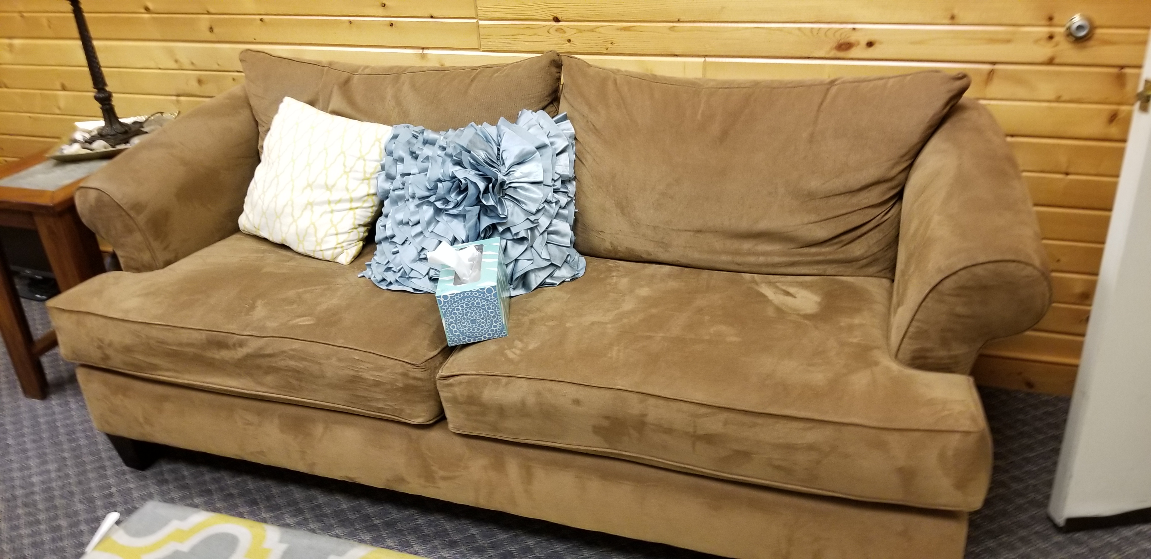

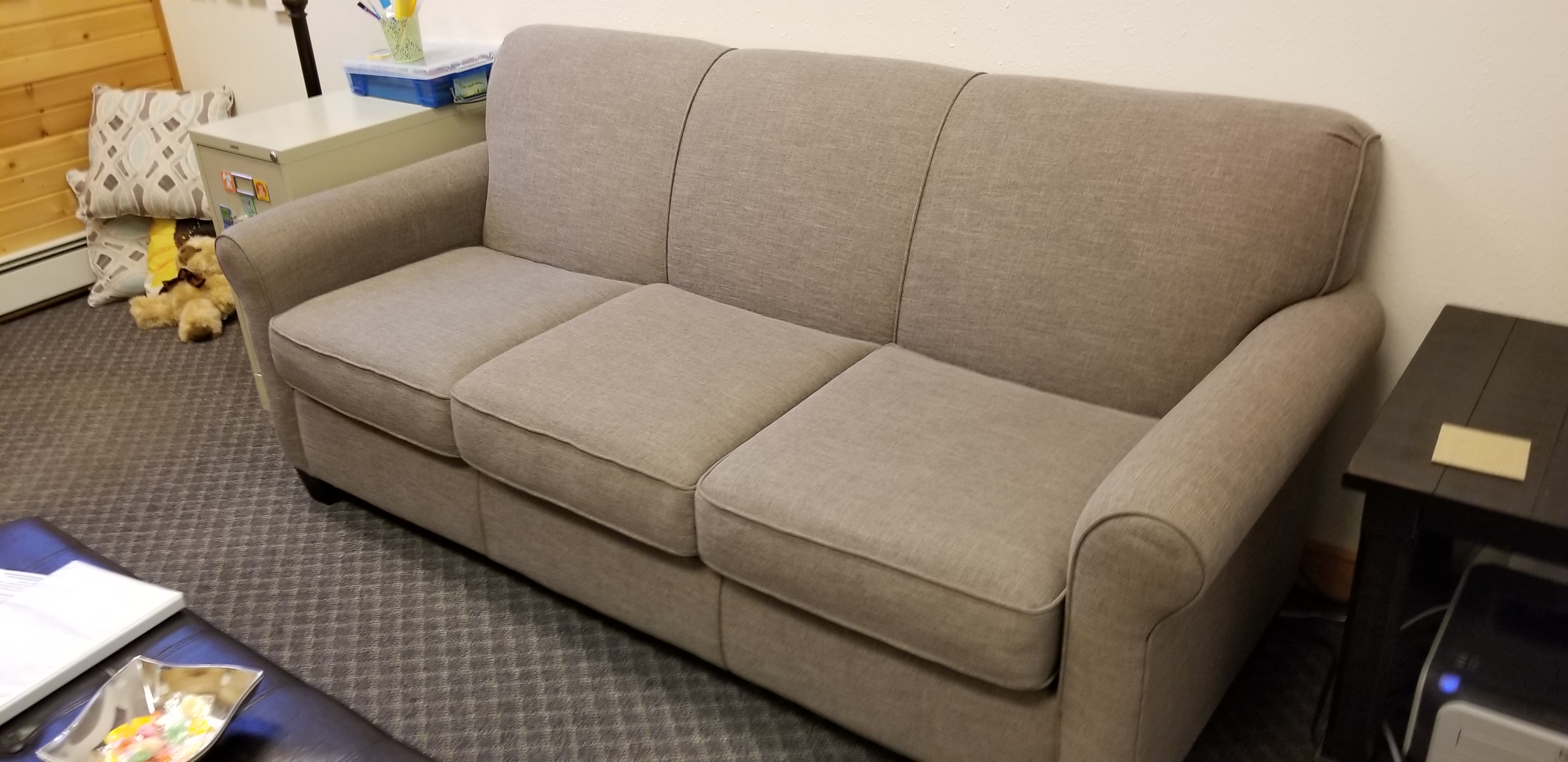

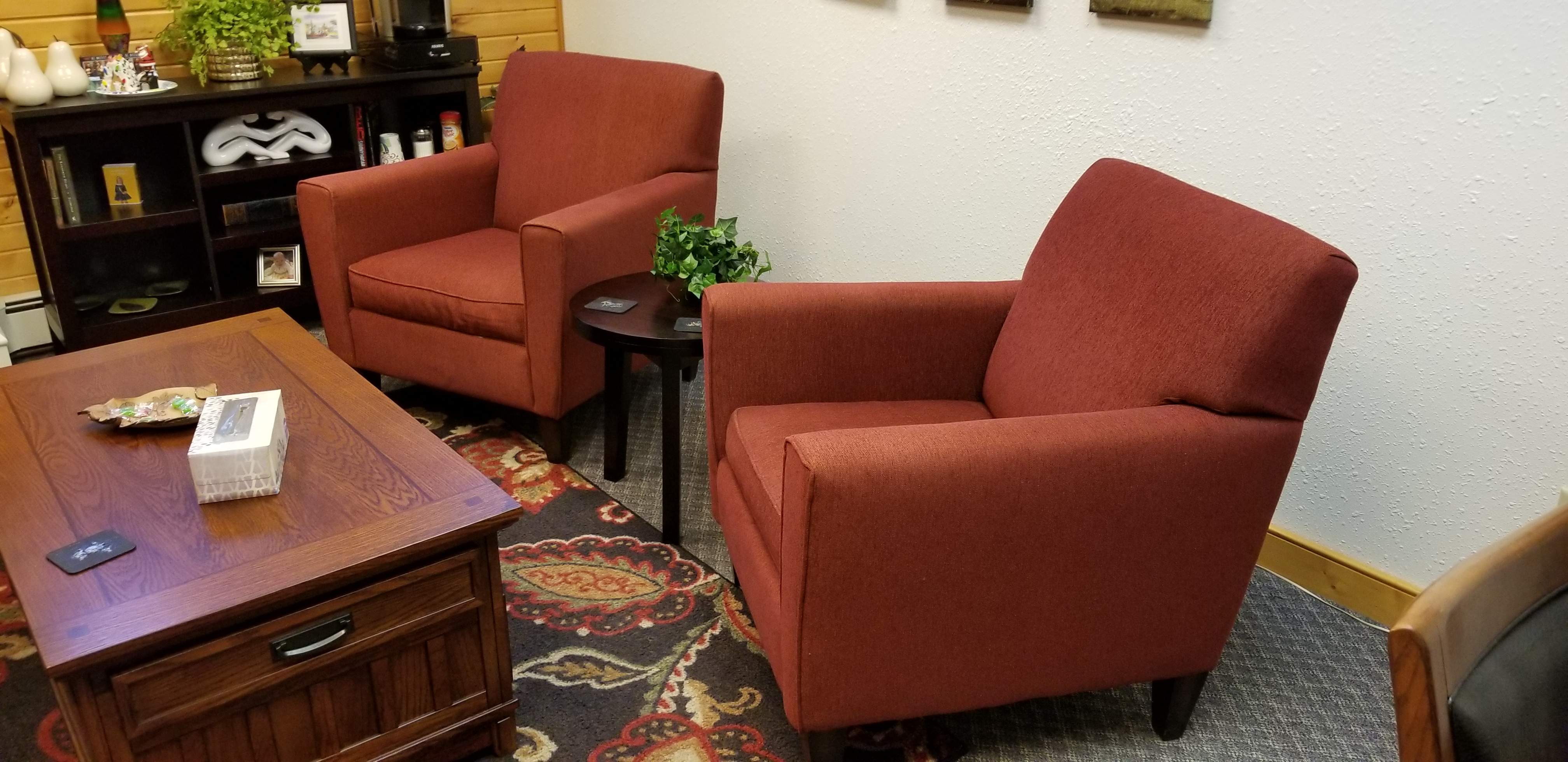

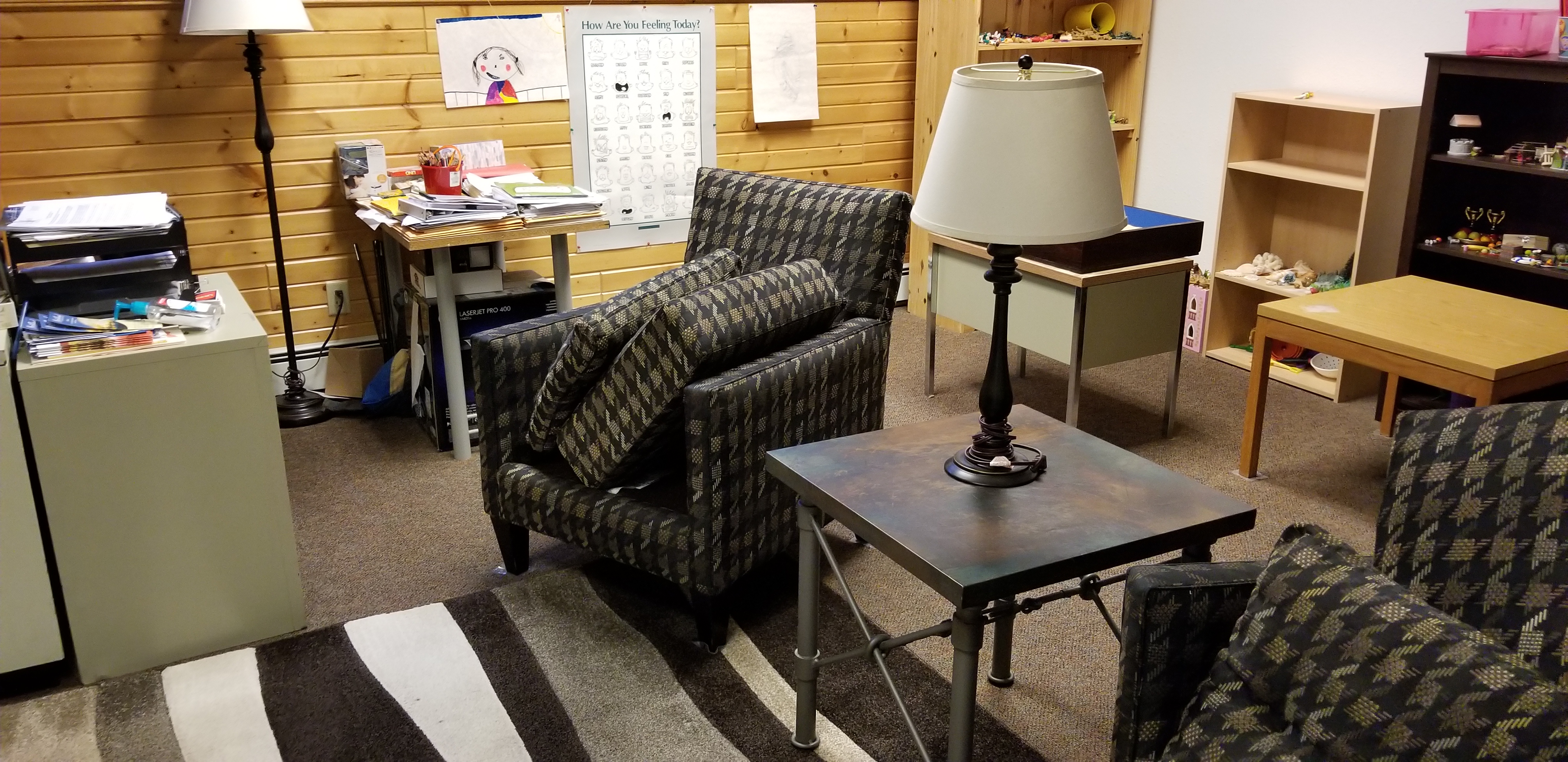

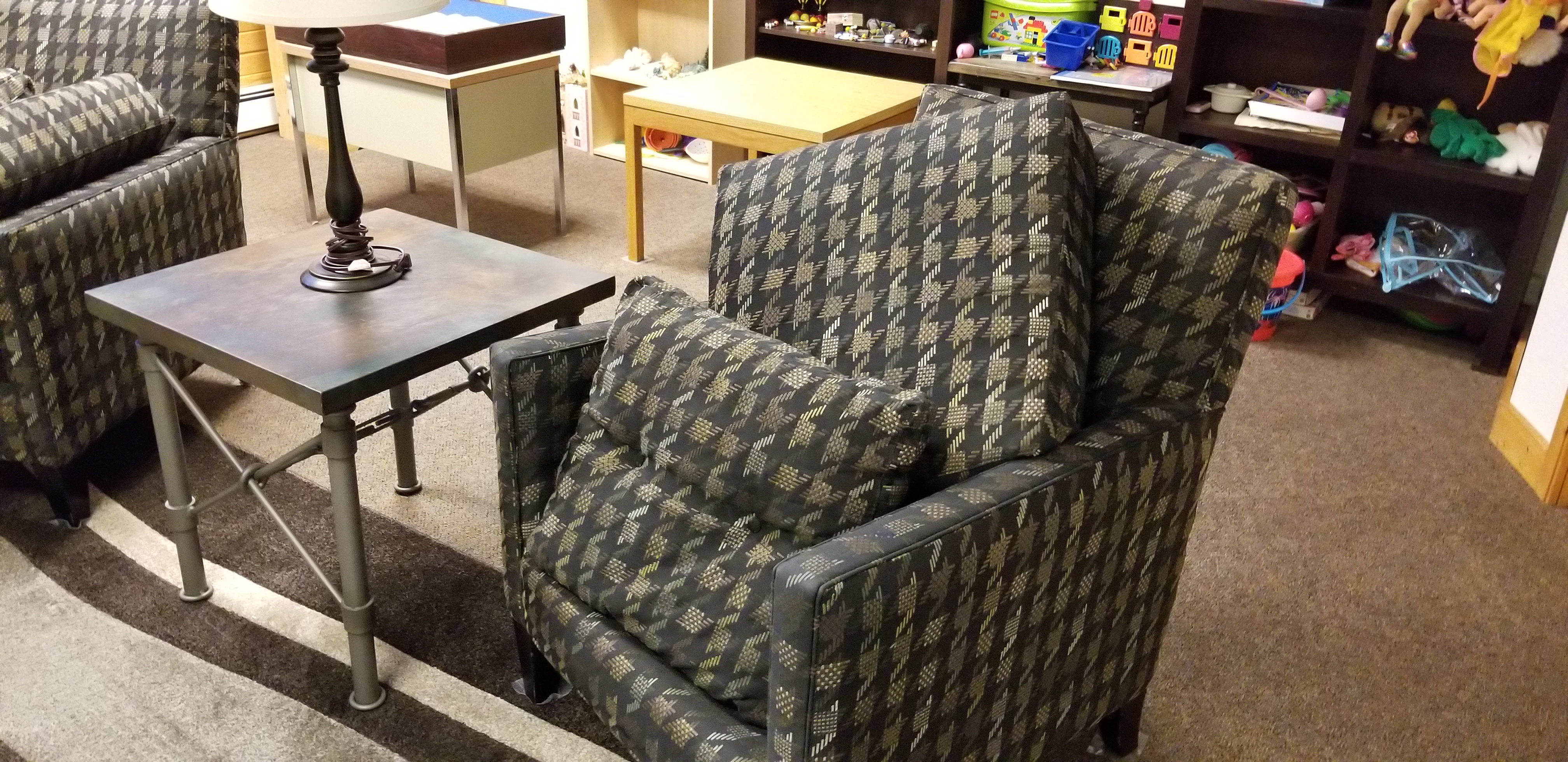

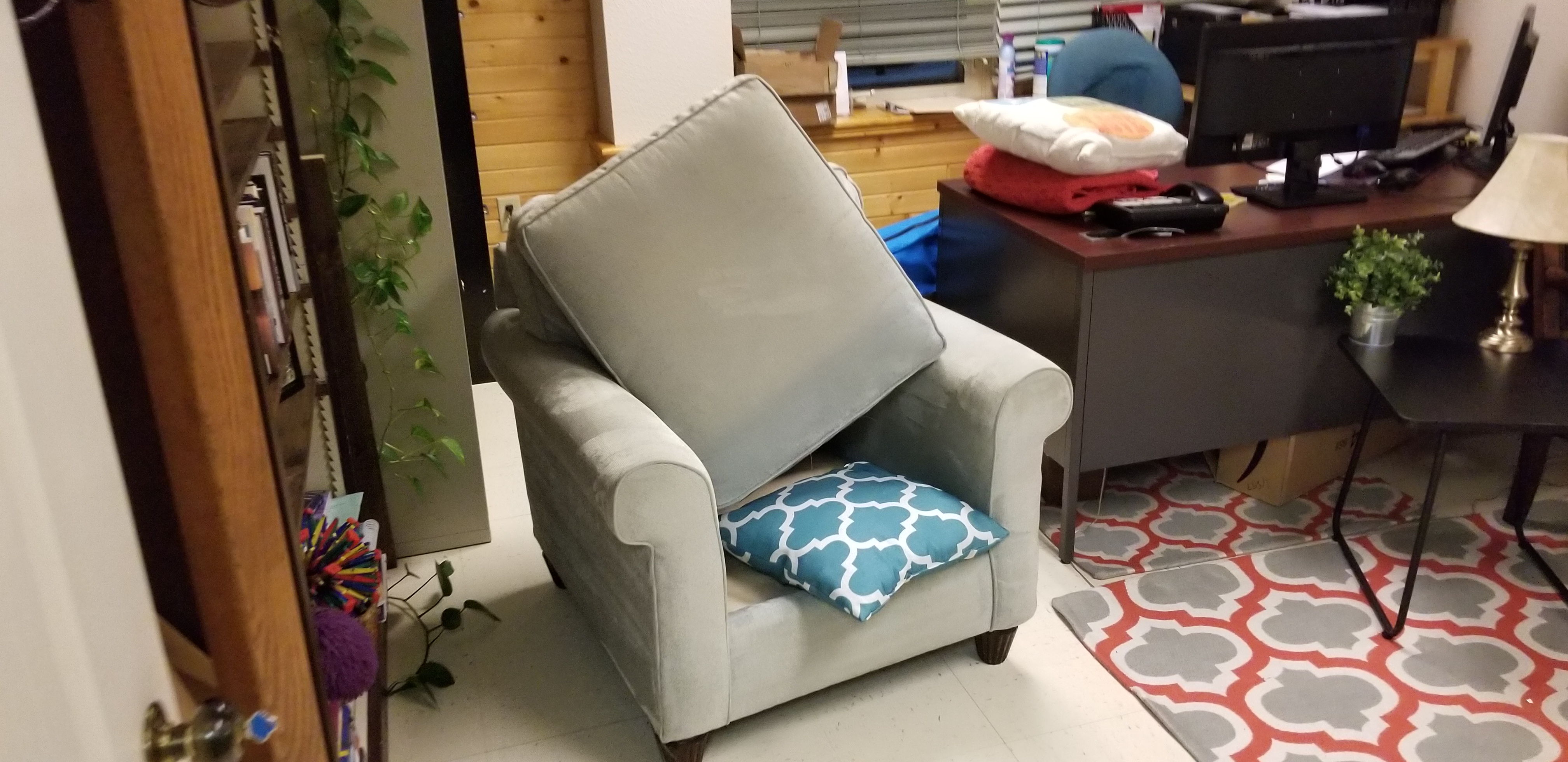

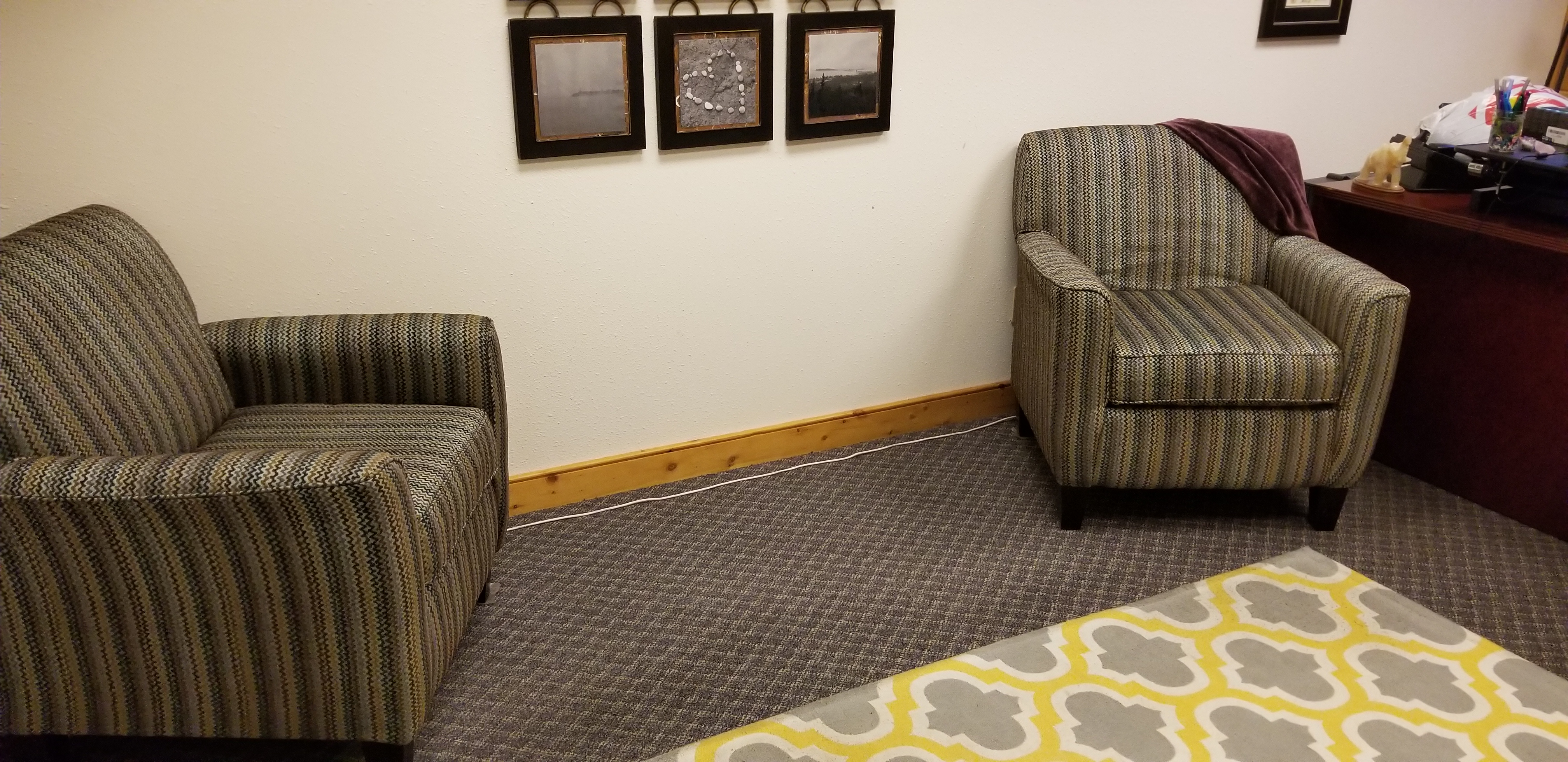

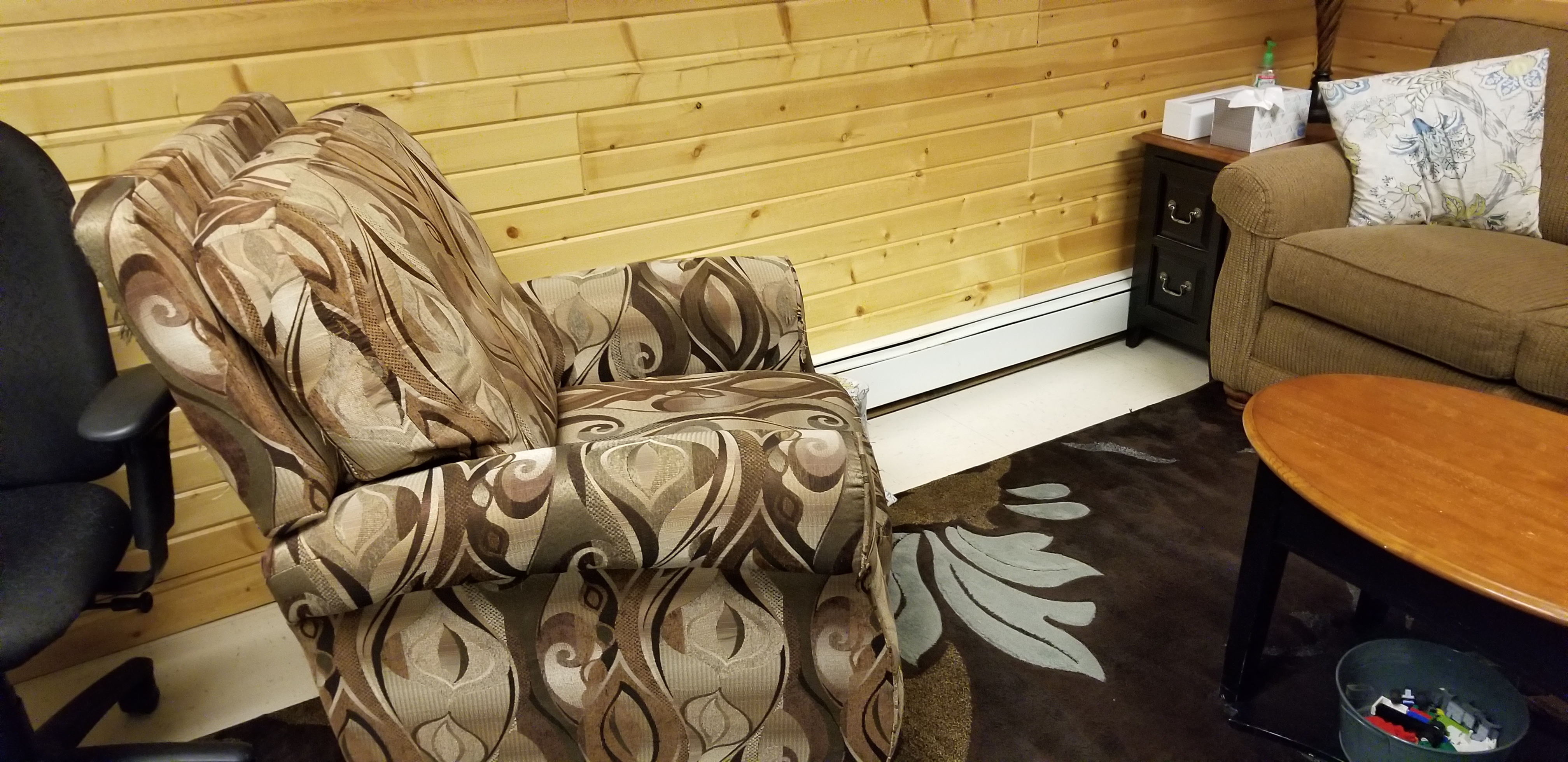

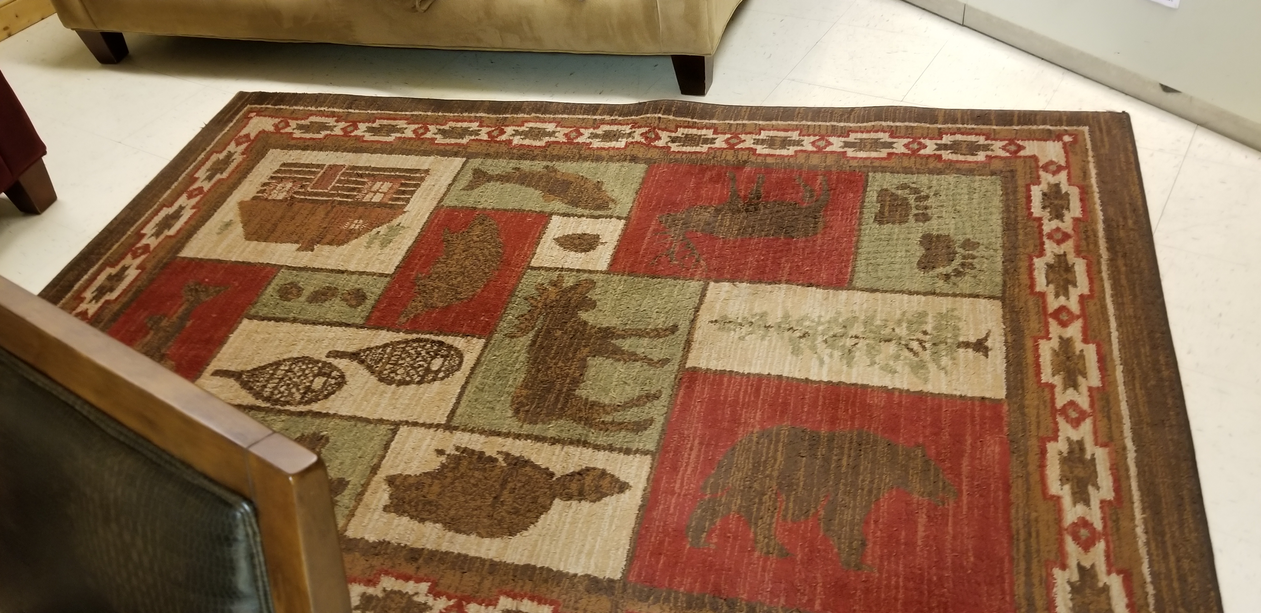

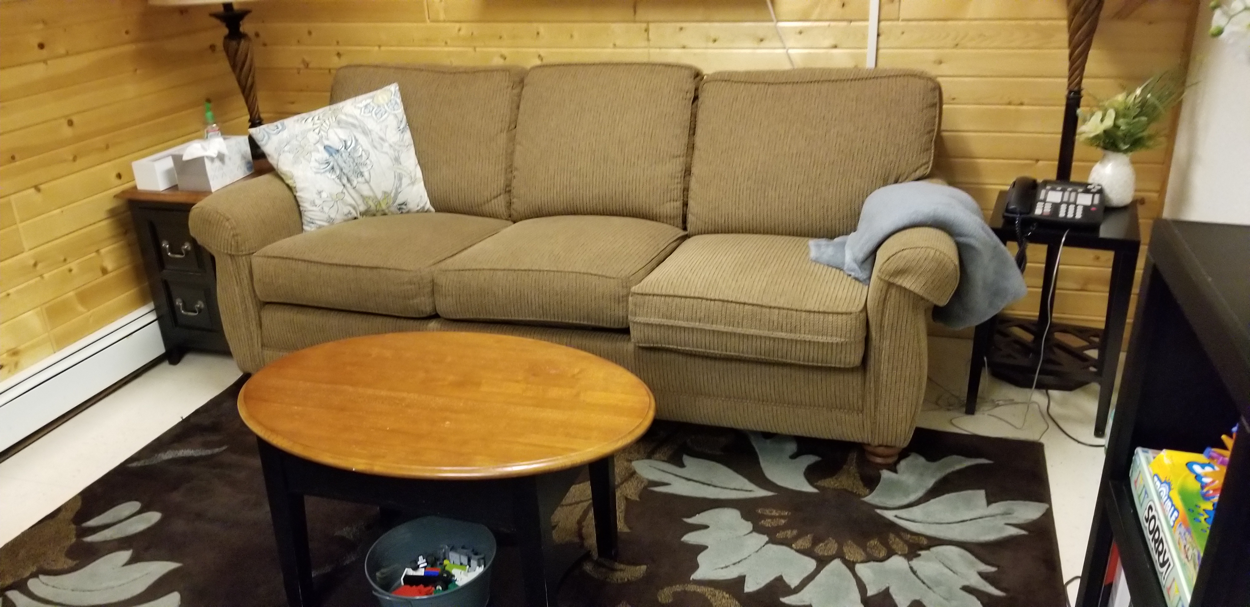

I think I do need to comment here...in dire conditions of time...you kind of pick and chose as Mikey Mentioned so you can still get the job done and make the clients (and yourself and reputation) happy
I used the Rotovac Shear dry on the upholstery because of the agitation part of the head being more aggressive then some others....Also, for prevac of the upholstery...I did give it a wack and would also use the head and or the hose for most prevac to keep moving....Water in the vac line and not a lot of soils I was ok so not to hurt my vacuum pump with dry soils.
Time in this weather can make you keep moving...but honestly, I even let the hose sit with no water flowing for 10 minutes and never experienced a problem.
And luckily, all the upholstery was nothing fancy...just poly and microfiber, and the area rugs poly also....so pretreat was the same for all....and yes...really cheated and was in a position could spray heavy...again agitation was minimal because not too soiled...
This was a facility that was for children counseling so HWE over encap was an important factor (before throwing out the why didn't you encap it)
They wanted items moved...so I move items...Upper Midwest there is a lot more requests for moving and cleaning under items....Oh by the way...I got 50 cents per square foot for wall to wall and 75 cents per sq foot to buzz over the area rugs...
I got lucky and did not have to agitate carpets..one room could have benefited in an area with a CRB...but I had scrub brush which was way faster and one less piece of equipment to drag in... but if a CRB would have been needed, I would have brought it...
Prevac of carpets...I got lucky...the night crew had been in the night before and traffic had been light or not even occupied that day in those offices that morning.....otherwise...yes...Prevac would have happened...but time again. you would have to prevac a room quick...and get the prespray down, or even just keep water flowing with a hand tool or a connector jammed in your vac hose.
For cleaning, I was lucky the carpet wasn't too heavily soiled so I could pace the amount of water I used on this job. I was running a 10 flow on my Conway wand (Special jets) and upholstery tool normal small jets.
Kept the Butler on Medium (because cleaning upholstery, but the Conway wand made up for the 300 foot of hose as well as the extra 2.5 inch hose) I started with 110 gallons of water and went home with an 1/8 of a tank :eekk:....freaking lucky!!!!
So, yes...I did have to do my best "Hack" Job and still felt got great results.
Total bill at the end of the day just shy of $2800 those of you wondering...and not to make a I've got a bigger....blah, blah, blah....
So I felt really good as a one man crew pulling this off in what could have been a negative situation!
Now go hack away! :)
