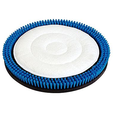

short answer yes...............The dirtnapper is a pad driver. The outside row is a carpet brush, but the inside is for a pad of choice. Great aggitation, plus absortion from the pad. Downfall is you will have to get smaller pads to fit the dirt napper driver. Count on 1 pad per room ( double sided)........Probably wont need that many, but we are talking about apts, so you just never know.
If you want the bare minimal. Just get a ful size carpet brush. After you vacuum, and prespray, run the brush in all soiled areas and traffic areas. You could go wall to wall if you choose too. After brushing all rooms, pop on your pad driver of choice and pad extract. On larger pads,you should be able to use 2 pads ( 4 sides) on the bedrooms only. The larger pads, because they are larger hold more soil.

This is a dirt napper. i have a 15 inch driver that accepts a 13 inch pad, but you can get different sizes..
