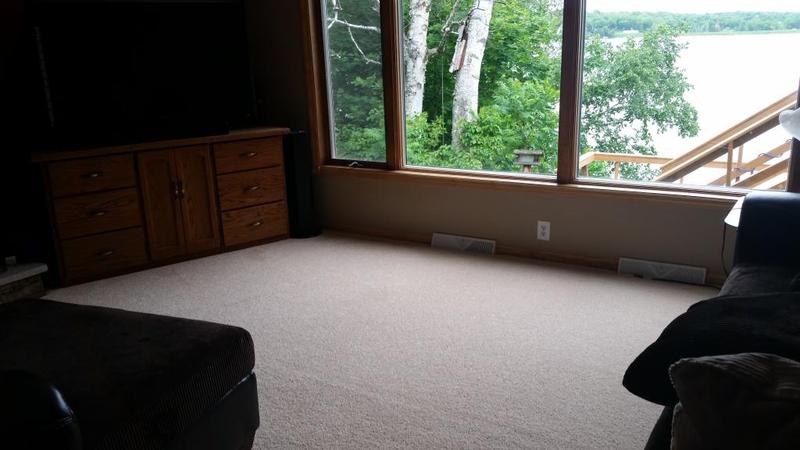

Here is one picture of one of our Living rooms with our smart strand.
I am waiting for my wife to wake up so I can take some other pics of other rooms.
Want to vacuum it up and rake it out so can try and see it better.
Will also try and move some of this furniture in this pic so you can see if wear patterns (which we really are not experiencing)
The line across the middle is a small hump in the floor of this room (older section of our home) that the light is hitting just right at the moment.

Well, I am trying my best to get some pics and the sun is not cooperating for this....but it does look like a great day for the lake!
So here are my best on our Smart Strand. We are not experiencing the problems some are describing.
I was sold on trying the smart strand after a client had spilled "Red Cherry Wood Stain" on his new carpet while staining his new fireplace mantle. We were able to remove it with HWE and the assistance of some delamine.
So here are a bunch of pics before vacuuming, after a vac, my foot prints in the carpet to try and show it's wear or lack of, moved the couch out to try and show no real wear issues, in front of the bed (wasn't taking down my King Bed for you guys...sorry, but not really :) ) Raking/grooming it out....
I have experienced some cheaper types of this carpet being more finicky, but we have been able to clean them up. I think it is like any other carpet, the quality counts, so go name brand in my opinion.
This is a 57 ounce Smart strand on a 10 pound pad.
