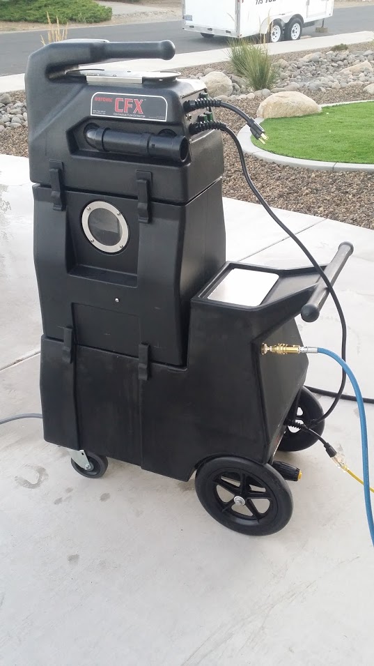

Setting up the CFX was frustrating for this first timer. Its a two cord system with a pump out but no pressure pump. I figured any 20 amp outlet with a GFI button would work. Nope, I had to go to the garage where the HVAC gets plugged into for the pump and vac switch and to the outlet in our laundry room for the one pump. I was tripping switched with out even turning the power on....wtf?
Once I got it up and running I found it to be well balanced set up. Hot tap pressure, two 3 stage vacs and the 360i, it did a very nice job and it feels as dry if not dryer then a truckmount. The water being fed to the toiled was impressively brown.
I spotted some uph and the Sheardry worked real well at house pressure and had plenty of vacuum to clean just about anything.
Now if I had to plug in the 1200 psi Ranger base AND the EDIC heater I don't what thee hell I would have done.

How did the pump-out filter look afterwards?
perfect Frank, once I got it running it really did work well.
Not sure how choosy mothers will feel about the sink/faucet hook up, all the cords, the toilet drain.....
I kept it all inside but I like how Art keeps it on the porch and waters the shrubs..

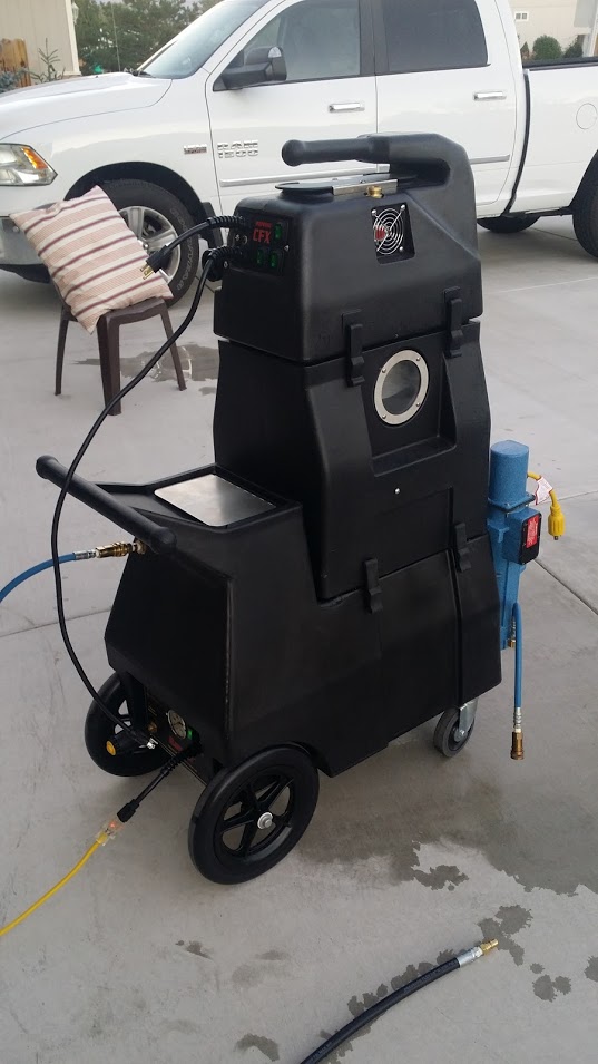

I set it up again tonight on two 20 amp outlets in my garage. One was a GFI. No problem.
I also tried the 1200 PSI Ranger base. Kind of cool.. Tile and filthy carpet will get cleaned better for sure. Needs some tweaks though..

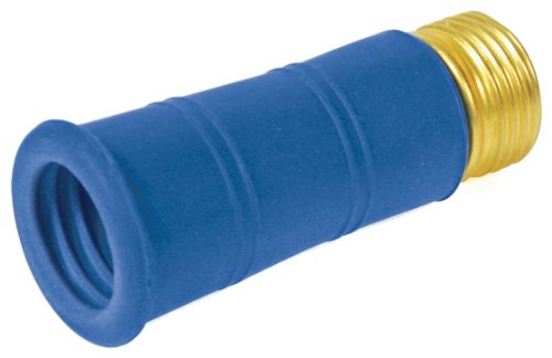

You'll want to make a yourself a sink kit which includes a small pair of rust resistant channel locks, o-rings, small o-ring pick, thread adapters, and one of these with a couple of hose clamps.
http://www.amazon.com/Camco-22484-Water-Bandit/dp/B000EDOSKG
