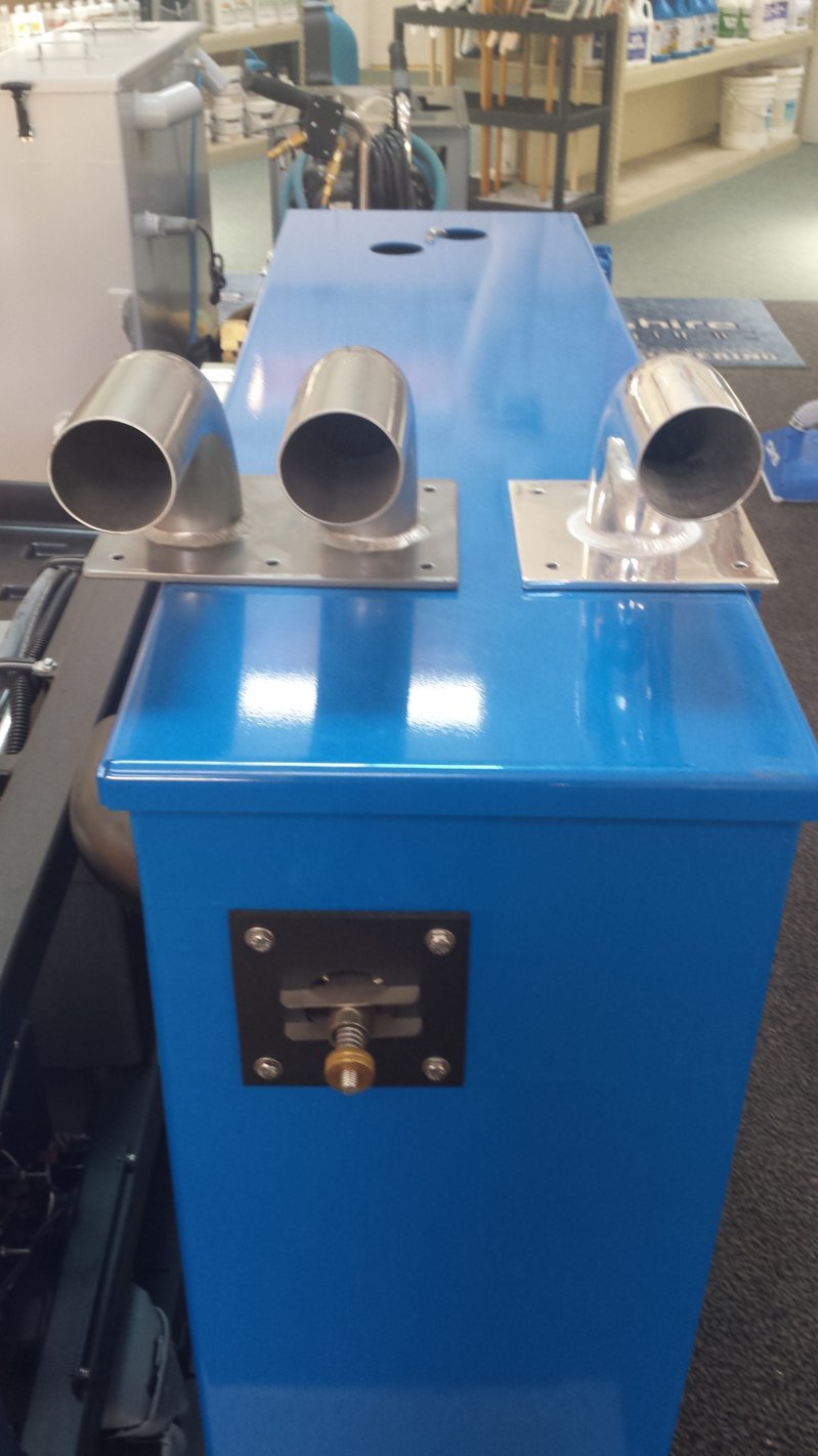

I'm still looking for that 2.5" waste tank elbow. I think it was a PMF part but could be wrong. Anyone?

Not looking to weld. There's a part that PMF (I think) makes. It looked like a 2.5 inch metal piece with a gentle bend in it. I think I'd like the bend, to help keep hoses off my machine.

We have Greenie 2.5 elbows.
$149.00 for the double and $119.00 for the single

Typically the Greenie elbows are installed on the recovery tank lid. A 2.5" hole is cut and 4 small bolt holes are drilled through the lid to secure the elbow and gasket. I'm not familiar with Cleanco tanks but it may be possible to install the elbow on the side or end. Turn the elbow to suit your specific arrangement.
Well, there you go. Ray has some in stock, and not a bad price!
CMS in Northern Cali. And those look like smooth flow elbows, which is what you want if you are using an elbow.
