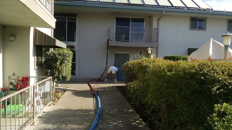

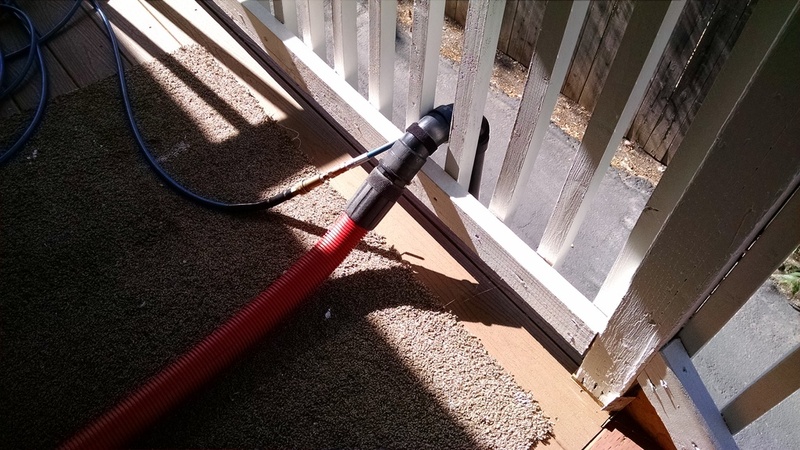

Here is a picture today of how it works,
I grab the setup and place it first, then I just run my hoses over to it. Once it is in place all I needed was 5o feet of each and my HF and wand. I rolled them up and carried all of it up in one trip.
Once up top I hook to the solution line and open the ball valve ps the apartment out then hook up the vac hose and I am ready to clean.
Saves a lot of time as the door to the left is the staircase so it keeps you from making multiple trips back and forth to the van, and this is one of those where is is a long trip back and forth.
That was the painter he was working on the metal fence getting it ready for paint, he was happy because it was still out of his way enough that he was able to keep working
