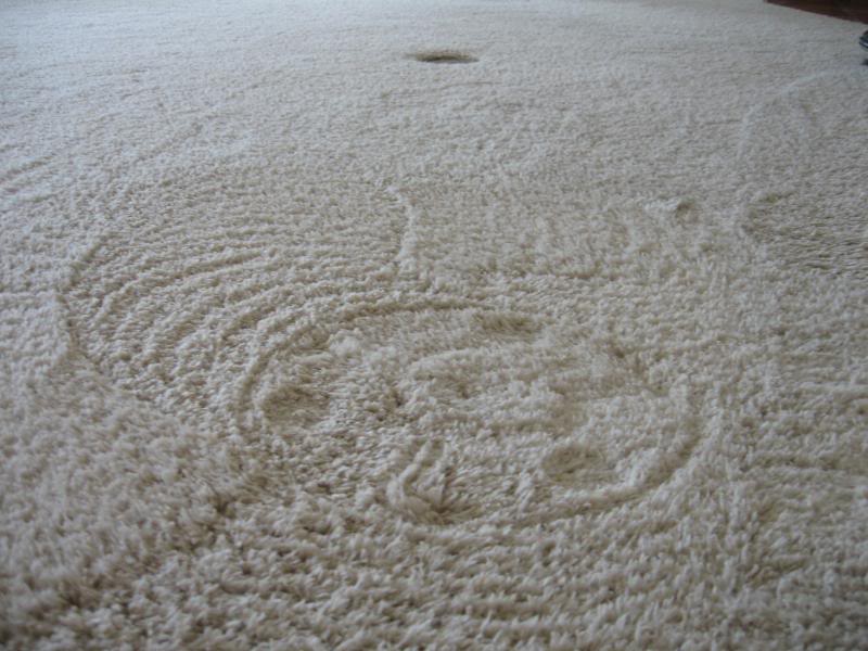

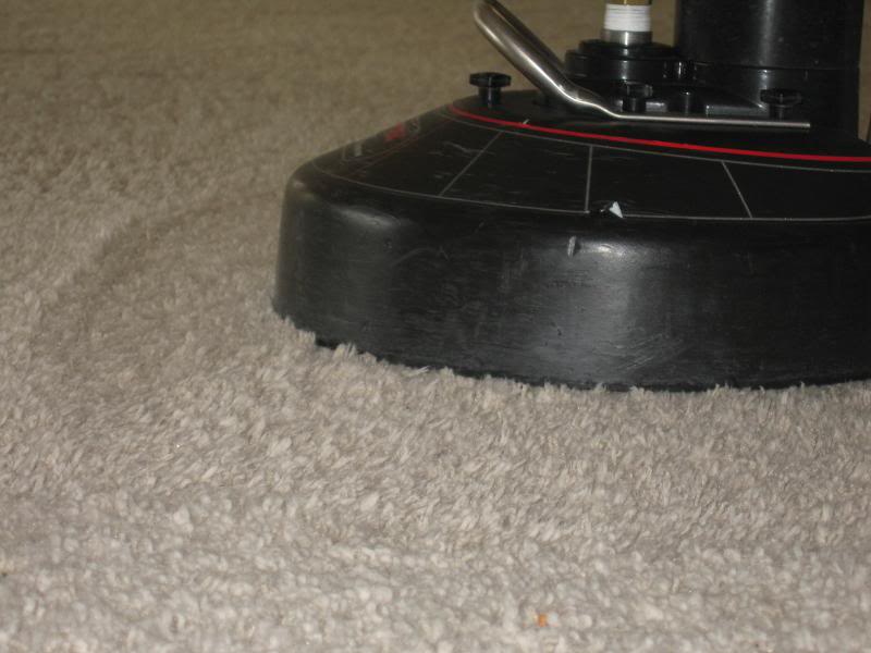

The only time I ever seen any streaking was on the thicker pile carpets...and I am sure it is because of the small head and not having enough stability to hold itself up....on berber and CGD...it did a great job.....but it could stay above the carpet........
CGD....machine sets above the carpet and jets are free to spray..........
thicker pile carpet.....jets are hitting fibers ...water can not spray like they should to flush out fibers....
this is how far it pulled itself down into the carpet when hooked to my machine...if you look close you can see the tubes that feed the jets...
there is no way that water is spraying out like it needs to...........
the head on the XL is much wide base and more stability.........everyone tell me that there is no streaking with this one and that it does a much better job......

Thank's Jim, but that's a picture of indentations left from the swoop head after it's done turning. That gets vacced or brushed out. I've cleaned that same carpeting and the water sprays out, the fibers are displaced by the metal swoops (that do the actual cleaning) the carpet is rinsed by the jets and extracted dry. I still don't see the streaking.

pretty obvious Art..........look at the marks next to it and it is dug in..........
Its not like I am the only one who has ever owned one of these that have seen the same problem.......
others have seen the exact same thing and have mentioned it before............

Those are swirls, from what I can tell from the pictures Jim. Admittedly they are more difficult to remove on a thick pile, but it's not streaking which requires some sort of recleaning or other touch up work.

I wasn't showing streaking...I was showing why I think it streaked....because the jets are being blocked......
