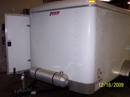

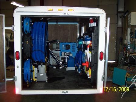

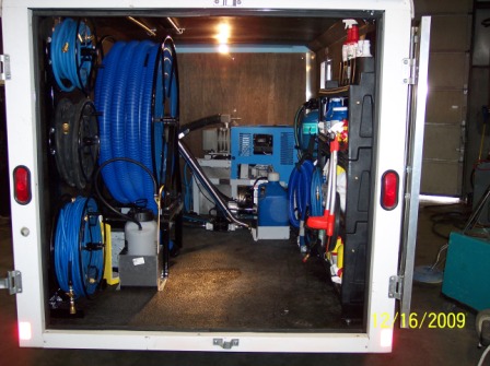

Hey Roy or Tim or whoever. WTF are you talking about? guarantee my trailer is properly balanced. I have some nice heavy shelves, air movers, 2 floor machines, and all my chems up front. A tank just like John's on the tongue along with 2 propane tanks. It's balanced right on. Never a sway in 5 years. Go to TMTrecovery.com. There are pics of trailers just like mine on there.

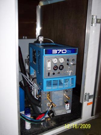

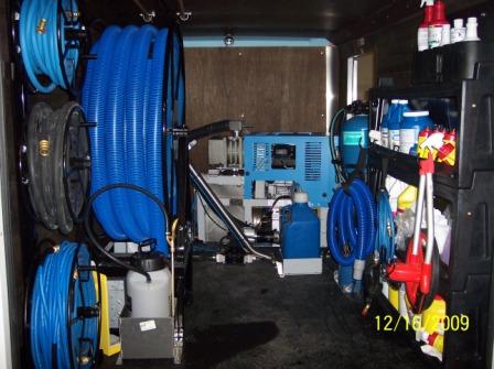

John do you still have this trailer? This is how I want my trailer set up and Interlink in Phoenix says that the Saphire has to be mounted in the back. How has it towed has it worked out well?
Besides all the space that setting it up in the back wastes, I would much rather the exhaust blows out the side door.
John Olson
6,281
John Olson

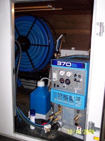

We sold that machine a long time ago but we run every machine out the side always have. Why would they say it has to go out the back? You buying a trailer with no side door? Maybe hey don't know how I get it to the front? Buy the machine if that is what you want(we don't sell sapphire) have them put the crate in the trailer and drive up to us and we will do the rest.
K
kingjoelking
They were saying weight distribution. But im getting a 6x10 single axle just like you showed. So I am not sure why it would be a problem.
John Olson
6,281
John Olson

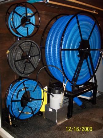

What truck are you using to pull it? The tongue weight might be what they are worried about but we put 650's out the side door. The 370 is so small there shouldn't be any issue at all your hoses and hose reel will weight 500lbs if you have 300' of each so it will bbalance out the trailer especially when you load the back end with stuff. There is no reason you can't install a 370 out the side unless there is something odd with your trailer and truck
load it anyway want...but the general rule of thumb is, 10% of gross weight should be on the tongue
meaning, if trailer and load weighs 3500 pounds, there should be 350 pounds on the ball/hitch .
you have more, but you don't want it lighter .
Not enough tongue wt will cause the trailer to sway at hi-way speeds
S
steve g

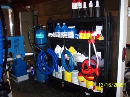

I can not agree more with john saying run the machine out the side door!!! The problem with running it out the back is you essentially waste all the room on either sides of the machine in an out the back install. This just wastes room. on my machine I moved the chemical buckets and even the demand pump to the very front of the trailer, then I mounted the machine right next to them, so the machine is about 1 foot behind the front wall. all the room and space to the back or left of the machine if your facing the side door is available for pretty much anything. This alot better use of space. further if you contact the trailer company that sells the trailers or read the owners manual they will tell you that the trailer must be loaded with more weight to the front. this makes the trailer pull more stable. my machine isn't that heavy but it does have a 60 gallon sub mount tank which when full means about 1200 pounds a full waste tank would mean another 500, I do use a ford f 250 to tow though.
