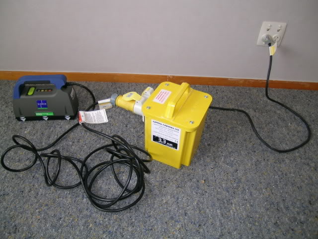

Got mine today and rearing to go! When I picked it up it had this big heavy transformer with it, so I said to the guy "mate - I asked for the smaller transformer" and he said THIS IS THE SMALL ONE :shock:

Yellow or black Heath?
Large UK sylte plug or smaller US style plug?
This is our first unit, it came with the UK transformer with two outlets.

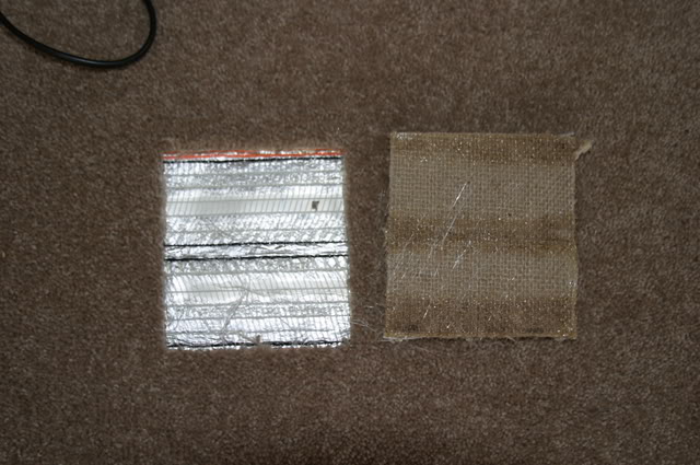

Here's a picture of what I was trying top describe earier.
One of the beauties of the KG is the ability to remove a patch if things don't go right. In this case, I'd trimmed it slightly too much and when it inserted, it looked a bit gappy.
2 zaps with the KG and out she comes. New one cut and straight back in. Less than 3 minutes to redo the same patch.
Anyway I digress, look at the pattern of melted glue on the backing of the insert. Notice the two strips of un melted adhesive.
This is why it's important to combine the two styles, glue gun the edges first to seam seal adn bond the bits that won't get zapped by the iron, follow up with the iron to weld the whole thing in.

Did you put a new section of tape down on the second try, or use the same tape?
Mort
J
Jack May
I left the tape in place but added my adhesive from a Kool Stick.
John
J
Jack May
To compensate for the adhesive removed with the dodgy repair coming out.
I just felt I needed to 'top up' the adhesive in those three strips for the new piece.

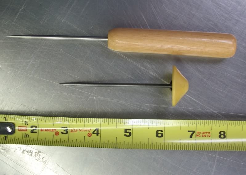

Never mind ice picks (you can get them at N-C or a restaurant supply house) I'm looking for "China hat" plastic topped picks. They're way better than a regular ice pick for carpet repair, but I can't find a supplier. Anyone familiar with them?

Shorty,
The one in the center, China hat!
I like the one you show though, it looks pounding enabled. What's it called?
